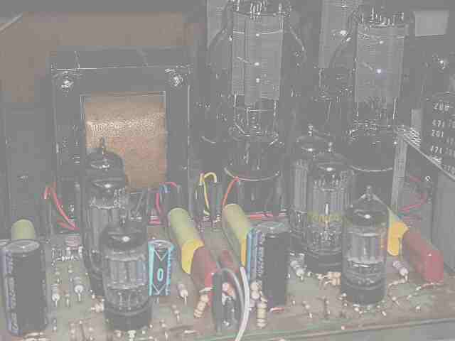

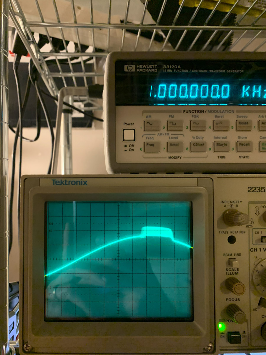

I'm not sure if you remember but I had that issue with oscillation in UL with the cap above ~300-400pF.
I was incrementally increasing the value so that the 10khz square wave looked nicer.
I think I ultimately landed on 270pF and about 2nF across the screen in the primary wiring (which took care of the instability)
I don't have that amp anymore but enjoyed the SPP enough to build another with Hashimoto transformers... really curious to see if it behaves nicer than the Hammond

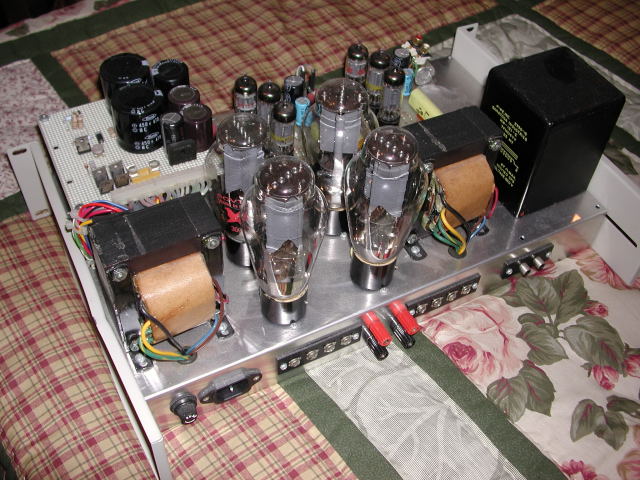

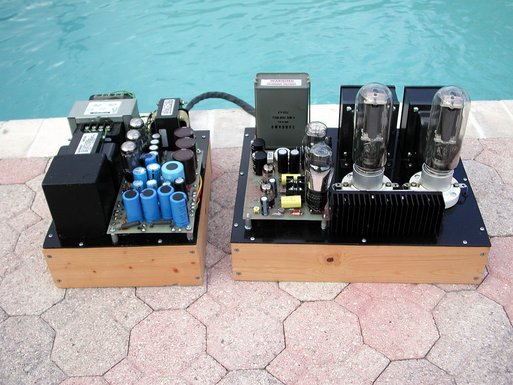

Note that this was one of the first tube HiFi amps that I ever built. It was made at a time when I got the 300B's for $25 each! It was an experiment to explore a few ideas. It is a push pull 300B amp with no feedback at all. It was built from 100% "junkbox" parts. Photo flash caps in the power supply, $16 OPT's, 10 for a penny resistors.....It defied logic, and upgrades. For some unknown reason the amp sounded great. For another unknown reason, any attempt to upgrade it, say swap out the cheap OPT's for some vintage UTC's or modern Hammonds (Edcor did not sell to end users then) resulted in worse sound. Ditto fancy parts.
This was my favorite amp for about 5 years until it blew a fuse one day during a thunderstorm. Not having a proper fuse resulted in my doing something stupid, which resulted in electrolytic goo all over the place.
This amp was one of the few old amps that I kept when I had to relocate everything 1200 miles. It is still dead, but mostly intact. I stole its power supply choke for the 845 SE amp that replaced it in my listening room over 20 years ago, also a junkbox build.
I had planned to rebuild it one day, and maybe I will......someday.

Thanks itsikhefez,
Was the 2nF from the screen grids to ground?

Thanks itsikhefez,
Looking at this picture, it looks like it was across one primary and screen.
It also seems to be a silver mica there so I may have ultimately used a value smaller than 2nF...
This was to solve some instability when approach max. output power.
trobbins tried to diagnose the problem, and said: "It may well be that the cap reduces the gain sufficiently at higher frequencies such that the stability margins improve once feedback is connected."

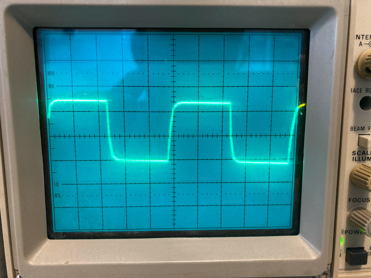

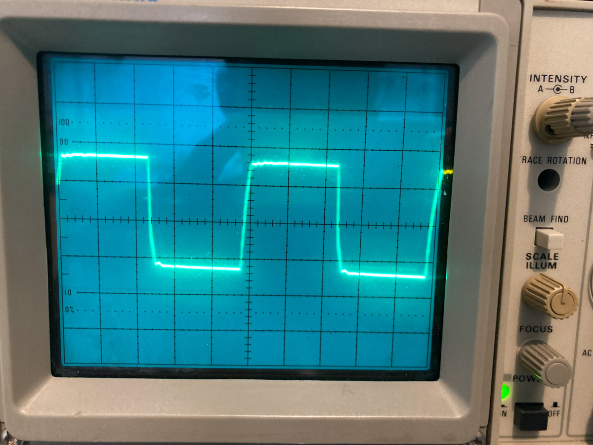

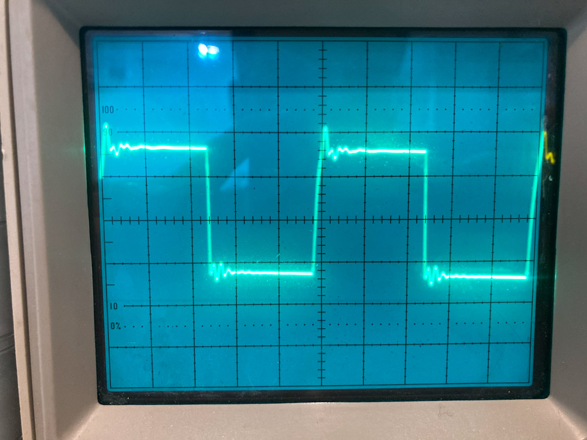

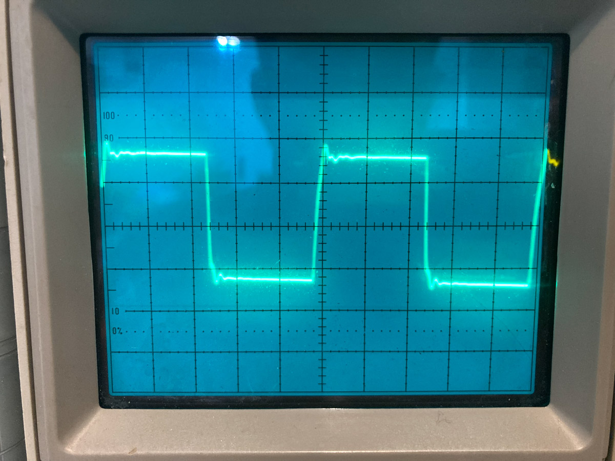

Regarding the in-progress build, I'm trying to determine the ideal feedback capacitor.
I took the feedback from the 16ohm tap and measuring a 10kHz square wave to the 8ohm taps (8ohm resistor used as load)
Attaching pictures of no cap, 120pF and 270pF.
270pF seems good but is it too rounded and better to use something slightly lower?
Unlike the Hammond 1650 from my previous SPP, no signs of oscillation or instability with the Hashimoto's.

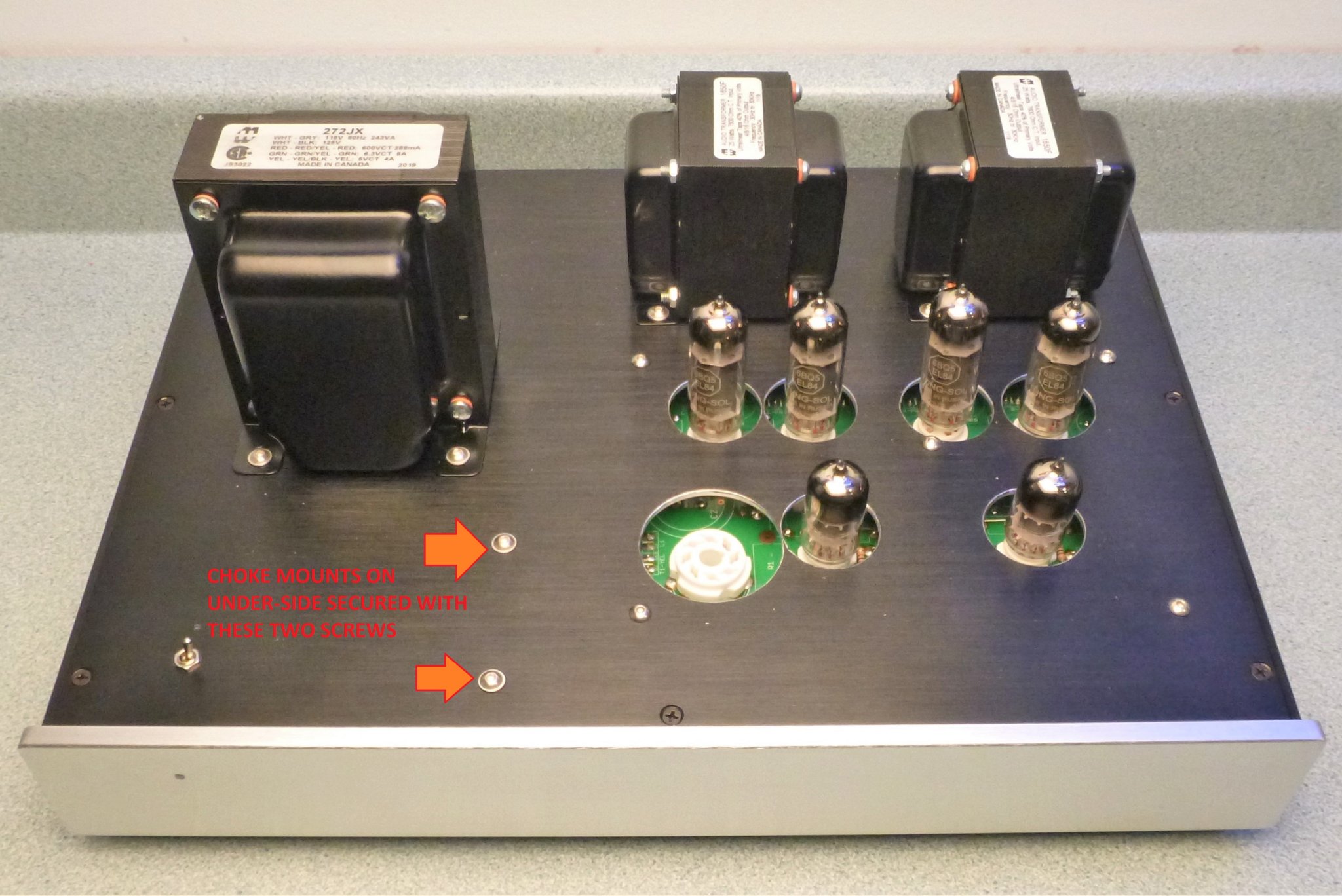

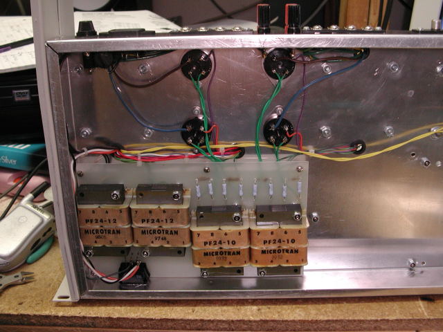

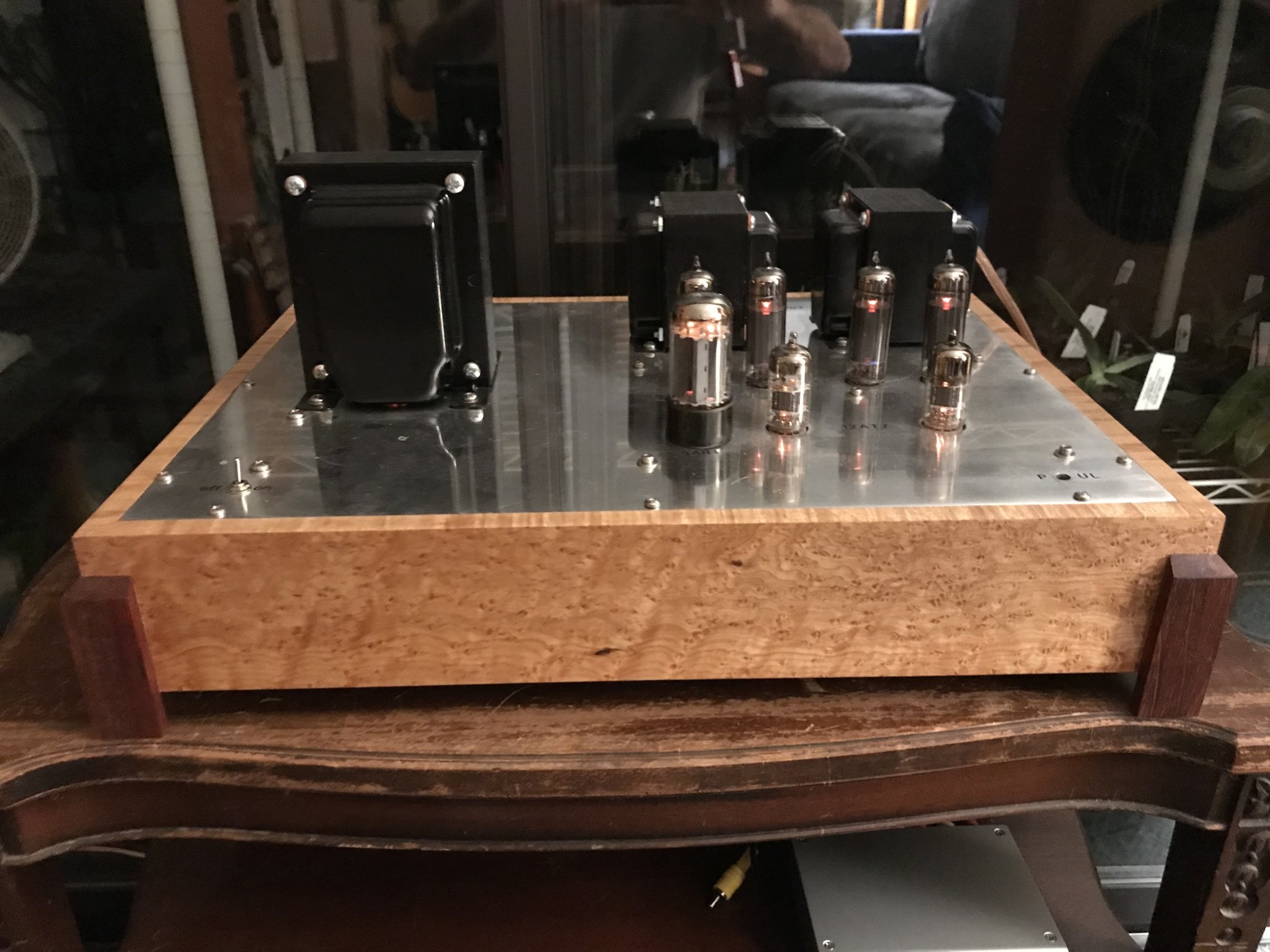

I built one in an 11" x 17" chassis. You can probably go smaller. It's best to keep the OPTs to one side and close to the back, the power trans towards the opposite side. Keep the lamination stacks of the power trans at right angles to the stacks in the OPTs to minimize interference. The use of a Hammond 156R choke in the PS reduced hum in virtually zero. The chokes laminations were arranged to be at right angles to the power trans laminations. See attacked pic.
S.
