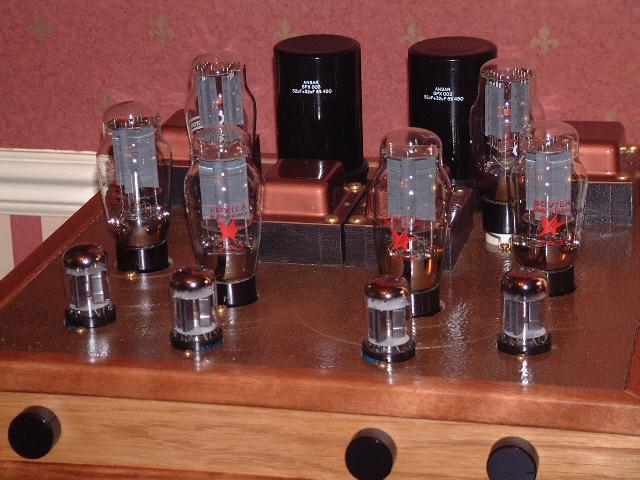

Talking about Allen (since so many of you know him) he liked my best [audio] friend:
BLACK BEAST MK-IV
http://members.ozemail.com.au/~lisaras/DIY/BB-IV-55-2.jpg
Joe R.

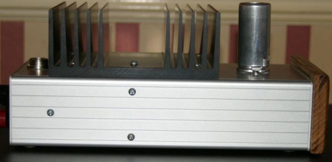

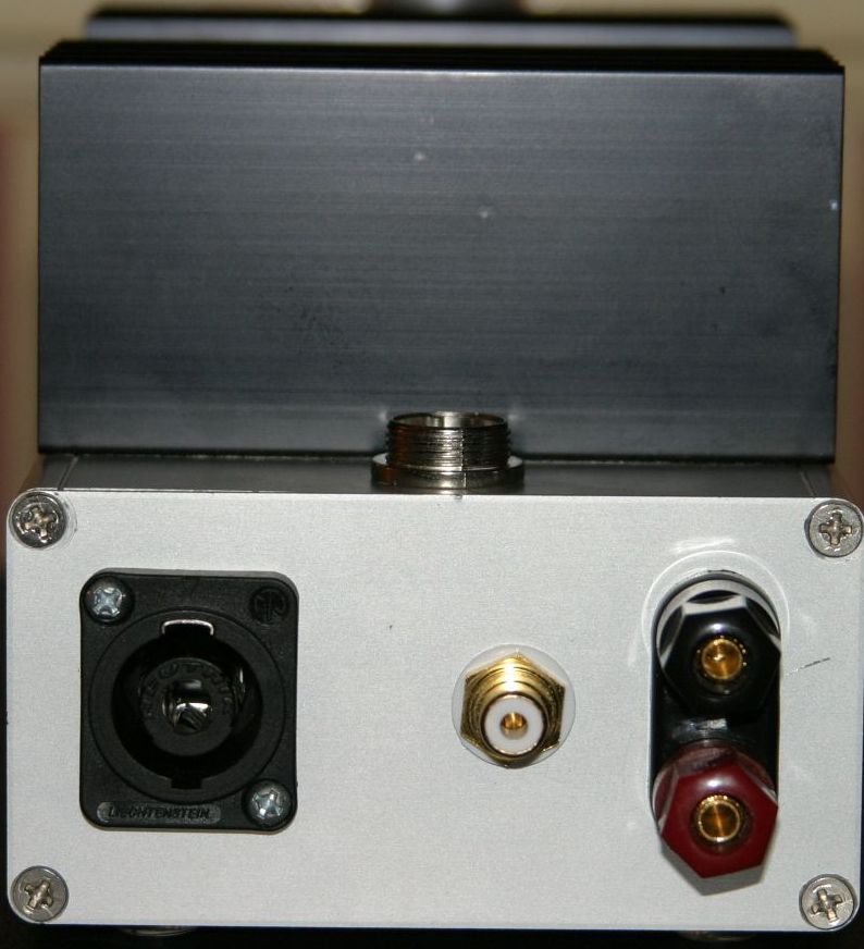

I have those on order from Langrex Supplies,i was worried the edicrons would be microphonic hence the alloy can..I got hold of 6 of these el cheap all were pretty decent.(Yes Nick i did try yours before sending).🙂)
A BIG THANKYOU To Joe :--))))) They sound wonderful..

Hi Peter,
Good on you... nothing to do with Edicron as such but the NOS tubes are heaven compared to the China ones.
The screening can isn't a bad idea, it will...well screen the valve at the expense of only a neglegible amount of input capacitance and it will help reduce microphony too.

Hey Joe, where can we find out more about that BLACK BEAST MK-IV! Looks interesting. I presume that the top section is an open baffle arrangement.

Nuuk said:Hey Joe, where can we find out more about that BLACK BEAST MK-IV! Looks interesting. I presume that the top section is an open baffle arrangement.![]()
Unless you can unlock my head... 😉
No, actually no great secrets here, I would be glad to tell, but I wouldn't know where to start.. and this is not the right forum.
But, yes it is an open baffle, something I've been doing and experimenting with for 15+ years. I am a big fan of open baffle, and the best way to do it is as an MTM array. The sloped rear right angle piece is also crucial.
