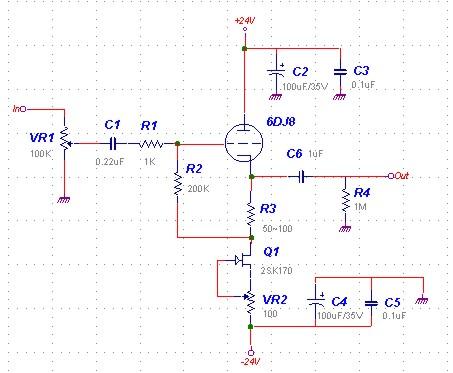

Thanks Joe for the hybrid idea. I am just wondering -- maybe Joe or others with more experiences can help -- if the hybrid gainclone can be operated using +/- 24V rails. I think the op-amp can do it, how about the 6922 tube? Will there be any modification to the circuits?
agent.5 said:Thanks Joe for the hybrid idea. I am just wondering -- maybe Joe or others with more experiences can help -- if the hybrid gainclone can be operated using +/- 24V rails. I think the op-amp can do it, how about the 6922 tube? Will there be any modification to the circuits?
look here:
http://www.diyzone.net/diy/references/tube/6dj8buffer_2.htm
http://www.diyzone.net/diy/references/tube/6dj8_lm1875_david.html
(author David Lin, july 02')
Regards
Thanks. I guess +/- 24V may work after all. Has anyone try this circuit. It looks like it is doing a bit of JFET stuff with that 2SK170.
Yes, the circuit will work without changes. I may be inclined to reduce the 10K value to negaive 24V to 7K5 or 8K2. This will keep the current up and it drops with lower voltages.
Some 6922 may not be as happy with +/-24V as others. So try more than one might be a good idea. I have never run them that low so I don't speak from experience, only what others have said.
Go ahead and construct it, I am confident you will like it.

Hi Joe & others,
Firstly, I've built two Gainclones. Neither are inverted and I don't own either of them! One belongs to my Sister and the other is my Brother's. Ever since I heard the first one, I fell in love with them. They may not be the best amp I've ever heard / built - but certainly have the highest QPP rating (Quality Per Pound 😉 ). I'm hoping that your superb work will change that and make them the best I've heard...
Here are my questions...I like to play my music loud (when my fiance goes out of course!
) I don't feel that the gainclones go loud enough for my liking. I was thinking about bridging two LM3875TF s. I have 10 of them and would like to use them rather than buying 3886s. I see that in the schematic you have one tube shared between both channels. I am wanting to build monoblocks. Can I just use half the tube successfully or is there a way to use both sides? Maybe use the buffer after the invertor and then I can use both sides of the tube for each chip.

Rarkov said:Can I just use half the tube successfully or is there a way to use both sides?
Sure. If you wire the 2nd monoblock so that it uses the other half of the tube then switching tubes from one monobloc to the other will be like putting fresh tubes in.

Nah...
What you can do too with a CF as this is wire both halves in parallel for even better current drive and lower Zo.
This requires well match triode halves as current hogging will occur otherwise but that's another chapter.
Personally I'd stick to Dave's idea though, it's elegant enough and easy to swap around the tubes every year or so.

valve phase splitter
For simplest balanced operation you could try looking around for a valve phase splitter cct.
Instead of going balanced PP why not put both chips in PSE?
Either leave one half of the 6DJ8 unused or put both triode sections in // as well for greater current drive.
