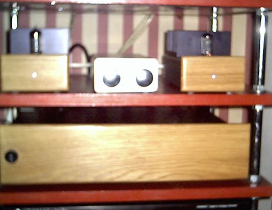

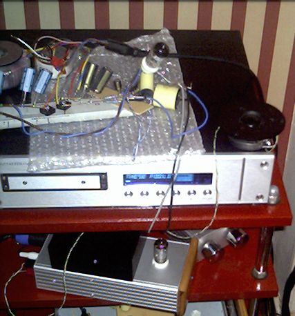

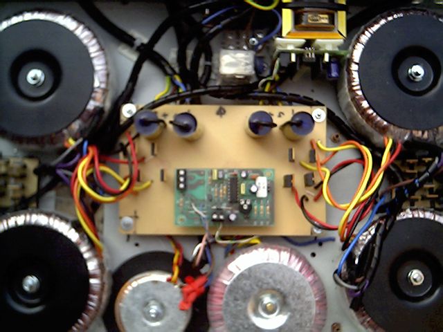

I built monobloc GC's 2 weeks a go using Thorsten's ultimate power supply..These have 4 250VA Tx (2 per channel ) secondries are 40 volts but primaries are in series thus giving a secondry 0f 20Volts.
I thought they were pretty much finished the sound these produce is outstanding driving B&W CDM 1NT's..
Well I couldn't sit back without trying Joe's buffer stage..Phew what a great upgrade,It's hard to believe any improvement could be had,but hell the sound is just outstanding..
I have used single Tx for the HT and filament supplies but are split with their own brigdes/filters..
B+ = 39V
DC Offset 3.1mV
Ripple 1.2mV AC
Valve current =3.9mA
Here are some crap pictures of work in progress( should have some HiRez by the weekend of internals ..
Regards
Peter

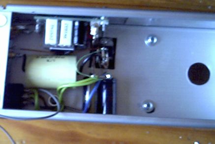

I didn't mention the need for pre heating the valve,either the valve stage needs constant power or a seperate switch..In my case I have a timer relay that can delay from 1 sec to 2minutes..
when i get this far I test the best time without any noises.

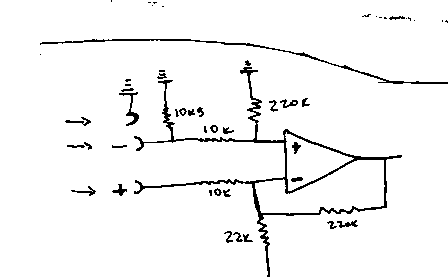

It's exactly because I think that a buffered GC is much better than a non-buffered one that I said it wouldn't be be a "fair" comparison . I have used a Pass BOSOZ pre which is essentially a fet buffer as well as a DRV134 balanced line driver stage which is essentially a chip buffer and I think the results are much better sonically than the minimal GC.I have not tried LPF as applied by Joe but I am thinking of doing so if somebody can help calculate the values for a balanced input.The question thus is whether a tube buffer is better than a fet or chip buffer.
protos said:...but I am thinking of doing so if somebody can help calculate the values for a balanced input.The question thus is whether a tube buffer is better than a fet or chip buffer.
OK, give the values of the input 'feedback resistor' that feeds the inverted (-) input and I will give you the LPF values. This resistor affects the time constant, which should be 30-31uS (not the earlier value I miscalculated). If you are using 10K here, may I suggest that you up the main feedback resistor to 300K or 330K. Get back to me.

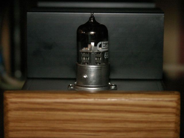

Hi
Another not so good picture :-(
I have not heard a FET buffered GC but hell Joe's valve offering is a major improvement to what was a good sounding amp..
Having chated with Nick (NUUK) for almost 2 hours last evening it does appear a buffer is a major improvement over a standard GC.Nick as taken the challenge to go valve buffer (even better when 90% of the parts are on offer)..But that's what i find great about DIY you can share..

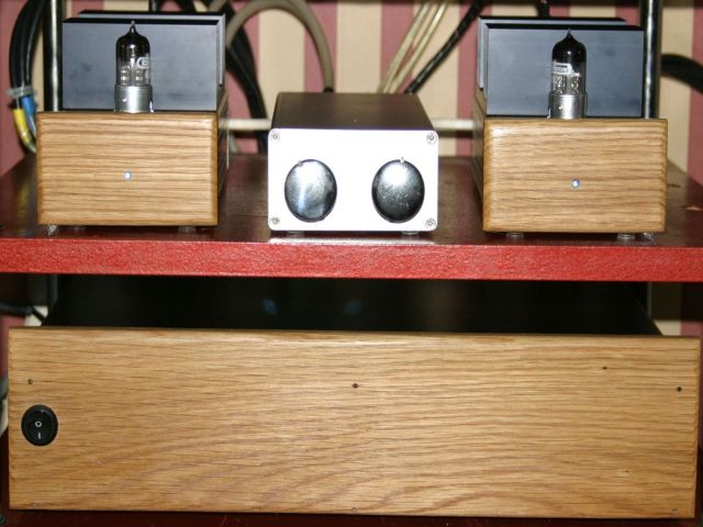

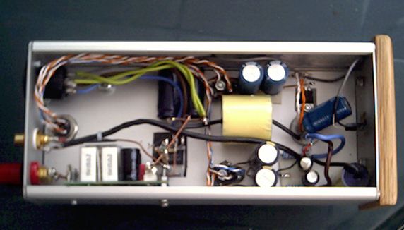

Hi
Here are some better photo's.
Hey nick hurry up with the wooden knobs,I can then finish the controller. 🙂))
