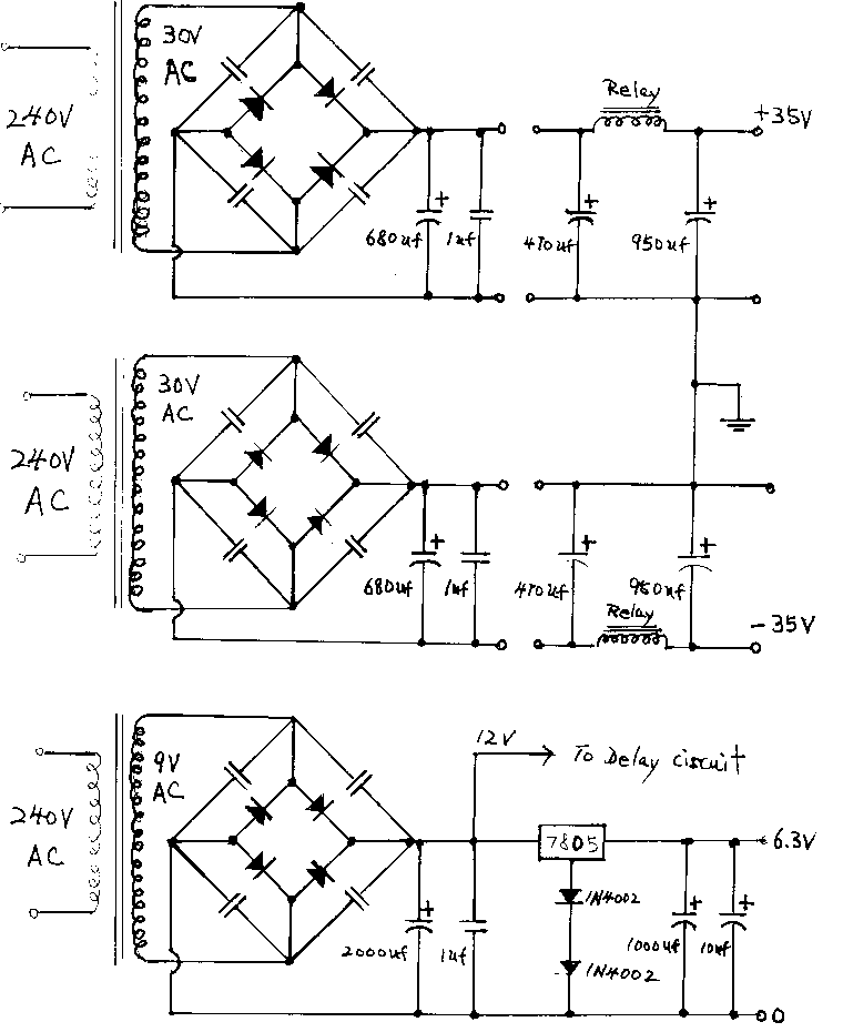

I forgot to share with moamps on the sound part.
Most of my parts used in the amps are savaged from the local scrap yard. The system which I have is on the lower end. I played them on a Toshiba DVD/CD player with my 25 years old German made acoustic suspension speakers. With this setup, the sound is superb, and vocal is silky smooth and not at all jarring even when the volume is quite high. The songs which I used in trying out the sound are Norah Jone's "Come Away With Me", Eva Cassidy's "What a wonderful world" and Jim Tomlinson's album "So Nice".
Regards
Tony
