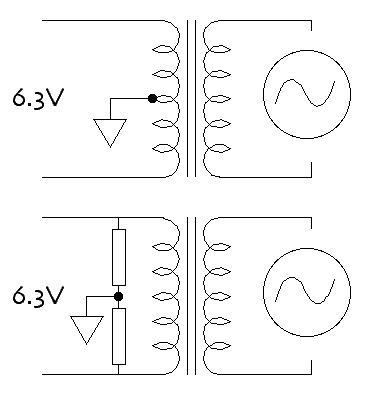

A trick that often helps reduce filament induced hum, is to wire the trafo as shown.
That trick works best for AC fed heaters, especially for DHTs where a balancing pot, AKA rheostat is often desireable for humbucking.
It can be applied to the powerxformer or at the heater pins, whatever is more convenient.
It mimmicks a CT xformer.
With DC on the heaters, as should be the case here, it's not effective but it won't hurt either.

Re AC Heaters:
I don't usually use AC on heaters where there is a lot of gain at that point or subsequently further up the chain. Whenever I do use AC, then Dave's solution is the same that I've always applied.
But of the two techniques Dave has shown, I prefer paired 1% resistors (Dave's 2nd diagram) as they are likely more accurate, than tx centre-taps. The idea here is to cancel or 'nul' the AC - I mention this for those not familiar with AC heaters. Besides, sometimes you may a 6.3V AC Transformer without centre-tap. In that case, no worries.

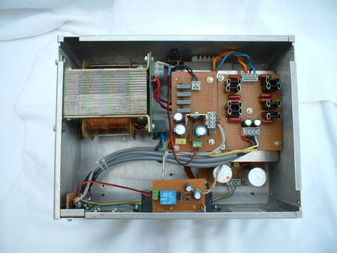

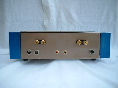

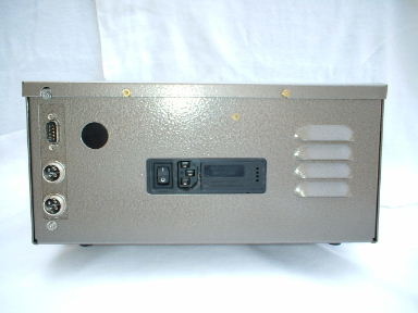

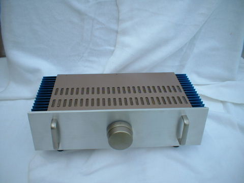

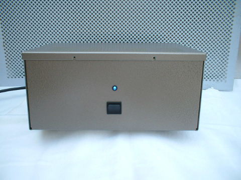

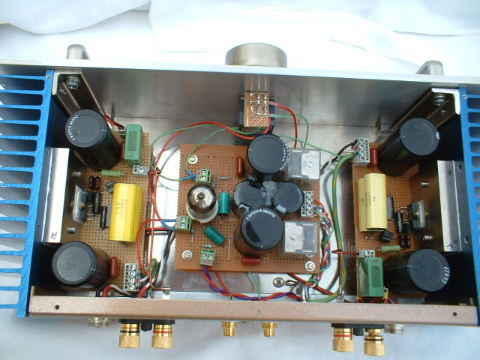

Hi everybody, thanks for all your compliments, I am still trying to improve my work.
Nuuk, as for your query on the connection to psu, I have attached pictures and the circuit diagram. As for tube power supply, I am using a relay as a choke. This idea came from Mr Kristijan Kljucaric of PCB Design site.
Regards
Tony
