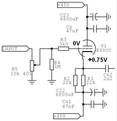

First, make sure that grid DC voltage to ground is 0V when your source is connected to input (this is very important).
Second, measure DC voltage chatode-ground. This voltage must be higher than 0V.
Take a look at my readings in the picture below.
Regards
Regards

Did you mean measure DC voltage cathode-grid(not cathode to ground) to be higher than 0V, to make sure grid is negative compared to cathode?
Thanks for help.
Tor Martin
Tor M said:Did you mean measure DC voltage cathode-grid(not cathode to ground) to be higher than 0V, to make sure grid is negative compared to cathode?
Yes, grid must be negative compared to chatode.
If here is grid at ground, then chatode-grid voltage mean same like chatode-ground voltage.
