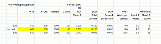

6080 have Cathode to heater voltage equal 100v in datasheet and Va 250v.
Can I use it in regulator with 500v input and 400v output?
As long as the floating heater supplies for the 6080's is tied to the output its no issue. The winding on the transformer will need sufficient insulation through
The differential voltage the 6080 sees is also in spec.
However 100V headroom can be too low in low mains voltage conditions and full load operation. Depending on supply impedance and mains variations your supply could fall out of regulation if the mains voltage fluctuates too much.
You will need a second heater supply for the error amplifier. Because its cathode will be closer to ground.
You are right at the limit of the 6080's Heater to Cathode voltage.
If you have the room for another transformer, I would heat the 6080 and it's error amplifier valve(s) on a new transformer biased up to 150V or so.
Also, as v4lve lover pointed out, you are at the very low end of the 6080's plate to cathode voltage. 150V would be much better.
I'm in the process of building one of these right now...
You might find the 2 attachments helpfull
