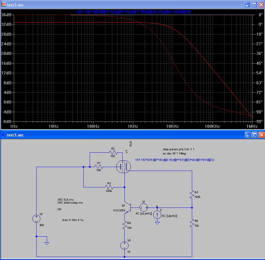

Here is a quick regulator (loop gain) sim to demonstrate what I'm going on about.
I've used a 6L6 connected as a triode (low gm) for the series pass element and just a NPN transistor for the error amplifer. The loop gain is just a little under 33dB
The first screen shot shows the loop gain and phase with no output capacitor. The open loop bandwidth is defined by the error amplifier, which begins rolling off pretty early (5-6kHz) with the large 200k load resistor.

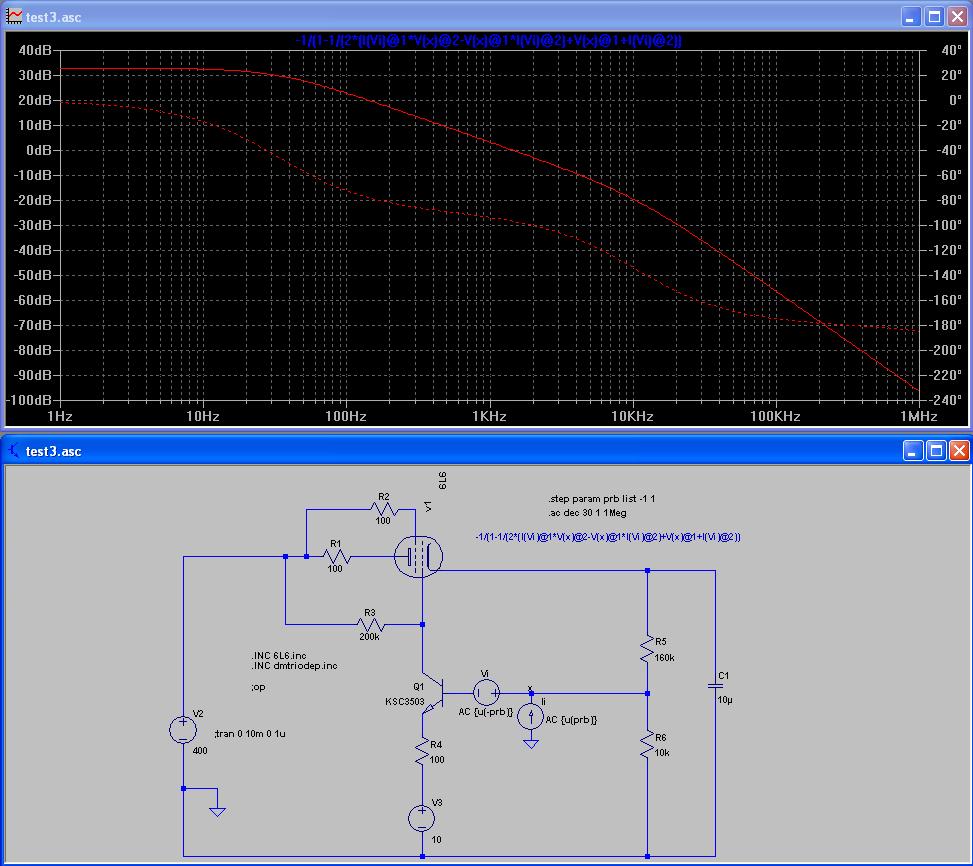

The second screen shot shows what happens when a 10uF capacitor is added to the output.
The open loop bandwidth now starts to roll off very early (about 35Hz) due to the pole formed by the 10uF capacitor along with the high output impedance of the triode series pass element. This is now the dominat pole, the loop gain now going through unity at approximately 1.6kHz with a phase marging of ~80 degrees.
Note than in the first case (without the capacitor) the regulator is stable, but this is only because the current-starved error amplifier has a rather low bandwidth.

I just used an idea cap because at these frequencies and loop gain the ESR/ESL makes absolutely no difference.
The tube series pass element has a 'resistance' of about 450 ohms. Suppose the cap is an unrealistically crappy one with an ESR of 0.5 ohms.
450/0.5 = 900 = 59dB attenuation.
That's still greater than the loop gain of 33dB by a more than adequate margin.

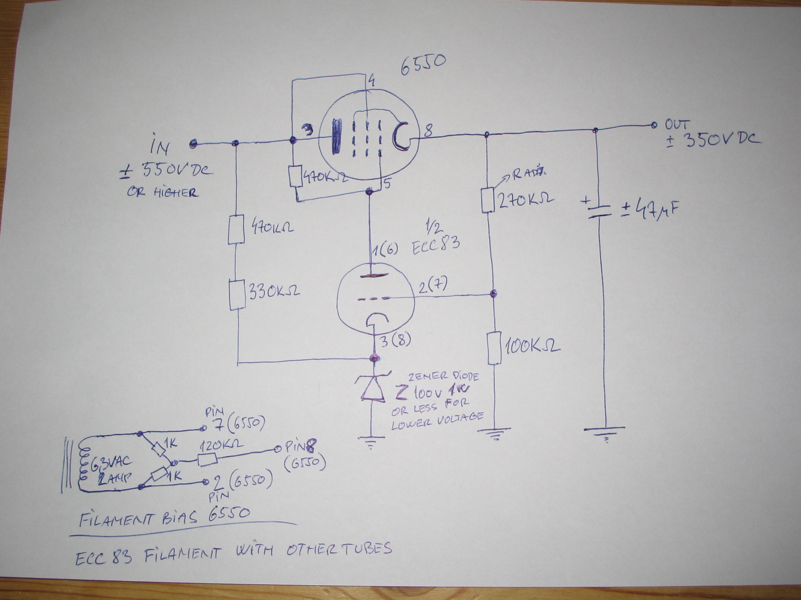

Hi Max, could you post your KT-88 (6550) schematic? I want to regulate my b+ for my 300B monos. I tried several MOSFET regs, they sound thick, mushy, complete loss of 3D stage and transistor like nervous highs. Bass is also detached from the rest of the music. Great loss of textures in the mids. If you put even 1 transistor in your rig then it will sound like ****. BTW, EL84 sound better as series reg than EL34 (I hate the sound of this tube).
Hi HornTube,
Uh ah, that was some 10-15 years ago... I searched for drawing but could not find it so I draw new one. I'm not sure if it is 100% same as I used for my amp but it is close enough for rough start, please experiment on breadboard before actually fitting in your amp. Make sure you use separate filament transformer for each regulator tube!
Instead of 6550 ( KT88 ) I also used 6L6 ( for pre-amp and/or screen regulation ) and parallel connected 6AS7G ( 6080 ) for another 300B amp with great success, please be aware of a very high voltage input needed for regulator to even work ( approx. ± 550-600 volt DC ) and place a fuse before regulator just in case something goes wrong!
