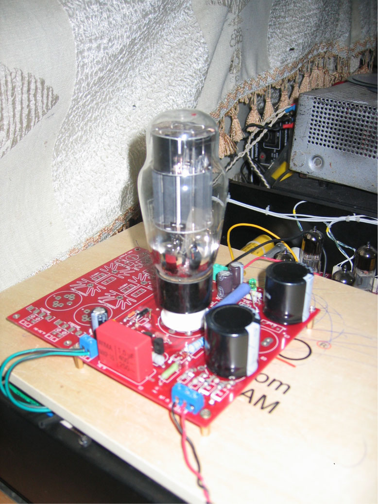

I have been concerned about “starving” the pentode with <1mA plate current.
The typical data for the 6sj7 is 3mA @ plate, G2 100V @ .85mA.
I will test this tonight… I have some 10M45’s to use for a ccs.
One question: If I use a ccs on the pentode plate, How do I adjust the B+ voltage ?
I would suspect the ccs to hold the pentode plate at the same voltage regardless of how I adjust the G1 voltage?
Oh, this is a feedback loop, so the plate voltage of the error amplifier is self-regulating. Assuming B+ (?) is the output voltage, the requlator will always maintain the plate voltage of the pentode at B+ minus the gate-to-cathode voltage of the series pass tube.
Don't forget to probe for HF oscillation.
Quite right, one other thing I will mention is make sure that the open loop bandwidth of the error amplifier with the CCS is at least 20kHz which probably means adding some resistance to define the load impedance. In theory it should make no difference to the sound, but in a number of listening tests "victims" preferred the higher bandwidth, The required resistance can go right across the CCS and could probably be several hundred K ohms, This may sound counter-intuitive but the CCS will give you the required Ip for higher transconductance resulting in higher gain than the current that the load resistor would flow on its own.
GK, Kevin,
I just finished testing the V-Reg with the CCS
The results are amazing; you can hear the difference, no question about it.
The sound is sharper and more detailed than ever, and I'm setup in the basement on the cheap speaker!
Here are some of the details, I'll upload the schematic tomorrow.
3mA CCS for the plate of the pentode
(so now the pentode is operating at the “typical” value)
20mA CCS for the 0A3
With some on my earlier experiments, the 0A3 would flicker at 20Hz.
The 20mA CCS took care of that!
This setup allows the B+ to range from 258V to 360V
And the Z-out…….. .15R at 20Hz
Thank You

Actually, it's sub-100 milliohms Zout and sub-300 uV hum/noise
http://www.linearaudio.nl/t-reg-1.htm
