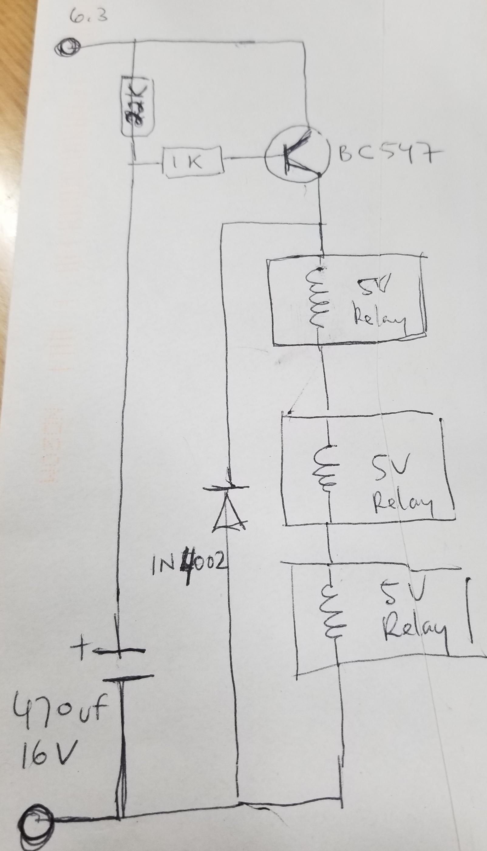

Thanks for for explanation. So i would need one muting relay circuit per channel since I have the xlr outputs?
If i wanted to also mute the rca outs i could use one more muting relay circuit to do both channels? So possibly 3 muting relay circuits total?
What function does the BC547 transistor have in the circuit? post #54

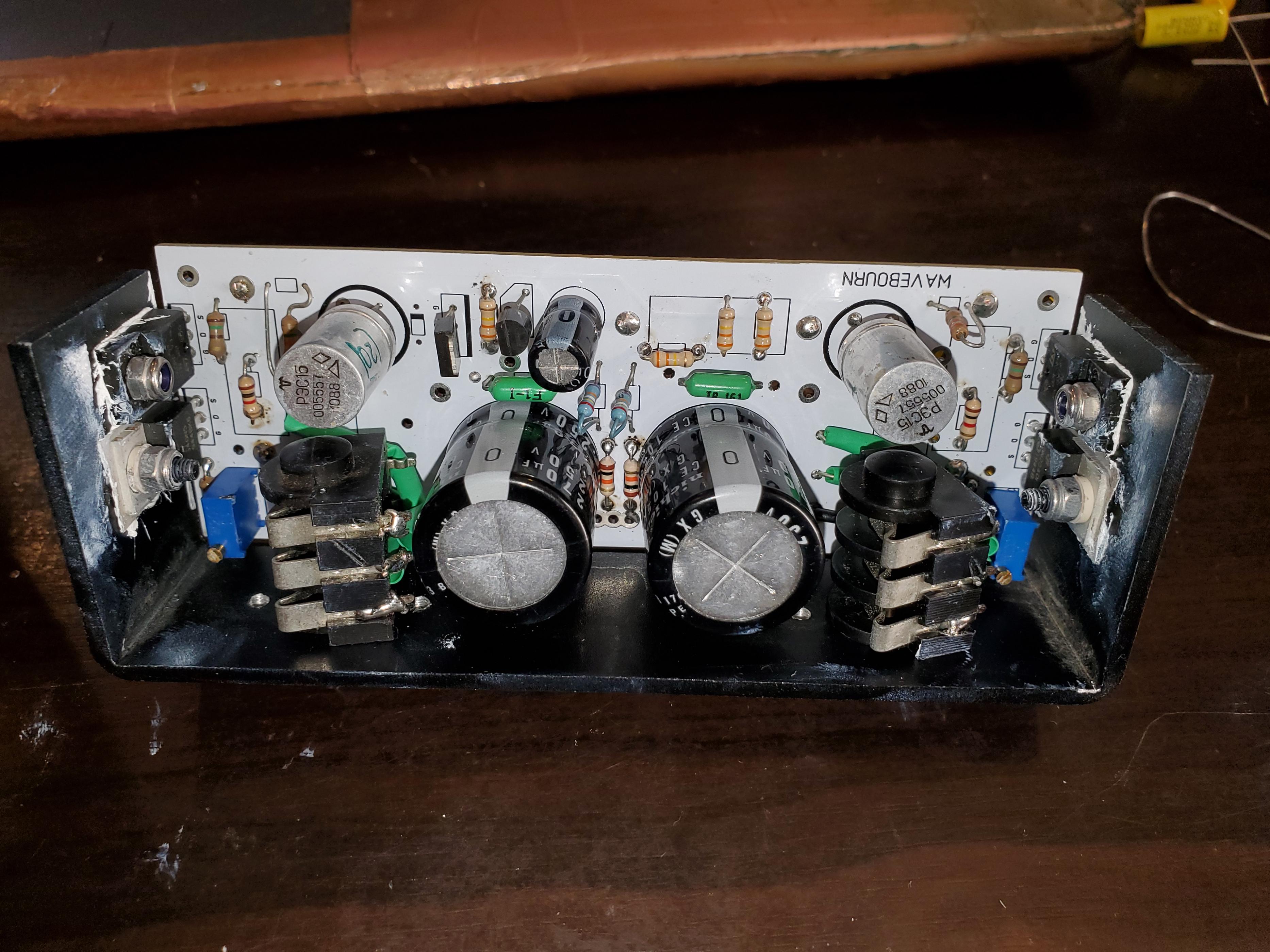

In Edelweiss-3 preamp+ I power relays from 8.6V hat I rectify for 8AL9 filament.
hen I sense cathode load voltage through 1 MOhm resistor and 100 uF capacitor for additional delay when tubes are hot, but caps are not charged yet. And this voltage on the 100 uF cap controls the relay through 2 MOSFETs (2 for shorter front when the relay gets powered).When powering off the preamp, filaments discharge caps in the PS pretty fast, removing voltage from the relay. You can see 2 round Soviet military relays on the board.
They shunt outputs directly to the ground.
Wavebourn,
Thanks for the pic and explanation.

The BC547 is the part switching the relay. You can use many types but I would choose BC547B or C when using small telecom relays. With relays that consume more power you need another transistor.

If I decide to mute all outputs I would need 3 relays.
if I connect the 3 coils in parallel would one bc547 be ok to switch all 3 relays.
I see the 5v pansonic relays have a coil current of between 14-50mA

No, sorry -- that won't work. You have the coils wired in series; they will need to be wired in parallel.
Two DPDT relays are all that is needed. Eliminate C14 (post 42) and connect the RCA's feed to the XLR side of C15. The bigger capacitor won't be any help (at driving lower impedances) as long as you keep the 125k Source resistors.
BC547's are cheap; use one per relay if you keep that circuit. But I would REALLY like to talk you into finding a more inspired one. That one has at least two significant shortcomings: It doesn't reset quickly on a brief (0,5 - 3 second) power dip; even the -C gain grouping of BC547's* will just barely be guaranteed to provide 15 mA @ 5V with only 22k from 6,3V of Base drive. Maybe you could track down a logic (low threshold - saturated @5V) MOSFET-based design.

Oh yes they should be wired in parallel.

Three 5V relays in series, a bipolar transistor, a protection diode, and . . .
A 16V supply should work pretty good.
Do not use a 16V supply and 5V relays in parallel.

So I've given it some thought and I will either remove the C14 (post 42) 10ufd cap and connect the rca to pin 2 of the xlr. This way i will only need 2 relays, ither that or i will just leave the rcas un muted, since they won't get much use. Either way 2 relays will do.
So the question is will the circuit work as is, if 2 relays are put in parallel?
Rick mentioned using one BC547 per relay, but I'm not sure how that would
look. Can someone sketch it out and post?
Just like the earlier post, but with each transistor driving one relay. Bases connected together, Collectors connected together, and each Emitter connected to its respective relay. I'll draw it for you later this eve (presently 18:30 local) if I have time.
