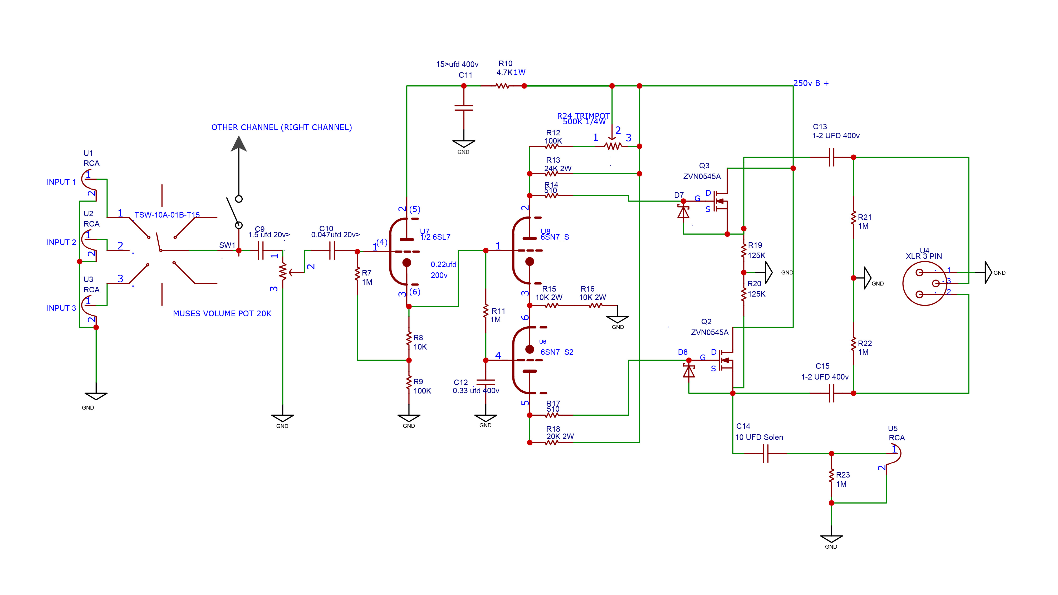

I think there is an error in the schematic as the coupling cap from the 6SL7 to 6SN7 is a short. Gate stopper resistors are too low in value with only 510 ohm. The schematic lacks stopper series resistors in all outputs. You can use 100 Ohm for that. The PSRR will be low so you wil need extremely good power supplies and extensive local decoupling (which is now lacking!). For optimal performance all stuff better would be situated close to each other on a PCB. I thinmk your device is now a transmitter. Please think of suggested changes, implement them if you like and report back. Only when all more or less standard things are done properly we can look into it when an issue still occurs.
Anyway, build what you like. IMHO you could use a way simpler circuit and have a better performing device at the same time. In 2020 one does not need much amplification with standard 2Veff sources. Most modern amplifiers already amplify enough so a buffer is adequate. Truth be told: most modern semiconductor amplifiers don't even need a buffer at all. Less = more.

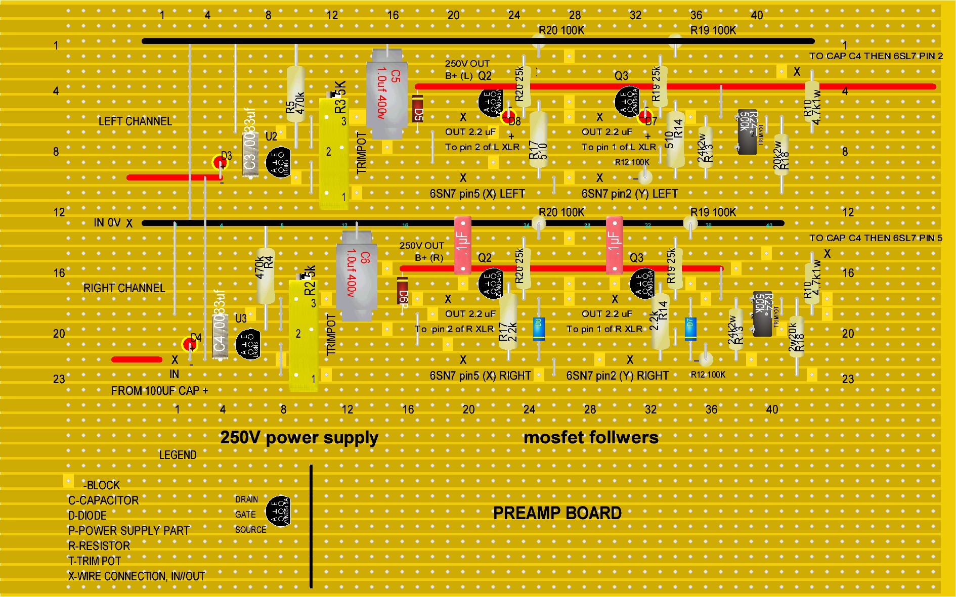

I've updated the schematic and drawing as requested. All the components should cross reference now. You can also see the power supply schematic for the 250v.

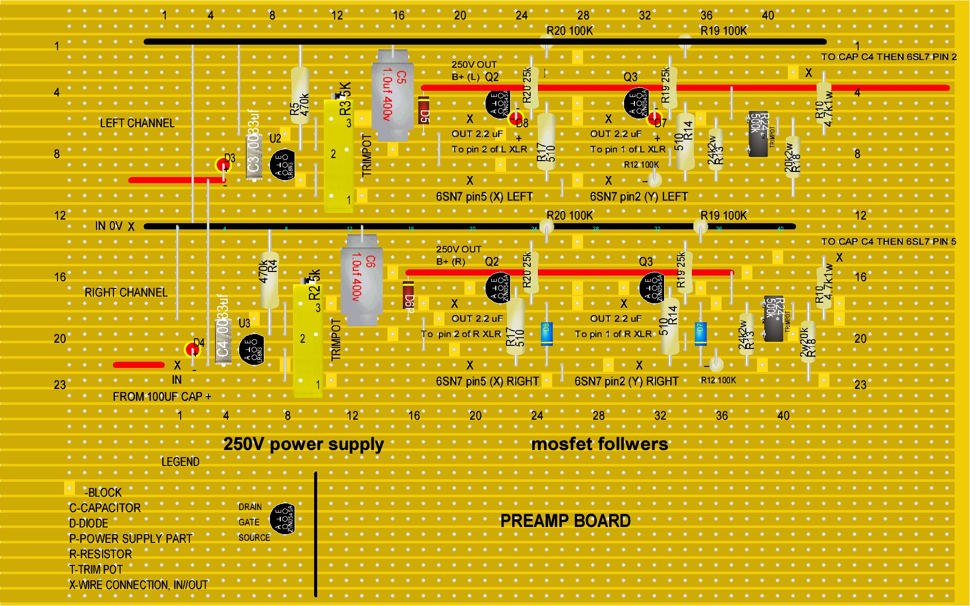

the strip board contains some of the power supply components and also some components in the preamp around the fets.

* If the goal is to keep things as simple as possible you are on the wrong track. Your tube power amp does not need any effect generator to drive it. In general tube amps are high input input impedance and high amplification. An input source selection switch and volume control would then suffice without any nasty side effect.
The schematic does not show a gate stopper.
A true gate stopper is the only thing that connects to a gate, or it is not a gate stopper.

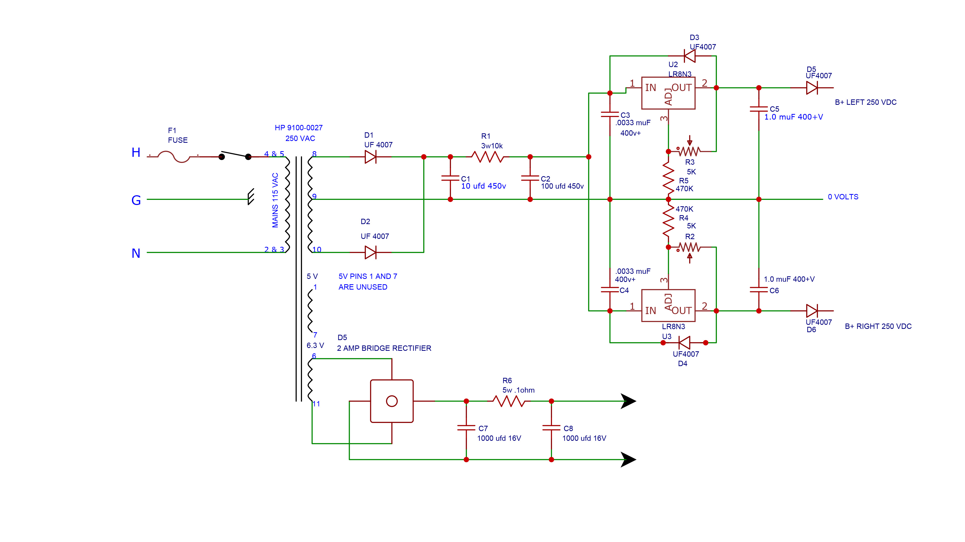

Good, you have protection diodes D3 and D4 on the power supply regulator ICs.
But what is the purpose of D5 and D6?
Your transformer secondary is 250V to center tap, Right?
That is 353V DC which is applied to the regulator IC Before the tubes warm up and draw current.
(no drop across the 10k, until current is drawn).
Is that IC rated for 353V input?
MOSFET followers gains are slightly less than unity.
What is the capacitance of either the XLR cable, or the RCA cable that you will use to connect to the power amplifier input?
What is the input capacitance of the power amplifier input?
What is the resistance of the power amplifier input?
That might be helpful to find what resistance you can try from the MOSFET Source to the output cap.

D5 and D6 are carry overs from Eli Duttman's power supply for his modded rca phono stage. Eli Duttmann's phono preamp voltages

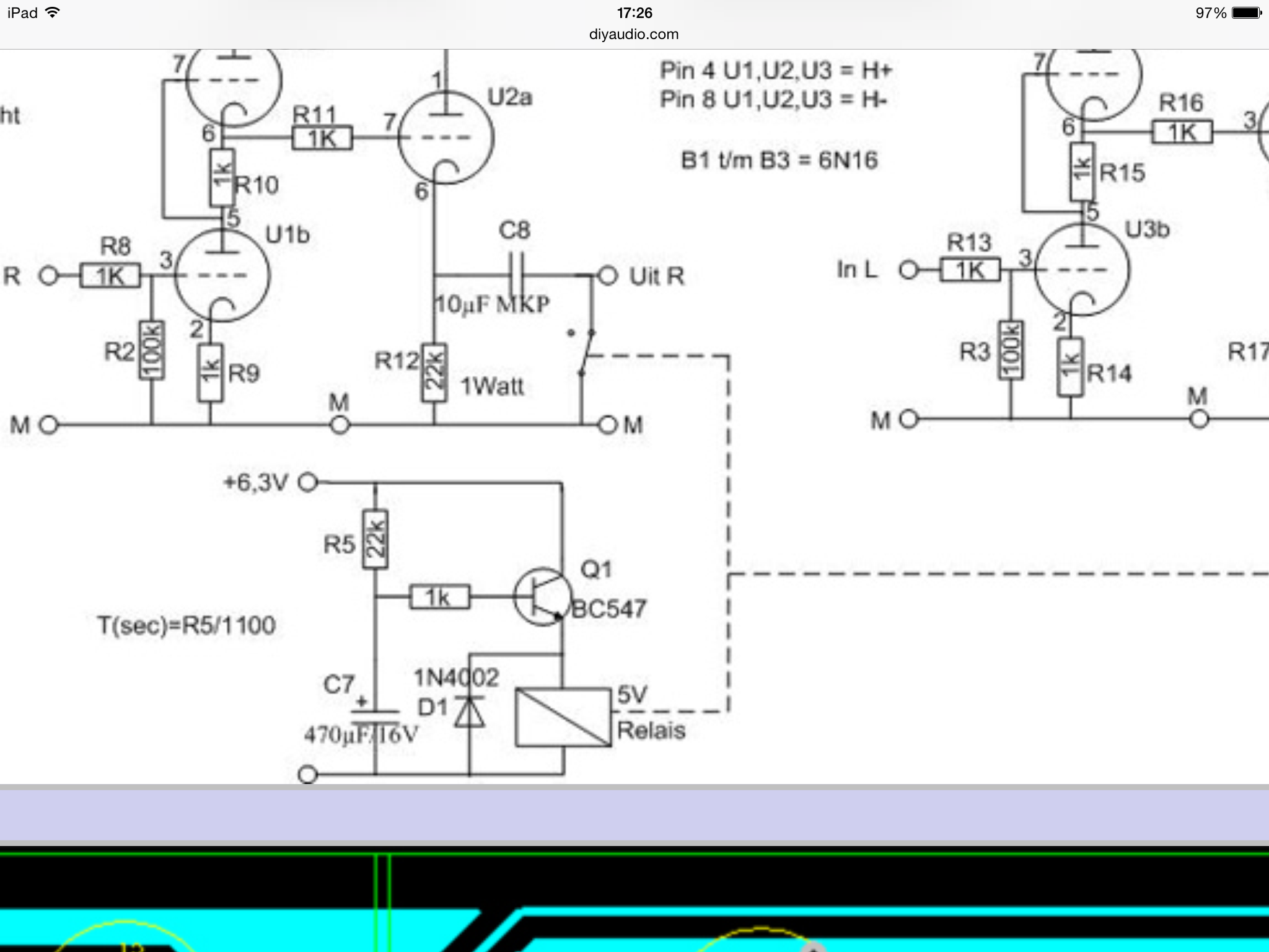

Thanks for the link for the muting relay. How would you mount something like that? My preamp has a bipolar power supply that is +/- 15v. I can use that to power it.

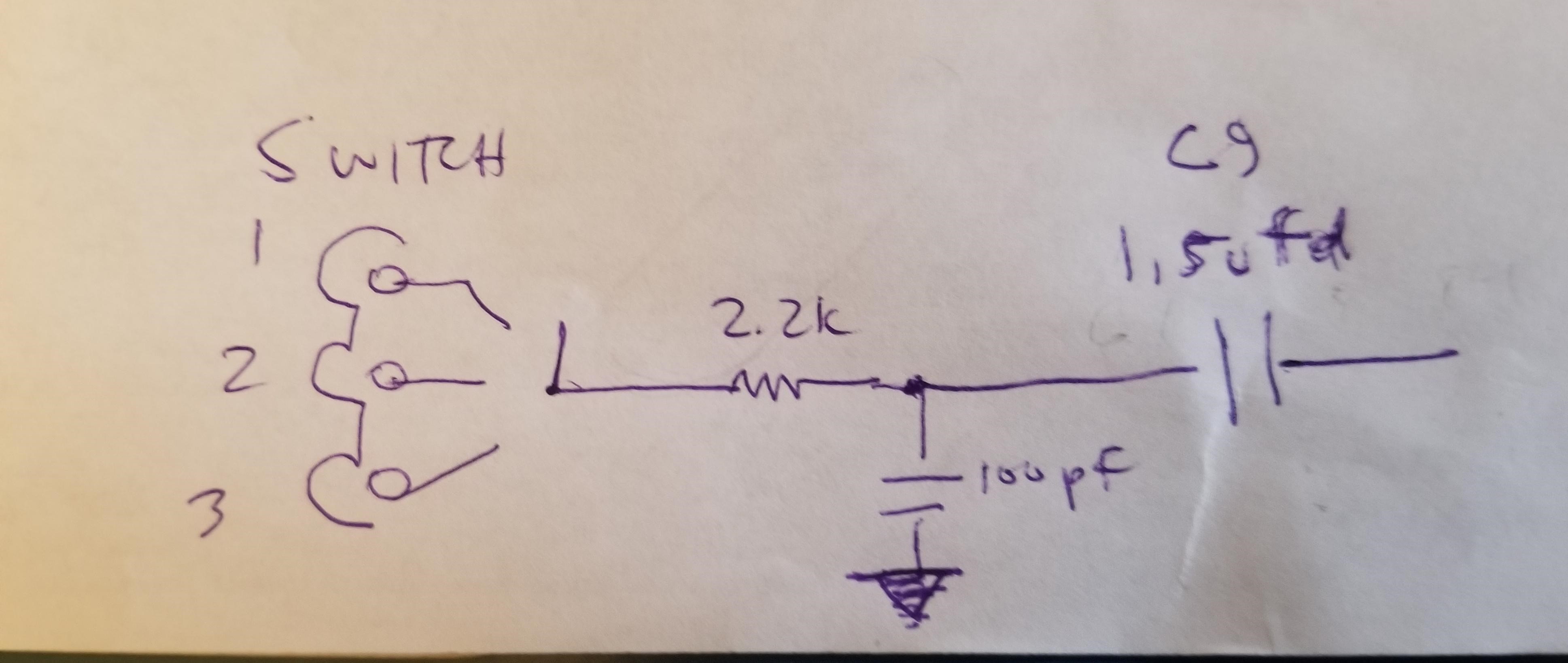

These maybe obvious questions, but remember I'm a novice. Can you clarify about the RC filter at the input. After the input switch do I connect the 2.2k resistor in series and then on the other side of the 2.2.k have a 100pf cap going to ground? Like the sketch i made?

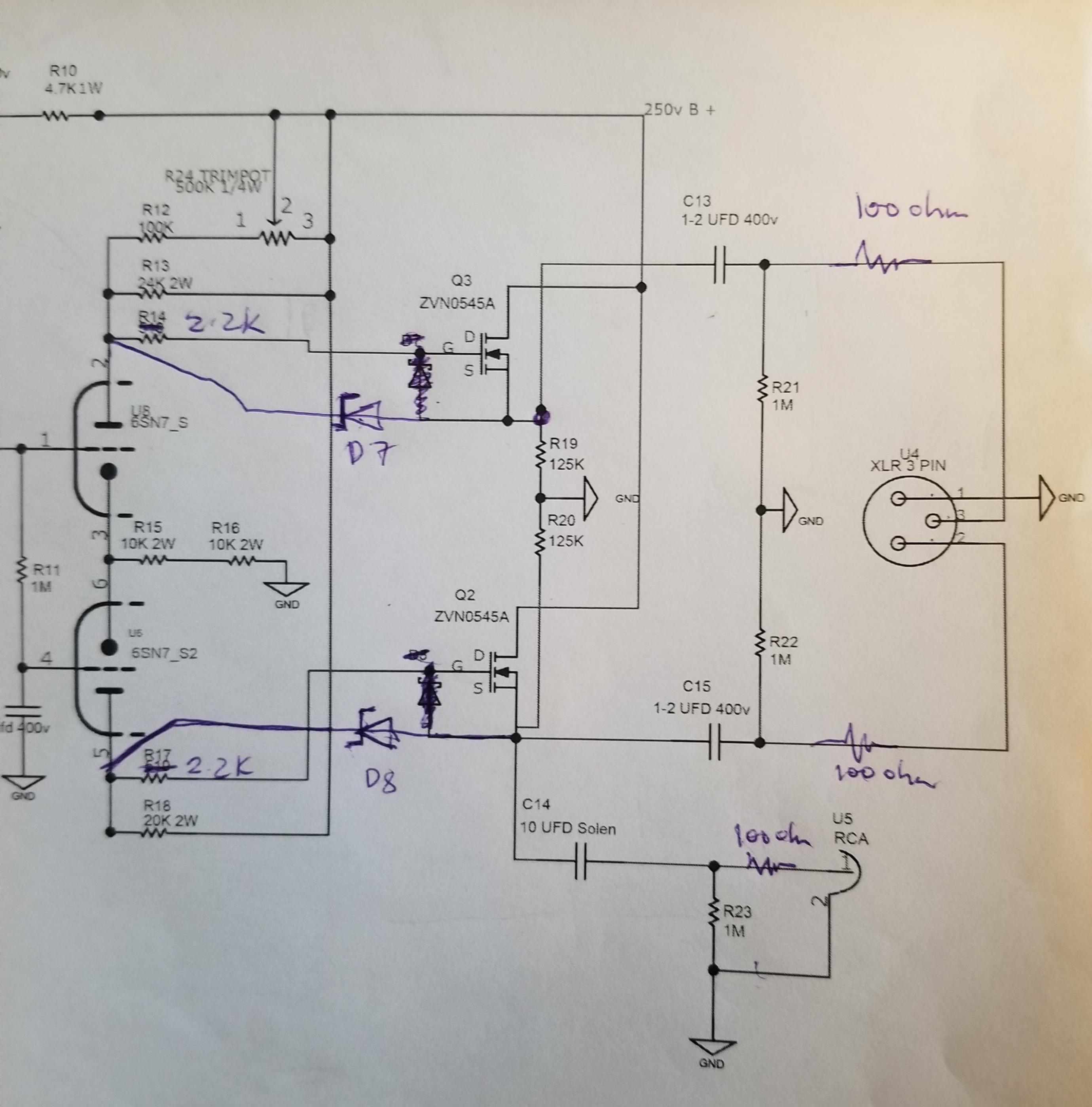

I'm also uploading a schematic where I've drawn in the output resistors and the 2.2k gate stopper resistor. Is my understanding correct?

Gregas, the drawings are both OK and all your assumptions are right regarding the input filter, RC filter for the FETs, the gate stoppers and lastly the 100 Ohm output resistors. You forgot the 0.1 uf decoupling caps direct from the drain pins of the FETs to GND. For the muting circuit you can use the filament voltage but you will need to rectify it with a Graetz bridge and use a 1000 uf 16V filter cap. I think you can use the muting circuit with a double pole double throw (DPDT) relay at the asymmetric outputs as you use those now. If you want muting on all outputs you will need a relay with more poles or more than 1 relay!
I tend to think that D7 and D8 were installed OK in the schematic.

It didn't make any difference with the white noise. I will keep the 2.2k gate stopper connected right at the gate. With no long wire; and a short copper strip, when i add the 2.2k gate stopper.

15v to 35V voltage input is what's recommended for the muting relay board you sent a link to.

I would use this muting circuit with the aforementioned Graetz bridge and 1000 uf 16V cap (diode bridge connected to the filament voltage). You can use a small telecom relay as it only shorts the outputs via 100 Ohm. It does not need to be a heavy duty relay.

Jean-Paul,
This is my strip board layout. The right channel (on bottom) is what the modification will look like. I've added the .1uf cap from the drain of the 2 fets to ground. Since the fets share the same 250v strip (the red line), would one 10 ohm and 47uf cap be enough for one channel? Do you think it would fit on my board? I have to look into the size of a possible 47uf cap. I guess it would have to go on the board since the circuit for the 250v is there?
Should the 2.2k resistor be C.C. or metal film? or perhaps it doesn't mater?
My first step will be to try the 2.2k gate stopper resistor and the 0.1 uf cap on the drain to ground. let's see if it helps. If not I will most likely remove the fet. My friend has suggested that it will not be needed with my tube power amps.

Omitting the FETs will very likely solve the turn-on thump/HV problem. If you were to keep the 125k Source resistors, it's just as well -- the FETs are serving no purpose with an operating current that low. (They only give lower impedance on positive-going signal excursions; any appreciable load at all will produce more distortion.)
Still have some studying to do on your post #56. But since you're considering revisions, in the meantime please consider omitting the 6SL7 1st stage. It provides no voltage gain, and the current gain serves no purpose since the load is another local valve grid. DC coupling it to the 6SN7s forces them to an uncomfortable, and completely unnecessary operating point.
The phase splitter looks like the designer combined two different designs, losing some better qualities of each in the process. I recommend dramatically lowering the Cathode resistor value and AC-coupling the signal from the volume pot wiper, biased at ground.
If you can't tolerate the additional gain, convert to a single-tube-section phase-splitter with equal Cathode and Plate resistances. Then you'd have each '+' signal at the Cathode, each '-' signal from an AC-coupling off the Plate. Then a single 6SN7 serves both channels -- a much easier design to get working properly.
There are also some issues with the filament supply, but lets hold off on those 'til the noise problem has been defeated.

I have a few questions about the muting relay setup. Perhaps you can give me some guidance?
What would the best way be to mount the muting relay components? A piece of stripboard? I'm starting to compile my list of parts for my order.
Do you have a parts list for the muting relay setup? Or the following components?
The telecom relay you referenced? I tried to look it up but haven't found the right one. It would make sense to mute all the outputs. 3 per channel so 6?
The bc547 transistor seems to have a few different types can you recommend which one I should use? Same for the 1N4002 diode. Thank you!
