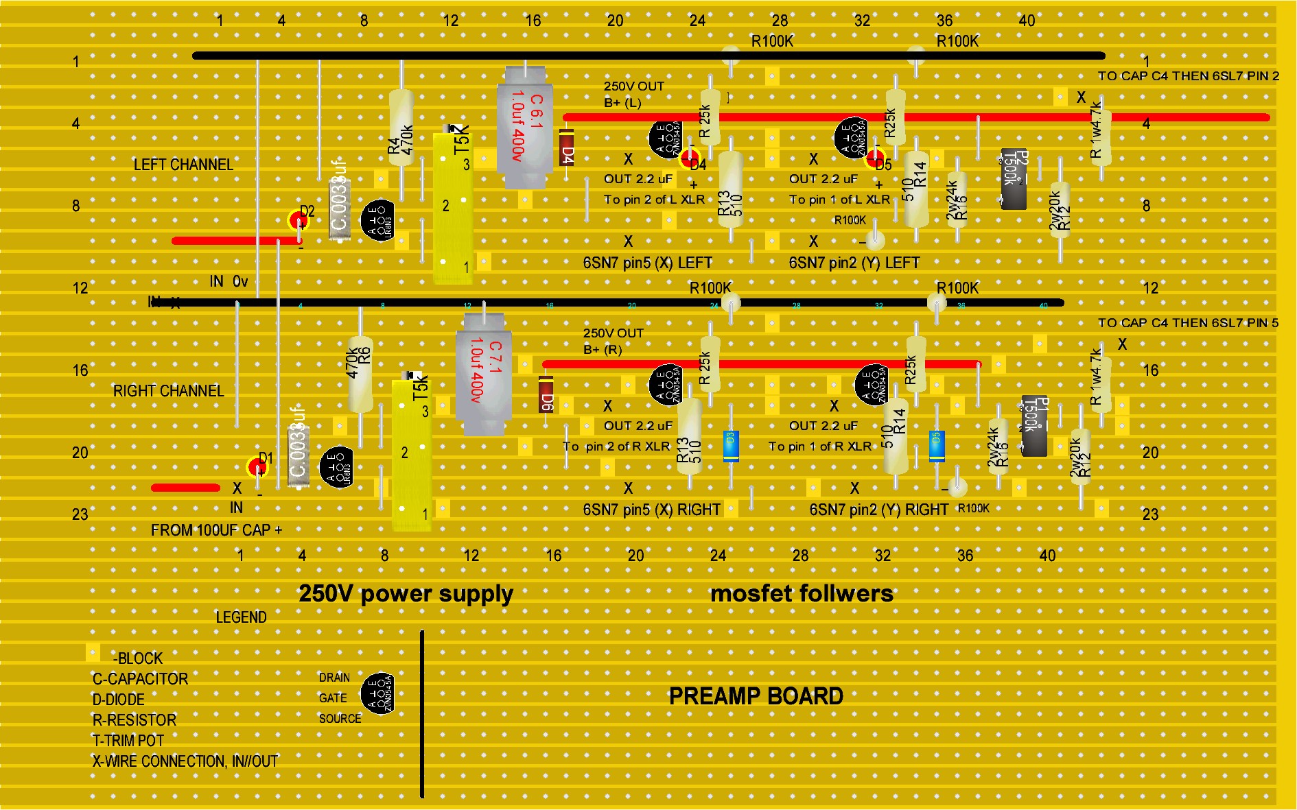

Here's what the proposed changes look like. The bottom (right channel)
The 510r is right on the gate. The resistor is between the gate and the zener.
I'm also going to replace both fets on this channel and trim the copper traces on this channel.

2. I am having trouble looking at your vector board, and seeing it in my minds eye, as if it were a schematic.
But I think that Post #1 and Post # 26 do not agree.
Where are all those additional diodes that I do not see in Post # 1?
Your schematic only has 2 MOSFETs. But your vector board Post # 26 shows 6 MOSFETs.
A total update of your schematic might be in order (not just the 510 Ohm gate stopper and Zener connections).

So i had some time today.
I moved the grid resistor and zener as suggested. I also trimmed the veroboard
strips. It didn't seem to make any difference. The noise is still present.
I only made the changes to one channel. It was a pain to remove items
and replace them. Btw. I used 2 new mosfets and 2 new zeners. Just incase
had gone bad.

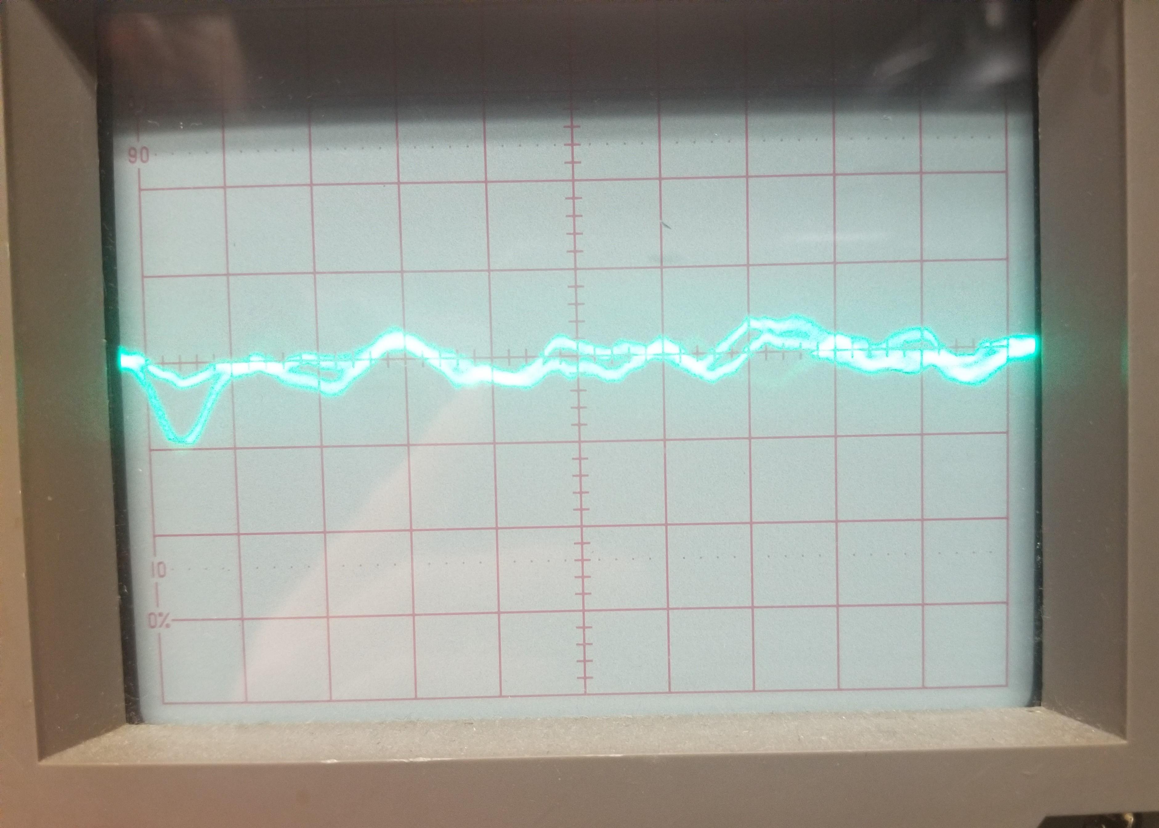

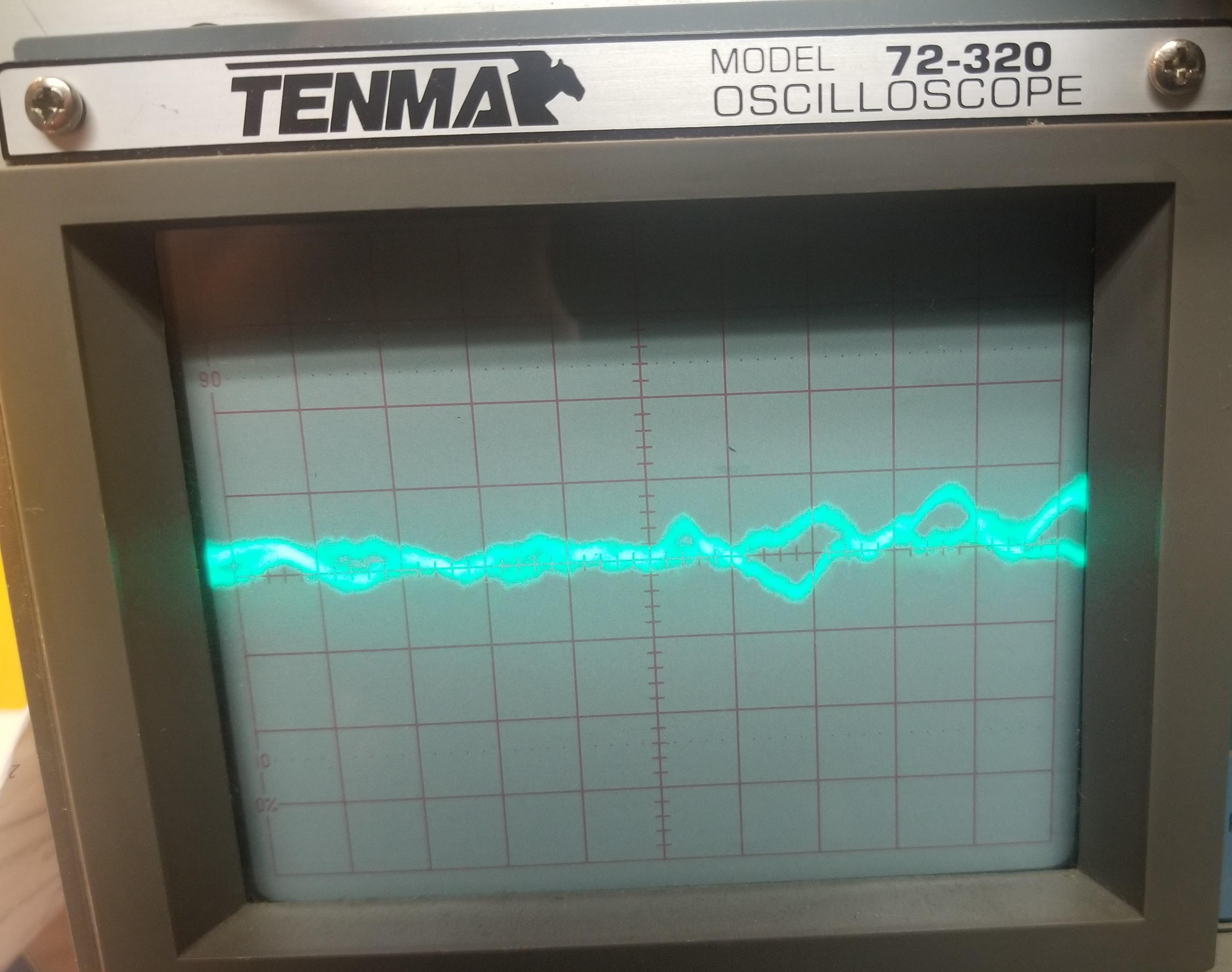

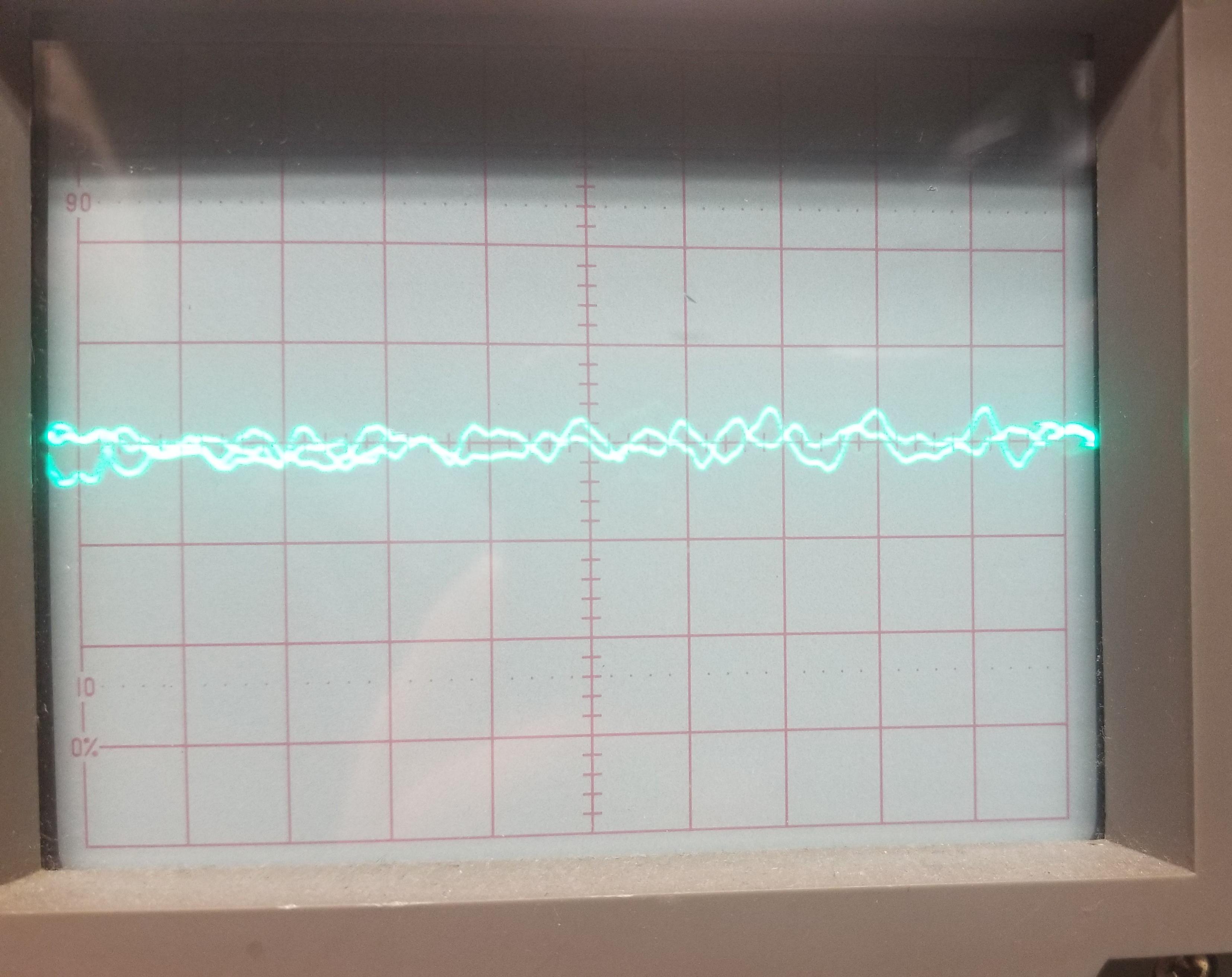

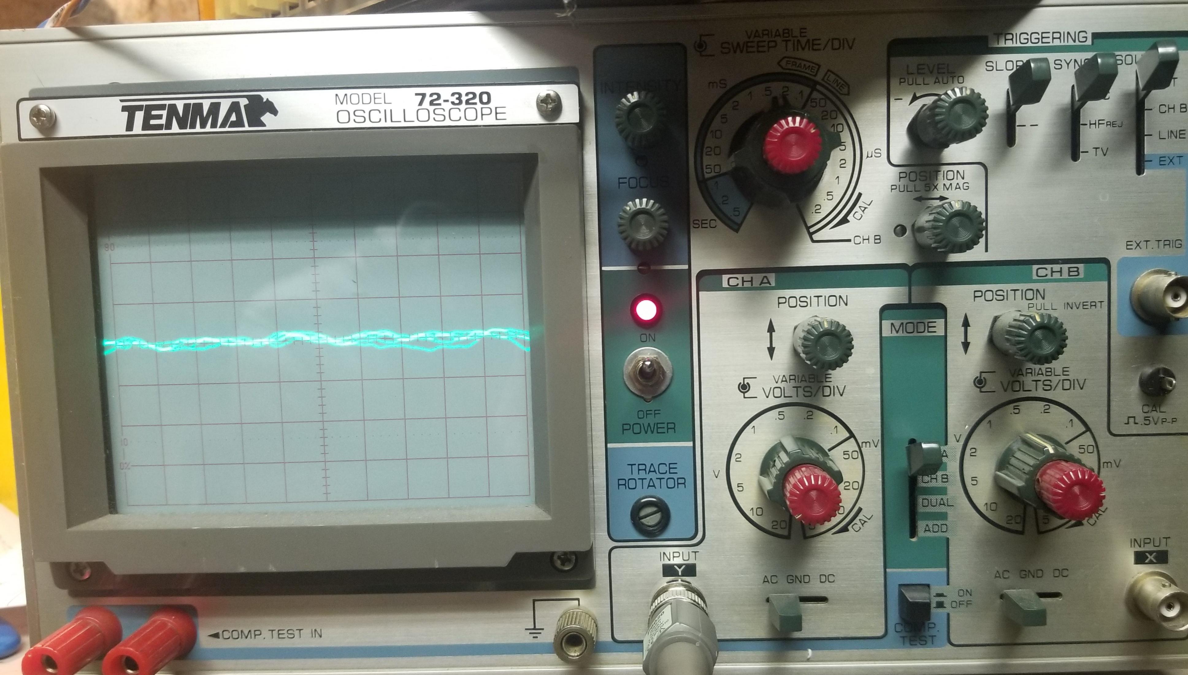

Hello 6A3sUMMER,
So I pulled out the oscilloscope I had and I'm learning how to use it for the first time.
Hopefully the measurements i took have some value.
First shot is the B+ after the 4.7k resistor in the first schematic. The time/div set at .5mS. The volts / div. set at 5 mV
2nd image set at .2 mS/div. same connection
3rd images at the RCA output. Time/ div .5mS voltage/div 5 mV set to AC coupled
4th shot same as above but dc coupled
I didn't notice much difference with the rcas attached, but i didn't try with the rcas connected from the preamp to the other amp.
