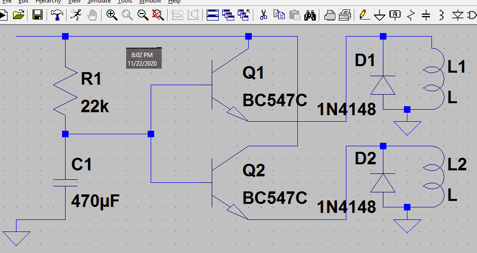

Here's the schematic - no great big deal.
Depending on your relay's current demands, one transistor may be adequate. But even all -C suffix devices may NOT have high enough current gain. The 22k resistor will have very little voltage across it as the relay(s) approach(es) full voltage, and therefore only providing a dabble of Base current for the transistor(s) -- 32uA unless I've booted the arithmetic. That's only 13,4mA even at the median beta of 420, which is higher than the lower half of the pool of -C devices -- by definition. Further complicating things, specs for beta are typically at a higher Vce, usually 10V or so. All BJTs are less conductive as the Vce drops; these will only have 1,3V across them if the supply is 6,3V, less if it droops.

Thanks for taking the time out of your day to sketch up the
muting relay schematic. My parts order selection is coming along.
I was thinking of using this relay DS2Y-S-DC5V Panasonic Industrial Devices | Mouser Canada
should be good?
I'll order an extra to keep around if one goes bad.

Yes, the DS2Y-S-DC5V from Panasonic should be fine, with a couple minor caveats:
- a little more current hungry than we'd prefer -- but we can work with it
- it is a Not Recommended For New Designs, which is a bad news / good news thing: If a replacement is ever needed, a 'direct' one may not be available; but the price is likely better.
Oh, and before I forget again: Practically any diode will work for the 1N4148's -- even most of the 1N400x family, or about any other 1A rectifier you might have handy.

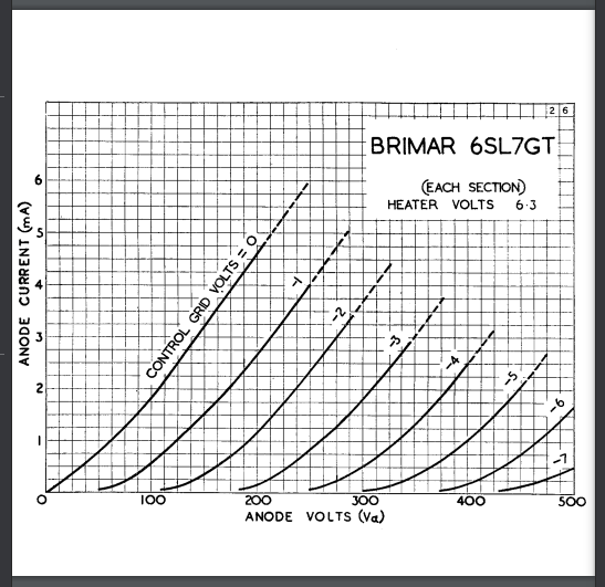

Would still like to persuade you to consider omitting, or substantially re-biasing, the 6SL7. As a Cathode Follower, its job should be to lower impedance. It can't do that with a 110k load; unless I mis-read the graph, that places the current in the low 300's uA range. Worse, being DC-coupled to the next stage forces it into yet another non-ideal operating point.
Stage by stage the impedance just keeps going higher and higher .. 😕

Hey Rick,
I was taking a closer look at the schematic for the muting circuit with the dual relay you drew up.
I was starting to think about how I was going to mount it on a strip board.
I noticed that you don't have the 1k resistor that Jean-Paul had in post #54
was that on purpose?

Not particularly -- but the 1k is considered good practice in a common-Emitter circuit. I usually leave it out on an Emitter-follower; it can be handy for trouble-shooting, though, since it allows a peek at the Base current, giving a better indication of how *turned on* the device is, than measuring the Vbe can.
Eager to hear how installing the 2k2 Gate-stoppers turns out, though.😉

I found this online regarding the transistor. It talks about that resistor. I should be able to install that 2.2k resistor along with the other parts on the strip board in the next 2 days. I will let you know.
BC547 as Switch
When a transistor is used as a switch it is operated in the Saturation and Cut-Off Region as explained above. As discussed a transistor will act as an Open switch during Forward Bias and as a Closed switch during Reverse Bias, this biasing can be achieved by supplying the required amount of current to the base pin. As mentioned the biasing current should maximum of 5mA. Anything more than 5mA will kill the Transistor; hence a resistor is always added in series with base pin. The value of this resistor (RB) can be calculated using below formulae.
BC547 as Switch
RB = VBE / IB
Where, the value of VBE should be 5V for BC547 and the Base current (IB depends on the Collector current (IC). The value of IB should not exceed mA.Uh .. erm .. couple o' things:
1) it is not a switch in this circuit -- just a buffer providing current gain
2) please be skeptical of the website this came from --
- a) the Open/Closed switch / Forward/Reverse Bias sentence has it BACKwards
- b) not many transistors are *killed by anything more than 5mA*
- c) "VBE" is misused
- d) the formula is oversimplified and misleading
- e) they seem to have conflated reverse breakdown Vbe, and forward bias; the latter
will most likely measure around 600mV in a normally-operating circuit; but Collector
current will vary over 5 decades as Vbe ranges from 400 to 700mV
- f) if a BC547 ever measures 5V of forward bias, Base to Emitter, replace it promptly! 😉

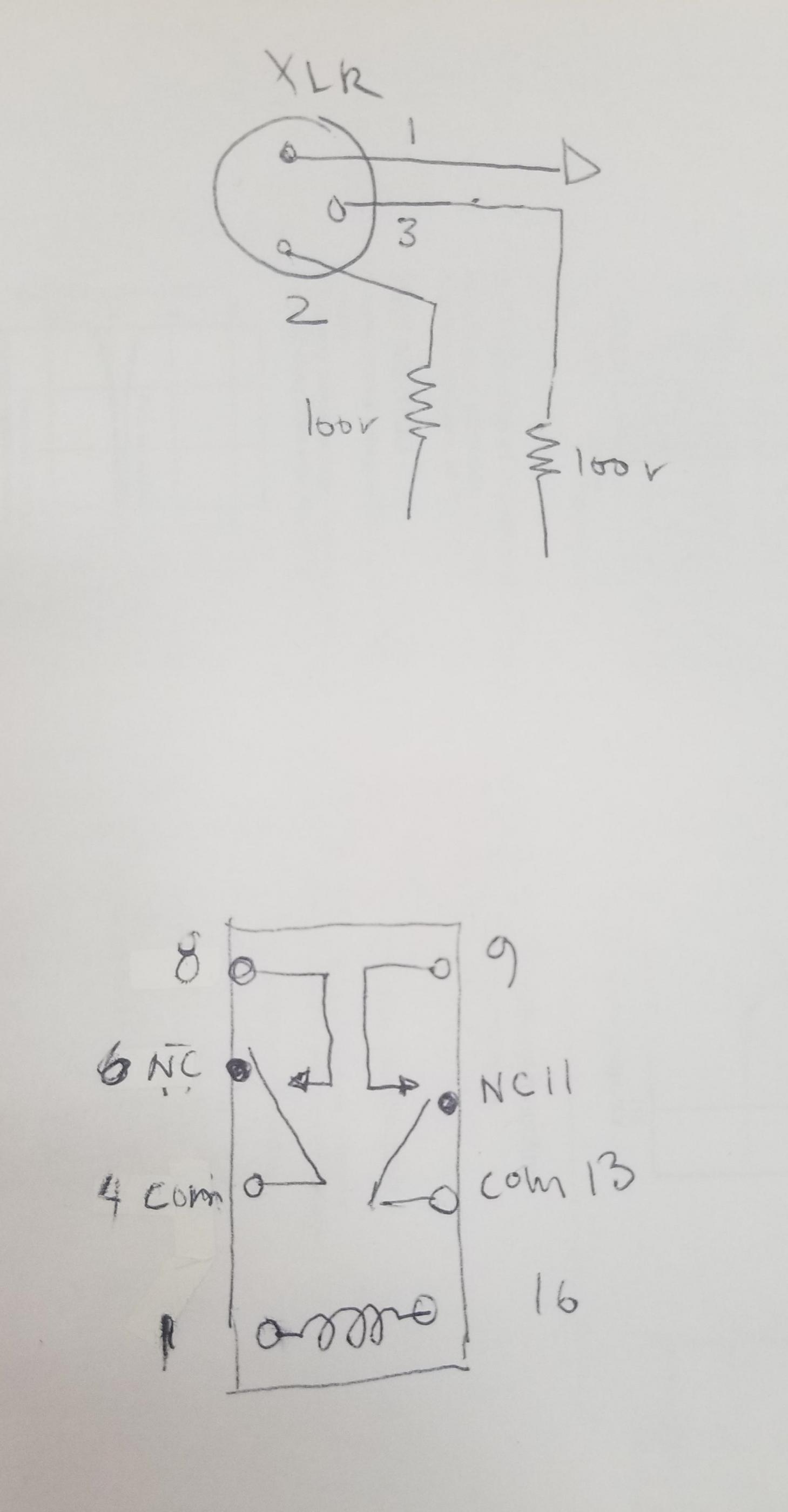

Hey guys,
So the Preamp is with my friend he's going to trouble shoot the issues that it has including the hum. Rick I'll let him know about your concerns.
I'm trying to figure out the muting circuit relay connections at the moment.
Is there anyone who can explain how to connect the relay to the xlrs?
I've included a pic of the relay pinout/schematic .
