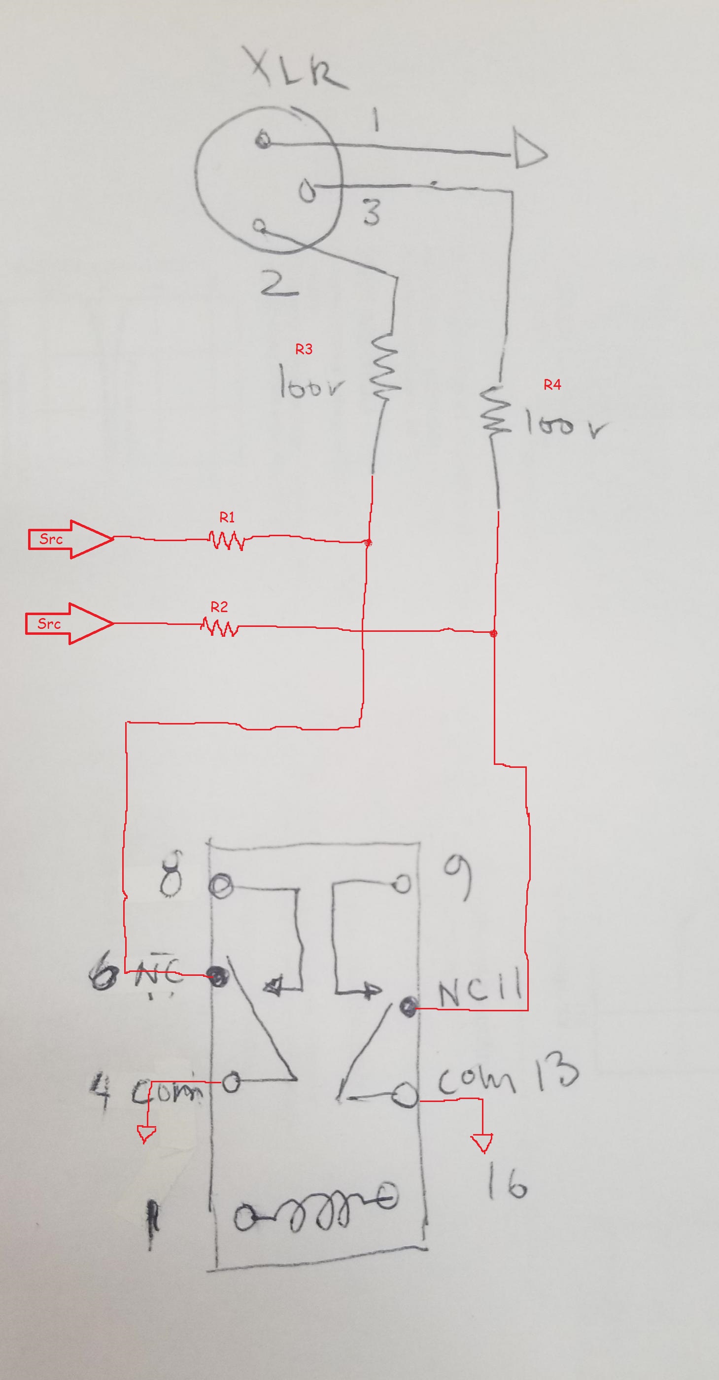

Here ya' go . .
. . and no need to have both R1/R2 and R3/R4 -- but I figured you might have already mounted R3/R4 on the XLR. If so, it's fine to keep them. Just fit two more -- R1/R2. If R3/R4 aren't already placed, all you need is R1/R2. The object is two-fold: To leave some resistance when the mute relay NC contacts are otherwise connecting the outputs to ground; also helps the output stage ignore the cable capacitance.

IMHO you can have only R1 and R2. The relay contacts should short the outputs to GND (AFTER R1/R2) and then you still have 100 Ohm in series. No need for R3/R4: no power amplifier/device has a problem with a shorted input except when designed peculiar i.e. with quite some DC at the input. Even then a well designed device has input resistance. It was all explained that the resistors have 3 purposes in post #44. It would be OK if you pin that text and put in on the wall in your hobby room.

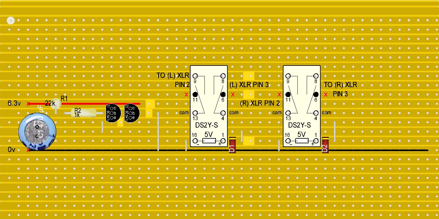

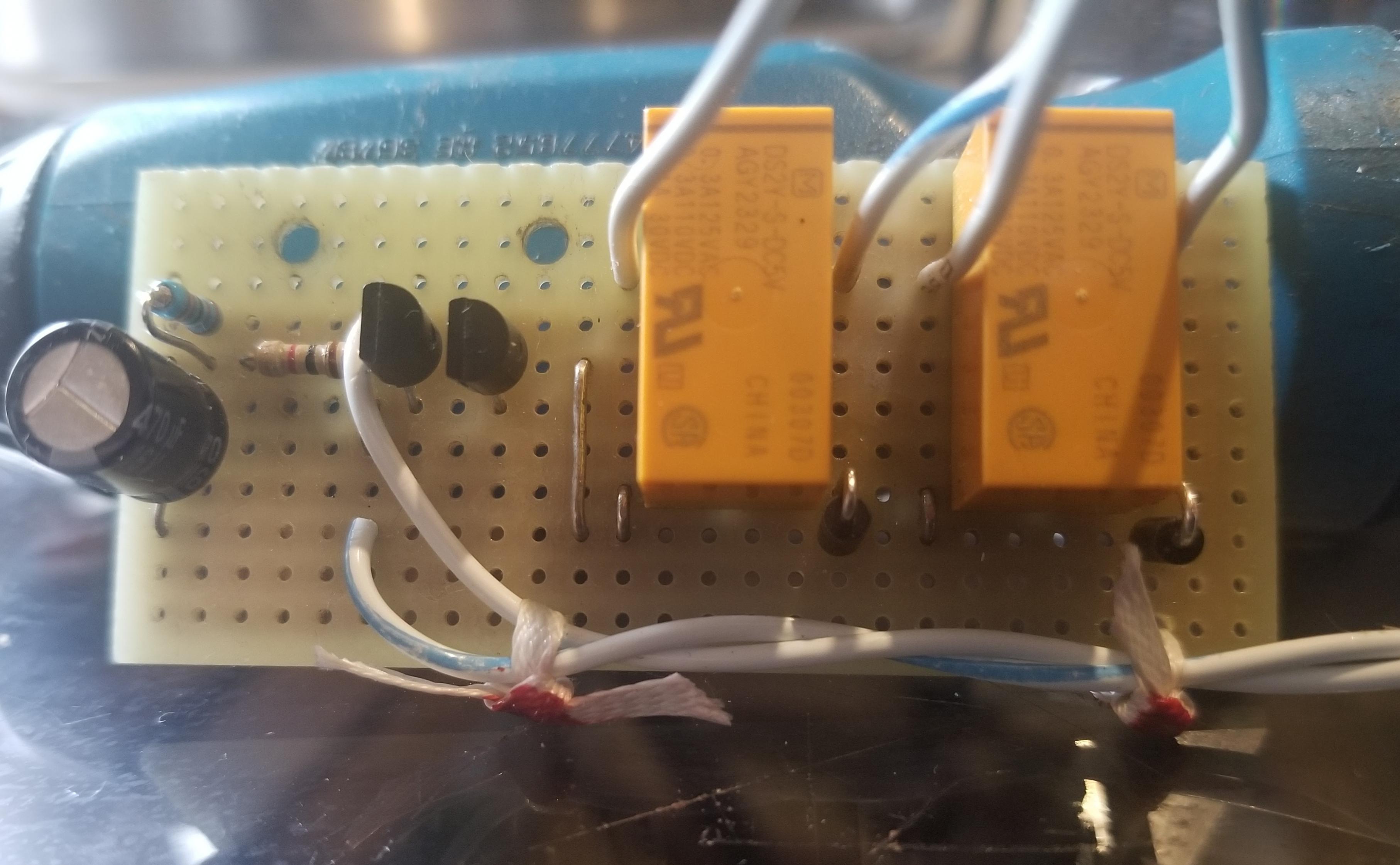

I'm having issues with the muting circuit. Perhaps some one can suggest how to troubleshoot it. Here's what it's doing. When i turn on the preamp after about 8 seconds one relay coil activates. That unmutes one xlr. The other relay doesn't activate unless i tap on it. I measured the voltage at the cap. and it slowly builds up to 2.6vdc the stays there.
Any ideas?
How many of the BC547C's do you have on hand? It's likely that one of them doesn't have high enough DC current gain to provide 40mA for the relay coil. One of the drawbacks of the circuit is that it requires fairly high gain devices, especially for a longer delay interval.
One other possibility that comes to mind -- some of the BC p/n's come in more than one pin-out. Are you sure that yours are C-B-E, left-to-right, looking at the flat face, legs down? That is one of the less-common pin-out options, by my experience at least.
Disconnect one of the Emitter-relay connections and check voltages.
Then you can lift one leg of the electrolytic to eliminate its leakage current (as a factor affecting the DC voltage, and to speed up testing).
One other point -- I recommend removing the ground connection to the relay commons. Keep the drive traces to the coil, of course. But instead of sharing the ground with the contacts, run a twisted pair or shielded lead just from the XLR to the relay contacts. Take advantage of a relay's electrical isolation whenever possible -- fewer symptom surprises to troubleshoot later -- and in the long run.

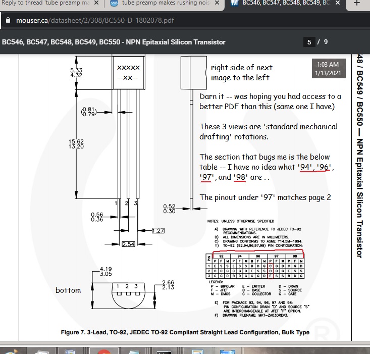

I ordered 10 bc547cta transistors.https://www.mouser.ca/datasheet/2/308/BC550-D-1802078.pdf The drawing confuses me I'm 100%. Can you make sense of it? Is the drawing on page 5 looking from the bottom or the top, for the view on the bottom?

Lower-most drawing is the bottom view.

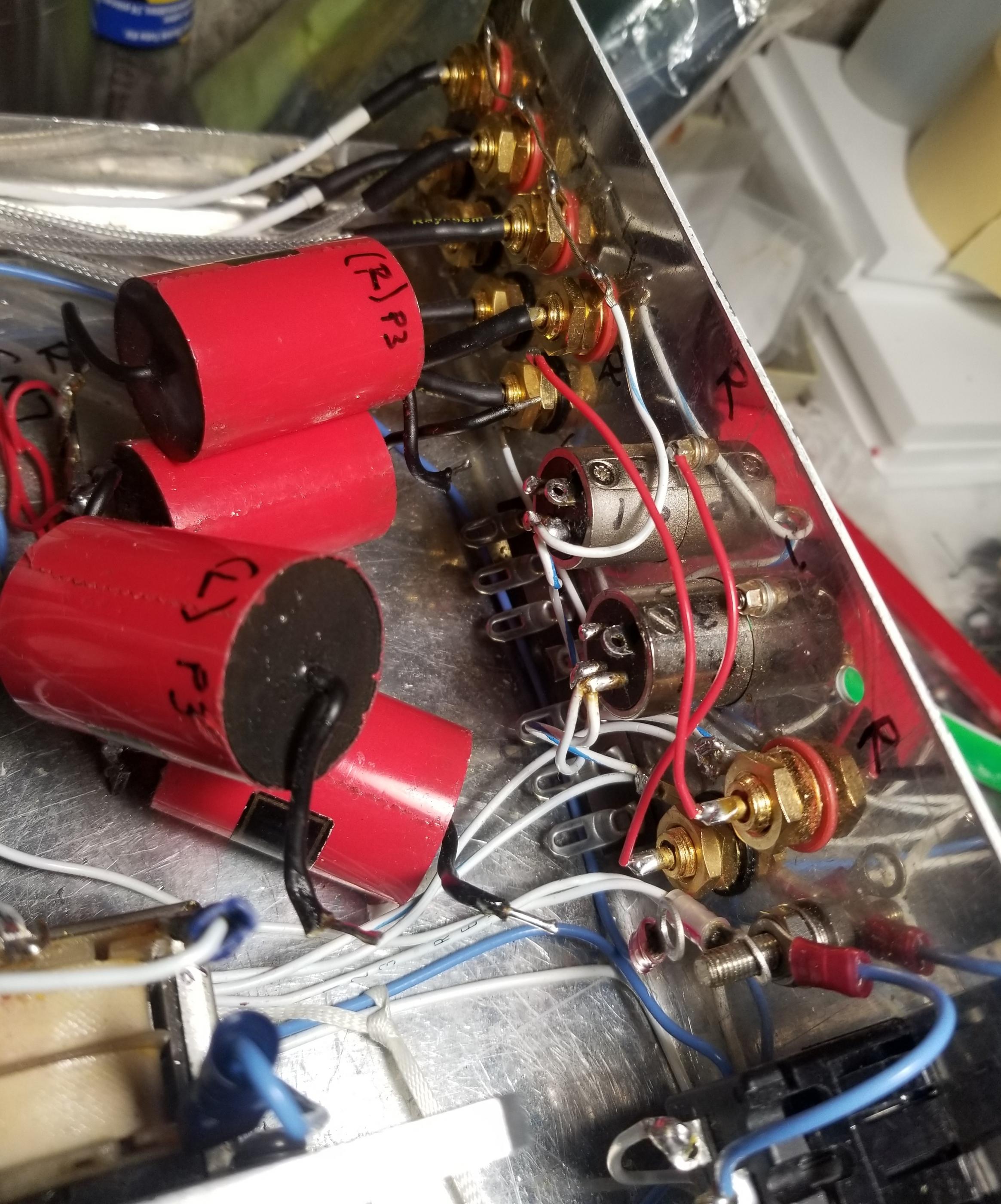

Hey Rick,
Right now the left channel input grounds are all connected together
Same for the right side grounds. They are then connected to the volume control circuit which then connects to the main chassis ground. (I have a remote controlled volume control). Thr manufacturer suggested that I do it this way.
It would be a lot easier to connect the relay ground to the chassis ground. Would that be ok? Where all the grounds connect to the chassis. The xlr ground pins already have 2 wires soldered nicely and I'm hesitant to undo it.

But i did try to swap out the relay that wasn't firing. It seems better with the other relay relay, however they're still not firing together. Even on the same relay between one pole and the other, there's an 8 second difference.
The short answer (to post #137) is, 'It would be OK, IF IT WORKS!' :D
There's quite a bit of *art* to grounding practice, as there is *science*. (Hope I don't have to mount body armor to defend that assertion.;))
Dunno how an DPDT relay could have an 8 second difference between poles -- there's only one armature serving both sets of contacts . . Hmm-mm . .
It is possible (and has happened), that a relay's contacts form a thin poor-conducting film after sitting on a shelf for too long. The earlier mention of having to tap on it suggests exactly that. If you have a means to drive it with a 40 to 80Hz square wave for a few 10's of seconds -- *giving it some exercise* -- should shape that up. In the bygone days of VCRs, many a head relay surrendered to that treatment. That and a touch of Cramolin, if the cover snapped off.
The xlr ground pins already have 2 wires . .
has me wondering -- can't think of a good reason for '2 wires' . . please explain.

edit: Sorry, I was still working on this while you posted #138. Will take a minute to puzzle that -- may require a different circuit. Certainly no 5V relay should be expected to operate reliably or consistently at 3,9V (what's left at the Emitter if the Base is 4,5V).

Here's an image showing the grounding wires on the xlrs and the rcas.
inputs are the rcas on the left. The xlrs and the rcas on the right side are the outputs.
