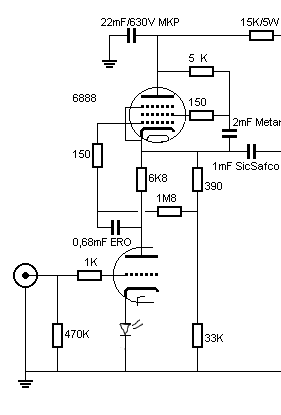

Geek said:Hi guys,
Did some benchwork tonight on I design I've been meaning to get to.
So far, it seems to fit the bill, is simple, provides great performance, ONE TUBE per channel and can be built with commonly available parts. Schematic attached with the values I used in the test.
Transformer can be had from Radio Shack, their 12VCT, 2A seconday piece. 12V back-to-back. One ECC88 filament on one 6.3V leg, the other on the other 6.3V leg, CT grounded.
Since the SEWA has a Zin of 100K || 250p, I did the tests with a 2:1 margin, or 47K || 470p. Here's some pics of the results.

In your schematic it says "Voltage Gain, 27-28", isn't that far too high for a preamp?
I like your design because those parts are easily available.
Would it be a suitable preamp to any power amp? or just the SEWA?
Hi Max,
The SEWA needs around 20. Gives some headroom for quiet sources.
You can use it with anything. Just reduce the gain a wee. This can be done by either a -6 to -10dB pad or by replacing components.
By replacing the LED's and 470 ohm resistor with 680 ohms and making the 10K resistor 1K. Adjust power supply resistor accordingly. Disadvantage of the component change is is higher output Z and increased noise. Personally I'd use the atten. pad.
maxw said:Would it be a suitable preamp to any power amp? or just the SEWA?
