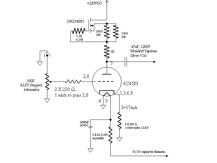

I understand... 🙂 But what I am curious about is what do you trashy people want? 😉 Just to try anything with valves? Or the best valves have to offer?
I'm not really experienced at all...it just looks that way 🙂 But before someone can give you good advice you have to know what you want. Hence my question...must it be cheap or expensive? Transformer coupled or cap coupled...etc., etc.
I'm experienced enough to know that it is easy to make a valve pre-amp. To make something outstanding is a whole different ballgame.
A job for Mr. Aikido? Pretty simple, selectable gain, low output impedence, non-exotic power supply (maybe even share the supply) - 6DJ8 version? Maybe a single 6DJ8 triode for the input side and 6GM8 for the follower?

How much current is each section drawing? (even if i wasn't half asleep i'm not yet able to look at the circuit and figure that out). The IXYS chip has a minimum of 10 mA.
dave
from schematic in this post
http://www.diyaudio.com/forums/showthread.php?postid=998055#post998055
I get it the input impedance is ~50 kOhm.
The minimal output current needed we get from:
Voltage input (for maximal output) / input impedance.
The input voltage needed in relation to input impedance will give the current that must be provided.
Very correct an amplifier is always an adapter
between a source and a load.

Bas Horneman said:My suggestion based on those requirements would be to build something like Douglas's (Sector7G' or Bandersnatch on diyAudio.com) Guinevere but with (a minimal reactance psu - not shown here yet). And instead of the relatively hard to get depletion mode mosfets use that IXYS 10m something part. Tube could be 5687 or the 2 dollar supertube 6n6p.
I use something similar for a DAC gain stage after a passive I/V.
http://www.ecp.cc/5687_module.html (I might even have an extra one of these boards laying around ...)
I also have a board showing up in the next few days for a 6n6p/6n30p based one of these that uses either LED or standard resistor biasing.

Fuling said:
ECC86
is about as low in NOISE you can get with tubes.
Has been used in 1.000 of low noise preamps for almost as long as existed.
And many Professional equipements and microphone amps use it!
A short explanation of the schematic:
The triode is of course the actual gain device, operating at 15V 2mA.
The plate is loaded with a 2SK170-based CCS
and direct coupled to a cascoded Jfet White follower.
Your circuit setup is interesting
and really deserves some try out!

Thanks for shown interest!
The circuit is under evaluation, but initial testings indicates that it is perfectly capable of driving an IRFP260-based follower to 50kHz without loss of gain.
My PSU is not quite up to the task, and either the cathode resistor or the 175R reistor in the CCS must be made adjustable to set the operation point for max linear output swing.
I´m definitely going to make something out of this some day when I have the time, there are plenty of more important projects in the pipeline right now.
Another added advantage is the low voltage b+ one can use!
Direct coupling to the output stage was a major design goal, if I had to use a coupling cap I´d definitely choose a more potent tube and skip the White follower.

Even the capacistanse of the Mosfets?Some say it won´t,that´s why I decided to go for a CF..🙂should handle that MOSFET's without any issues.
A CCS-loaded 6C45 would have about 1kohm output impedance, which might me a bit high.
The same tube with a 3:1 stepdown transformer on the output would probably be much better suited for the job!
