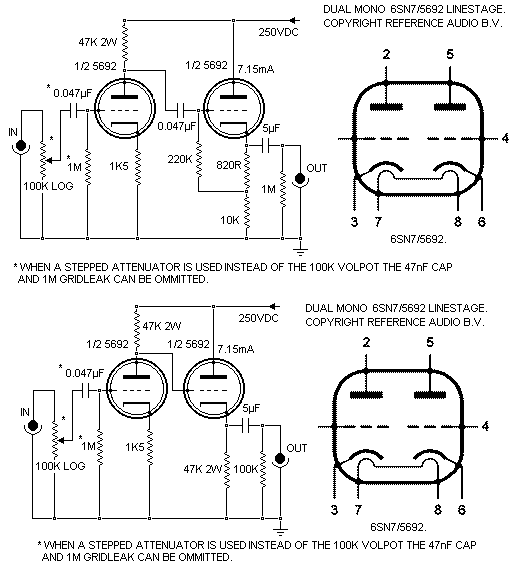

RJM Parallel Triode Line Stage
What you tube people and SEWA owners think of this RJM circuit?
The gain is too much for a line preamp,
but what about the idea, of parallelling fairly cheep triode tubes
to get better drive in the output?
Here is the circuit:
And here is the link to RJM project page:
lineup
Parallel Triode Line Stage.
Primitive ART and a nod of appreciation to Conrad Johnson.
If I needed a line stage, this is the circuitry I'd use.
The parallel tubes lower the noise and output impedance.
With four 6DJ8 triode sections per channel, the output impedance is 850 ohms.
Gain is about 26 dB.
lineup

Cathode follower has no gain, so it would have to be used with a preceeding voltage gain stage. Ideally the cathode of the follower would be a CCS or a significant nagnitude B-.
You then have basically a "ForePlay" style preamp in front. Certainly an option.
dave
dave

Design Goals:
1. Gain 20-40, this will alow a cd player to drive the MOSFET to full output.
2. Low output impedance. Wide Band performance.
3. Low parts count. We are using this to drive SEWA, otherwise would be wrong from a purist standpoint.
4. Output Swing 20V p-p minimum to assure we can get all 7 watts out of the MOSFET.
5. SE design no NFB.............thats my goal, but don't think it's unreasonable.
I think even Mad_K, the master of puristic simplicity, could live with a 2 tubes pre amp.
This is his comment on a Kaneda legendary 5 transistor schematic. ( Kaneda Schematic here )

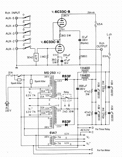

Sitting here listening to my newly made Sewa amp,I am driving it with my Mu folower with 6C45 and 6888,I have in a box as a preamp.I think it´s working fine can´t see what the problem should be of driving the mosfet.If it shouldn´t be so fine should the frekvensy response be bad or what,maybee I could test it with RMAA and see.
Care to share
Ryssen, care to share the schematic with us.
I think this should be a great choice, I like the 6C45 a lot, and have used a Solid State CCS, but a pentode on top is a very good choice indeed.

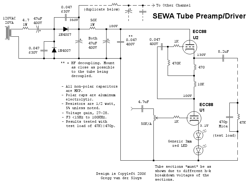

Hi guys,
Did some benchwork tonight on I design I've been meaning to get to.
So far, it seems to fit the bill, is simple, provides great performance, ONE TUBE per channel and can be built with commonly available parts. Schematic attached with the values I used in the test.
Transformer can be had from Radio Shack, their 12VCT, 2A seconday piece. 12V back-to-back. One ECC88 filament on one 6.3V leg, the other on the other 6.3V leg, CT grounded.
Since the SEWA has a Zin of 100K || 250p, I did the tests with a 2:1 margin, or 47K || 470p. Here's some pics of the results.
5KHz Squarewave
15KHz Squarewave closeup
Full tilt - that's 160V P-P at 1KHz
The input impedance of SEWA Rev_d ( see attached schematic )
which i think is latest published version,
is the sum of 3 impdances:
- R2 100 k , this is needed to bias SEWA to 1/2 supply voltage
- input impedance of MOSFET Q1, this is probably so high we can put almost infite value = not needed to count this
- R9 100 k, this is not really necessary, but is good for charging input cap
as well as terminate signal wire closer to input jack
100k in parallel to 100 k, 100k//100k = 50 kOhm
Rev D as seen in picture has got an input impedance a bit lessthan 50 k
say 47 kOhm
Now R9, if we do not want to exclude it ( I dont )
can be made having higher value,
say 470 kOhm .... ( or even maybe 1 MOhm )
will give
Zin is 100//470 ... <= 82.4 kOhm
and this Zin, input impedance, will better fit your circuit, Geek
