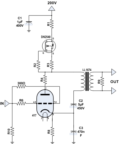

Cool!This schematic will be work perfec with a E88CC(I have some of this-Philips Special Quality with gold pinshoktuna said:This is my preamp i am use and i hope it will drive my sewa.
😎 ).Try with her and say something for the BIG sound😀.
Does the signal get a reduction of 8 times then?Trafo is Lundahl conect backwards 8:1.

It´s a 6c45 CCS stage:
It seems to be working fine through my junkspeakers,the only problem now is that i found out (Thanks Fuling)the supply for the tubes are a bit weak.I can use 15ma/tube but if I go higher I only get hum,will order a bigger trafo wich I use backwards on the SEWA supply,and try it out on my better speakers.
cheers.😉
cheers.😉
It's not a power supply is weak, it's a emitter follower you are using instead of CCS shunts your output.
Ryssen said:Maybee I should add that B+ dropps from 220v to about 150v under load,30mA..🙄
What is a voltage on a power supply when you get 120V on plates of your triodes? What is the current through tubes?
Well there is about 140v at the plates and 15mA throug the tube,cannot go higher,then comes the hum and the Leds fade out.
Ryssen said:Well there is about 140v at the plates and 15mA throug the tube,cannot go higher,then comes the hum and the Leds fade out.
And what is the voltage on the power supply at this time?
It seems to be something like 145V, right?
Ryssen said:Yes, 145-148v I think,and the Leds draw about 20-25mA to.
Ok, now - what voltage swing do you need for your power stage?
Connect sine source to input of your amp and slowly decrease a current until you get your needed swing on output without clipping.
