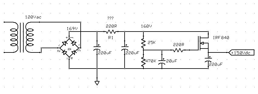

BOSOZ PSU for 150Vdc?

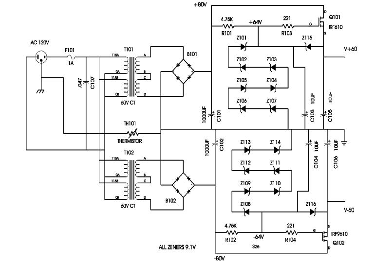

Here is the original BOSOZ PSU.
Of course I would use only the + half of the PSU with 7x22V Zeners to get 154V. Allowing for the
approximately 3.7 volt loss from MOSFET Gate to Source pins the
output of Q101 would be 150 volts DC.
What do you think??
What do you think??

I would think that it should work fine. Obviously check that the MOSFET is working in its safe operating area.

I would use IRF630 or 640.

Your circuit makes a good variable power resistor, but there's nothing to "regulate stiff" the voltage. If your source voltage is steady, no worries. If it varies say 10% around dinnertime because everyone turns on an oven, you need a zener reference for the gate.
In a tube forum, I'm surprised no one suggested a VR150 😕

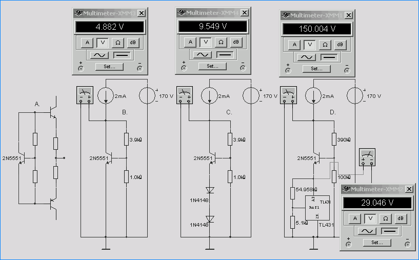

It is useful to have a good high voltage regulator
in tube circuit, not at least.
My idea for a high precision and low noise is My Attachment.
It uses the Vbe multiplier, we can see in most any solid state power amp.
I guess we all have seen the set up in my figure A.
The volt across the lower resistor, 1k in my figures,
is multiplied by the upper resistor.
In figure B. the Voltage base-emitter is multiplied with x~4.9. ( {3.9+1} / 1 )
In figure C. I have raised the voltage across the 1k resistor
by adding 2 diodes to emitter.
The result gives also a higher output at top of this transistor shunt diode.
Such a voltage mutliplier works the same way as a Zener Diode,
but the good things are several.
- Adjustable, with resistors
- Lower noise
In figure D. finally is my idea.
Using the TL431, an adjustable shunt diode IC, with
- rather low noise
- good temperature stabilty
- possible output voltage can be set 2.5 - 36 Volt
This TL431 is in my circuit set to ~ 30 Volt
and this is multiplied by ~ 5.
And so we have 'zener diode circuit' at 150.0 Volt, with good quality output.
The voltage across TL431 = 30 ( max 36V )
The voltage across transistor 2N5551 = 120 ( max 160V )
It is all within the components max margin.

I see you both, Tyimo & Geek does not like my idea
Well, suit yourselves
There are other here, that understands the benefits and will use my great idea ....
There are 2 kinds of regulators, basically: Series and Parallel
Nelson Pass and others using Zeners + 1 Pass transistor, for increase current
are into Parallel Regulation.
Myself also prefers Parallel Regulation, using shunt diodes or zeners, if possible.
This is what my circuit is about.
To try to make as perfect constant high voltage as possible
with excellent precision and quality.
Another reason is: I avoid using ZENER DIODES in any audio circuit.
We do not need to. There are good alternatives around.
Zeners ARE NOISY in compare.
And they have Not very good temperature stability.
The Geek diagram is not bad, but is a Series Regulator.
And it uses ZENER diode, 82Volt.
This is why I wouldn't use it.
Not for 10-20 mA!
And when current is fairly constant.
In these cases parallel regulators will do very good.
Regards

Could you tell me how much is the exact mA what your SEWA preamp would need???? 8mA/channel?
Tyimo
Personally, I'd use this:
http://geek.scorpiorising.ca/Geek-0.html
Yes, I saw it already on your page.
Only because i have the parts kicking around and it's a workhorse.
Like me , with the BOSOZ PSU boards and parts...😀
Tyimo
Hi Tyimo,
I think it was closer to 3 or 4 mA/channel. Not much at all.
