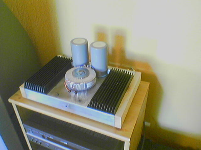

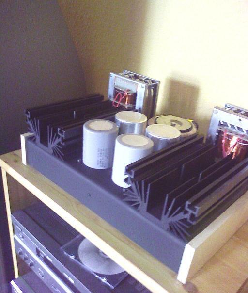

Tyimo said:Here is my choke loaded 30W amp:
P.S.How can I put more picture in one post?!?
Thanks very much, Tyimo.
You are a true friend.
Nice pictures. I have a look at svhematic and download it now.
See you
You are wellcome anytime my friend!🙂Thanks very much, Tyimo.
Unfortunately, not. Made by a mobil phone cam. I will try to make a better one.Nice pictures.
Tyimo

Hi Geek!
My first pics is the original SEWA with CCS and 30Vdc.
The heatshinks are ca. 50C., but my whole case is made from 5mm aluminium. So the case itself a big heatsinks.
Do you have some oscillations??
Tyimo
Tyimo
