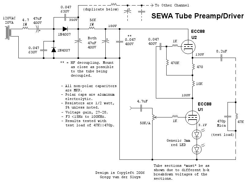

Tube Preamp for SEWA noise problems
Hi!
I built the Tub Preamp for SEWA (designed by Geek, thanks!) and I have some strange noise problem.
When I use the tubepre with the SEWA I have a noise and when I turn on the CDplayer the noise getting louder 2-3 times.
It is not a "hummm". It is something like "brizzzz" noise around couple of hundred Hz.
I tryed the tubpre with another DIY and commercial amps and most of time there was not noise!
So, here is the test:
-With SEWA: high, unacceptable noise.
-With Zen Lite: very little noise, acceptable level.
-With Aleph5. very little noise, acceptable level.
Every power amp has metal case and grounding connections with the case and the mains safety earth. Like in the attached image. RCAs and Outputs are insulated.
My pramp has also insulated in and outputs and no earthing and grunding to case.
I tryed to ground the preamp with: PSU negative rail to case via 1Meg resistor bridged with a 0.047uF film cap, but the result was the same. With the SEWA even worse!
In the test I used the same components and cables and wall connector.
-I tryed the SEWA without the mains safety earth connection, but the noise was still there!!
-In another system with ZV9: totaly-deadly quiet!! This amp is not earthed and has wooden case.
-With a commercial Pioneer amp also deadly quiet! It is not earthed too.
-With another ZV9 in metal case and earthed was noise again!
So, I don't know what could be the problem.
Basically my SEWA is working perfect with SS preamps like BOZ and BOSOZ.
I am affraid that the problem is in (or with) my SEWA amp. May be some impedance problems or oscillation??
I will try to remove the grunding connection between the case in the SEWA.
Need I use the 50K input pot? I use the output pot in my CDplayer.
Need I use the 2.2uF input cap??
BTW: The tube preamp has superb sound! It can easy drive the mosfet amps. Except my SEWA!!
Greets:
Tyimo

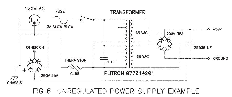

It sounds to me as if you have a ground loop between the preamp and the SEWA. Grounds loops tend to sound much more complex than simple power supply hum and quite often have a rooshing - pulsing component. This probably is going back through the mains leads.
Have you tried back to back diodes with a 0.47uf cap and 100R resistor, all in parallel, between your circuit ground and the mains earths. Try this in both the preamp and poweramp.
Shoog

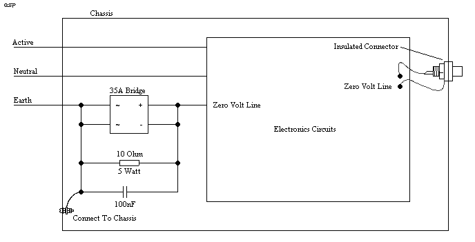

Try a resistor of say 10 ohm between case and PSU ground.What about to connect only the metal case to the mains safety earth, without the PSU gund??

Here is the tubepreamp. I built without the input cap and the volume pot.
Tyimo

Heureka!!! I found it!!!!😀
After a crazy half day testing I found the best grounding-earthing variation!!! I tried more than 16 variation of grunding and the last was the good.
In tubepre the input RCAs are connected to the case and the case to the mains safety earth.
In the SEWA the PSU grund was connected via diode bridge to the case and to the mains safety earth.
I tried to connect the tubepre input RCAs via 10R+220nF to the case, but it was not better the without it.
So, now the noise is on acceptable level. Not the very best but good.
I am very happy and enjoy to listening music on the Geek's Tubepre-SEWA combo!!
However I didn't understand why I had this grunding problem, because until now I built more then a dozen amps and preamps and never had anyproblem with them!
Now only one question:
I was re-reading all my articles about earthing and I found something mistakable thing with the diode bridge coupling.
Mr. Pass wrote:
As it is in the attached image.Note in Figure 6 that we have chosen to isolate
the two channels through a rectifier bridge to ground, with each
channel’s ground appearing on one of the AC legs of the bridge.
Mr. Rod Elliot wrote:
He use the DC legs of the bridge to connect to the circuit!!!!!Note the way the bridge is wired, with the two AC terminals shorted, and the two DC terminals shorted. Other connection possibilities are dangerous, and must be avoided.
As it is in the next attached image.
So, Who has true?????????????????????????????
Maybe I should change my psu grunding in my SEWA like Rod Elliot says?
And one more info: Geek's tubepreamp is so nice sounding.......😎
Thanks Geek!
