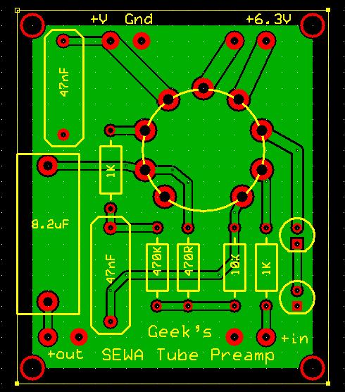

Hi Tymo,
Looks OK except if the view is from the top, the sections are backwards (dead tube on power up) and pin 9 should be grounded.
ECC88:
U1 = 6, 7, 8 - AGK
U2 = 1, 2, 3 - AGK
The Vh-k are different on the sections... 50V for U1 and 150V for U2.

Hi Geek!
Thanks for the infos!
I thought the opposite! U1=1,2,3....
Where can I read about the correct tubesections? Ther is no info in my tube data sheets.
I have to redesign the PCB.
Greets:
Tyimo

Hi Tyimo,
No problem 🙂
I've double checked my books and pdf's, that schematic is in error... in that circuit, it's not critical anyway.
Here's an online pinout where you don't have to download a pdf:
http://www.r-type.org/exhib/aaa0281.htm
IIRC, there is one double triode with section one, being the low numbered pins, but it slips my mind right now as to the number.
Cheers!
Thanks Geek!
I see.
Tyimo

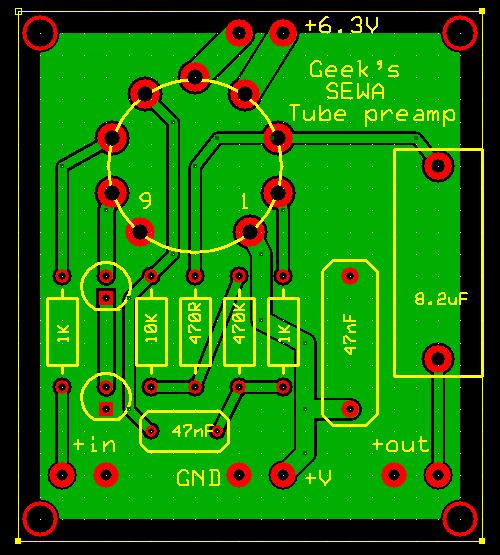

Hi Tyimo,
Looks better 🙂
Nah, you only need one. I like big caps, but if you already have the 1uF or can't budget for the bigger one, no problem. As long as it can handle the peak DC voltage + AC.
P.S. Can I get a couple boards from you? 😀
Tyimo said:Here is the corrected PCB plan. I hope now everything are O.K.🙂
Looks better 🙂
One more question: if I have in the SEWA an 1uF inputcap, than need I use the 8.2uF output cap in your preamp too?
Hi Geek!
Thanks for the helps!
Yes!🙂 Send me your address and when I will be ready (in couple of weeks)I will send you.
Greets:
Tyimo
