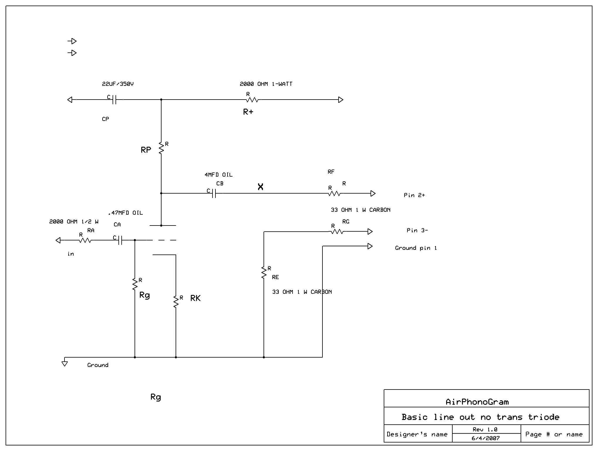

Some notes and a couple drawings
I have a hard time posting as way too much to do, but I dragged up some notes on tests I did, a lot of tests, on various triodes as the basic 15K primary/600 ohm Altec "Red" 15905, classic style line out trans for tube stage.
I tested, 12au7, (single triode) 6sn7, #37, #76, 6fq7/6cg7, and 6gu7
I also tested two triodes in parallel, mu stage etc..
Using this drawing "Basic Line out 15K/600 ohm triode
The plate resistor seemd to like being 15k no matter what, and that had a lot to do with matching transformer impedance. If you are direct coupling the plate, then pin2+, RF, couples to CB, and the carbon resistors help to smooth out the sonics, and add some neg feedback/stability
Rg = 300 k, as overall good value for most power triodes
The surprise tube was 6gu7 as it had about 15% more out clean than any other tube.

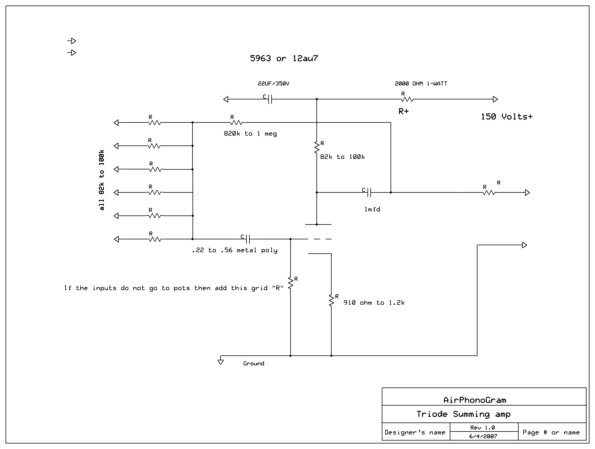

For a 5751 or 12ax7, summing amp, 100k summing resistors, 1meg neg feedback from plate to grid, 1K cathode resistor, 82k to 100k plate, 150 volts B+
Look at the Summing_amp_triode pic

Look at the drawing, Line_out_triode_no_trans
Again, one 6gu7, with both triode in parallel, will give you the most power out, and very warm, smooth tone, not too much fill power

I am puzzled by your summing amplifier based on a single 12AU7. This has insufficient open loop gain to produce anything resembling the virtual earth of a true NFB summer and its performance will be little different to that of passive summing network.

I think the summing amp ended up with a 12ax7 or a 5751.
I make several drawings before building, then build, test, then a final drawing or mark over the current one. One drawing is marked 5963, I got a pile of those, quality 12au7 tubes, and a later drawing is marked 5751.
As far as gain and all that, again, I just build and test with Mr. Scope, and Mr. oscillator. The in resistors in this circuit go to the center taps on the filter pots, so the resistance to ground is varied with the pot.
I detected no or almost zero interaction between inputs.
Increasing the negative feedback to zero out the junction where the feedback meets the input, will zero interaction.

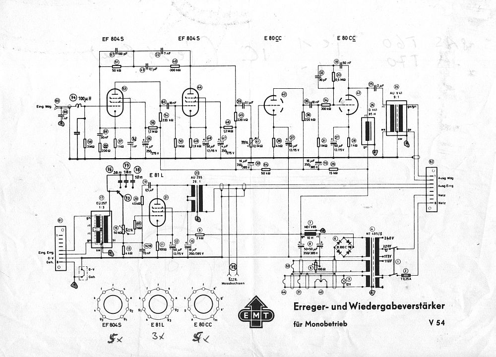

Here is a schematic of the preamp for a EMT plate reverb
It uses two EF86 pentodes in series, as the pre stage, and some dual triode, maybe similar to a 12au7 as line driver.
There is also, at the bottom, a single pentode gain stage.
The two at the top, are surronded by positive and negative feedback from the second tube to the first. Older circuits like these used Neg feedback to control the bad effects tubes had, and also noise.
So, I am saying that while I have seen talk about partion noise on the forums, having worked with complex pentode circuits like these, I know that they had acres of gain, usual around 80DB, and super quiet.

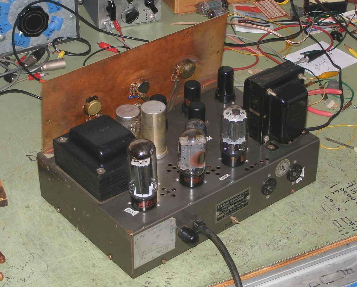

Here is a old Stromberg "PA" amp. They made lots of PA and other amps. This one has three 6sj7 pentodes as pre stages, mixed to a buffer, then EQ, then, the power amp.
The gain on these amps, (if you re-store them) is pretty high, more than the usual triodes, and with very low noise. Most PA amps used 6j7, then 6sj7 tubes, before the
5879 came out.
The preamps that I have built with 1940's 39/44 pentodes, with a triode second stage/buffer, at about 12DB gain, can give more than 60DB gain total, and very quiet.

A 12AX7 would have a much better chance of creating a true summer due to its higher mu. I am not surprised you detected no interaction between the controls. Even with passive mixing there is very little interaction.
The trouble with trying to make a true NFB summer with tubes is getting enough open loop gain. With only ten inputs, as in Antonio's mixer, and aiming only for unity gain overall, you need 20dB open loop gain just to make the virtual earth the same as it would be with a passive mixer. To get it 10 times better ( a modest target) you need another 20dB or 40dB in total. There are several ways you might achieve this,
1. Pentode - and EF86 can do this without too much trouble but it has a hard job driving a load plus the NFB network. Adding a direct coupled cathode follower to drive the load and NFB network works quite well.
2. 12AX7 mu follower. A single 12AX7 will get you about 36dB open loop gain taking account of NFB network load but will not drive any real load. A 12AX7 mu follower gets you nearly the full 100 mu (40dB) open loop and a nice low output impedance too. This seems to work well with up to 10 inputs.
3. 12AX7 cascode. This can produce 45dB or more open loop gain. It does suffer from poor distortion but the NFB helps that a lot.
Fixed gain twin pentode pres with NFB were common many years ago (V72 for example). I see NFB in the circuit you posted but no positive feedback. Could you please point that out for me?
As I mentioned before, NFB does not improve signal to noise ratio.
The twin pentode designs do not have a reputation for being super quiet. Their noise performance is determined primarily by the large turns ratio transformers they used at the input, often with 30dB of gain. They had to use such a high turns ratio because of the poor noise performance of pentodes. All the later professional mixer designs like RCA and Universal Audio used triodes for their lower noise.
