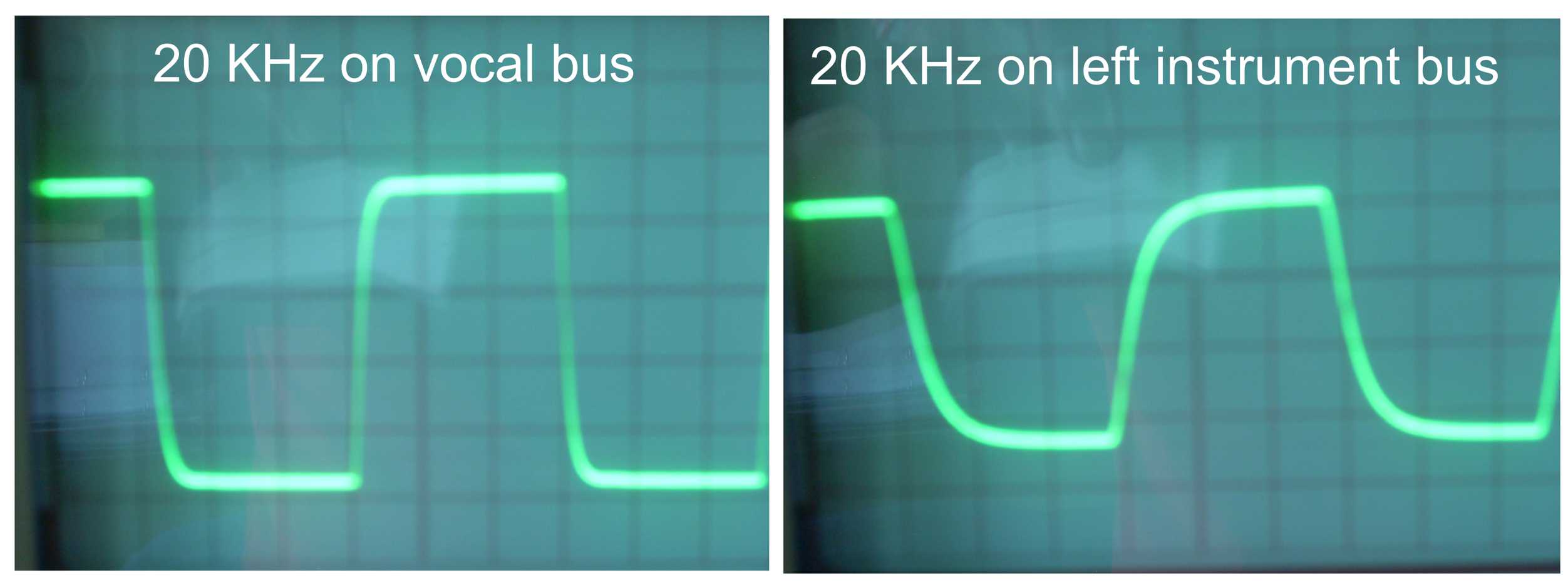

Ian,
now that all seems to be ok… it remains to project the last stage (output buffer stage).
Before it, two little questions:
1) Which are the 5K load you refer in the post n.150?
2) Why below the 200Hz the tone control of bass becomes asymmetric? ...and how could it be eliminated ?
As to the output stage …
- I remember you that the mixer section is a passive one (see schematic)… and according to your calculation it should produce a loss of 20 dB.
- Due to the dual gang-pot and the realtive 47K on its wiper ... when that potentiometer is in the middle position, we have (in the worst conditions ... i.e. 10 mV after the input transf and tone control switched-on) 850 mV output on the left and right instrument bus versus 1091 mV on the remaining two buses (vocal and bass)...about 2 dB loss!
- The subsequent SRRP stage has a gain of 23 dB (or more).
- The output stage should drive cables that can also be 20-30 mt long.
1) Do you have some suggestion for the output stage?
2) How to solve the problem of different signal levels on the buses?
Ciao
Antonio e Francesco

I analyzed the signal output on the bus and I found that it is altered on the left and right instrument buses compared with the remaining two buses (vocal and buss).
See the enclosed picture ... the square wave at 20KHz is very beautiful on the bass and vocal buses while it is deformed on the right-left instrument buses.
Is it normal?

Ian,
Is it normal?
Antonio
Yes, it is normal. It indicates a high frequency roll off, probably in the region of 60KHz. I have attached a paper that describes the various effects of frequency response upon a square wave.
Cheers
Ian
