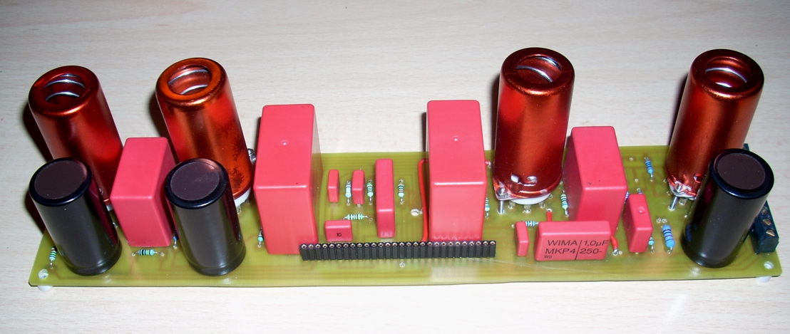

Ian,
after a (relatively) long time, we are returned to the mixer project.
We are now ready for the first step. We should realize the PCB and then to test the first prototype. Before the PCB realization we’d like to carry out a final check. We included the revised schematics. In particular, 5 specific questions would like to submit.
1) We have added a 300 ohm resistor on the grid of V5, V6, V7, V8 tubes in the bus-mixer section. Is it correct?
2) Could you verify if the section “a“ of TL082 is correct ? … are there any problem to drive the 4 lines ?
3) As to the anodic power supply … is the preliminary schematic correct ? Specifically, C1-L1-C2 will be included into the power supply section (located far from the preamplifier sections); while, the nets R1-C3, R2-C4, R3-C5, … will be located on the preamplifier-mixing boards, near the tubes. Is the double pi greek filter (C1-L1-C2-R1-C3 ... C1-L1-C2-R2-C4 ... ) adequate for a good anodic supply?
4) As to the top panel of the cabinet (where to mount the knobs, switches, faders, etc) … we have not yet decided which solution to adopt. The choice is between plastic and metal panel. Which solution is the best in your opinion ?
5) As to the connections between the preamplifier boards and the top panel we have organized the connections in the following mode:
- 1-way -> 1 wire-coaxial cable (with the wire gauze connected to the ground)
- 2-way -> 2 wires coaxial cable (with the wire gauze connected to the ground)
- 3-way -> 3 wires coaxial cable (with the wire gauze connected to the ground).
All earth returns (negative) are performed by a dedicated wire of coaxial cables (and not through the gauze). Is it correct?

Ian,
That is a wise precaution. Make sure the resistor is as close as possible to the grid pin of the tube.
The total load might be a potential problem for TL062. Your worst case load is four 10K pots in parallel with four 10K resistors i.e. 1K25. The data sheet seems to imply the TL082 will drive loads lower than 1K so it should be OK in theory but I have no idea what will happen to the distortion. It might be better to increase the pots and resistors to 22K thereby making the worst case load 2K. With this load, the output capacitor C15 has a low frequency 3dB point of about 6Hz. It might be worth increasing C15 to 47uF.
Keeping the smoothing inductor well away from the preamps and the placing the local decoupling at the preamps themselves is a good idea. I have never used a C-L-C filter in a preamp power supply so I cannot say if it will be good enough.
Metal definitely and preferably aluminium. You can get very professional looking panels made by Schaeffer in Germany:
Front Panel Designer*- Schaeffer AG - Frontplatten, Front Panels, Faces Avant
That is correct. In most cases you should aim for no signal current to flow in the screen (gauze).
Cheers
Ian

We took a long time but we have (finally) realized the first board (see the enclosed photo).
We have not yet tested it because we have some indecision about the heater power supply. We’d be very grateful if you could read our considerations and the solutions proposed. In any case, if a better solution exists, please don’t esitate to ignore our suggestions.
Considerations:
1) In order to reduce hum, AC heater supply should be avoided.
2) A soft start circuit should be implemented in order to avoid stressing conditions to the tubes in the first seconds after switching on.
3) Each cannel includes 4 E88CC tubes. We believe that it should be a good thing to have a power supply that, in the case a filament of a tube is broken, the entire channel should be disconnected (in order to avoid damage to the tubes due to the anodic power supply).
4) The cathode-filament voltage of each section of E88CC must not exceed the limit of Vkf reported in the data-sheet of the tube (http://www.mif.pg.gda.pl/homepages/frank/sheets/163/e/E88CC.pdf).
Possible solutions:
1) DC heater supply seems to be the more appropriate solution. In this view, non-stabilized power supply seems to be less advantageous because it imposes the adoption of a specific voltage for the transformer. Conversely, a stabilized DC supply allows to utilize a wide range of transformers (and we could have some). Could a series (6.3 x 4 = 25.2 V) stabilized (e.g. LM 317) heater supply be suitable?
2) If a stabilized DC heater supply results to be (in your opinion) a good solution … Could a LM317 with a transistor (on the adj pin) do the work? For example … adding the following solution (Soft Start Power Supply with IC LM317 and L200 | Circuit Project Electronic ) in a general LM317 high current power supply circuit like this (10A 1-30V Variable Power Supply with LM317 ).
3) If the consideration made is correct … could you suggest a simple circuit (that we should multiply by 10 …channels) doing what requested ?
4) According to the data-sheet, the Vk+/f- is 120 V and the Vk-/f+ is 60 volt. In our case, with 250 VRMS of anodic supply we should have about 120 V on the cathode of the top section and 4 volt on the cathode of the bottom section of the tube. So, the DC elevation of negative heater supply seems to be not necessary (120-25.5 = 94.5V; 4-25.4=-21.5). Is it correct?
Hi Antonio (& son),
Good to hear from you again. That is a good looking PCB. Well done.
Answers to your questions:
1. I agree a dc heater supply is best.
2. A soft start for the heater supply is not normally necessary. However, if you use semiconductor rectifiers for the HT then this supply could be up before the heaters have fully heated and this could lead to potentially damaging voltages on the tubes. So it you need a soft start supply it would be for the HT and not the heaters.
3. I am not sure this achieves what you want because all the tubes will have no heaters but they will still have full HT. I would suggest you supply the heaters to the tubes in pairs at 12V then if one tube fail at most one other tube is at risk. probably the simplest way to do this is with a 7812 regulator for each board.
4. Your Vkf calculations need to include the signal. If the largest signal is 20V rms then this can increase the 120V cathode voltage by nearly 30V to say 150V.
Cheers
