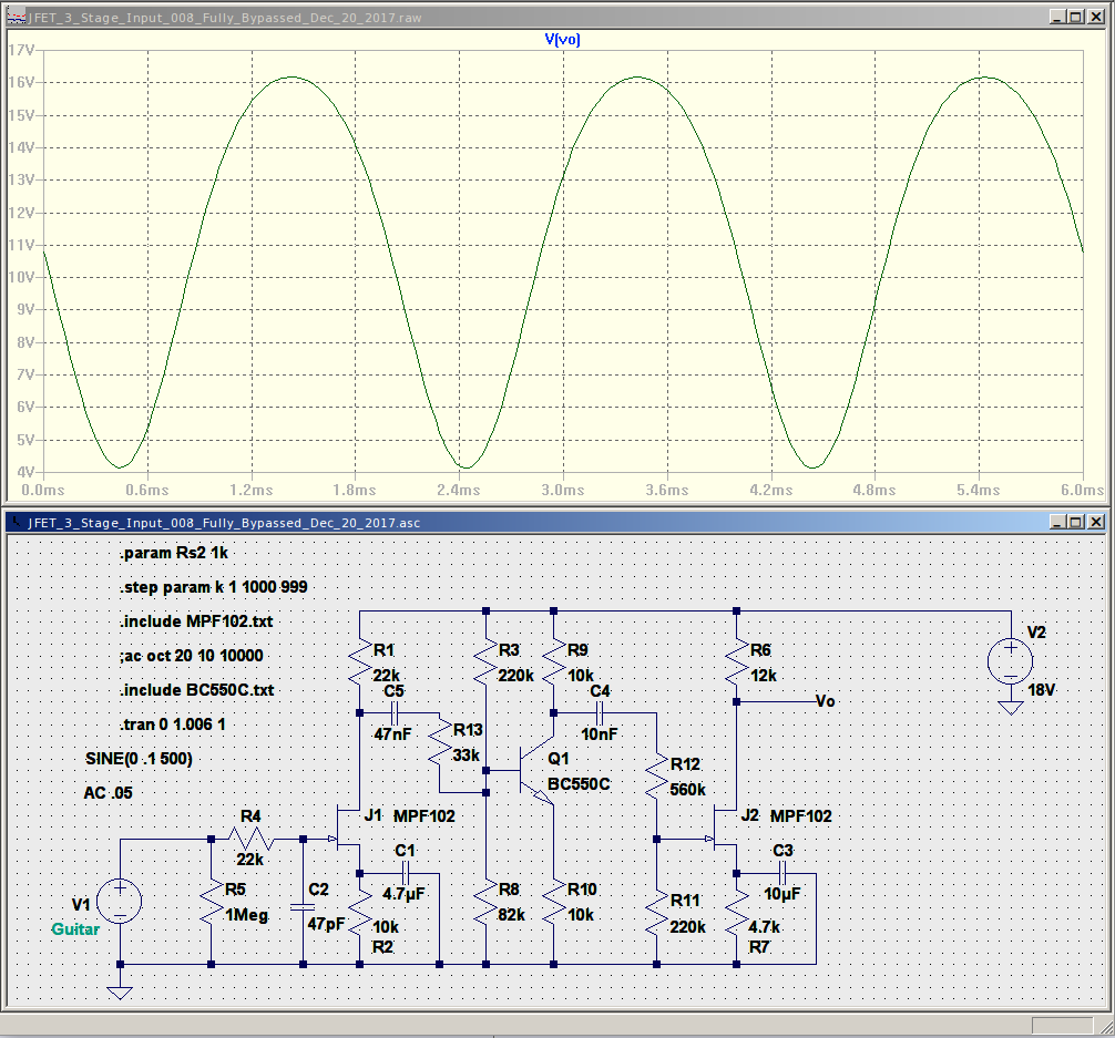

The mystery circuit didn't work the way the LTSpice simulation predicted, so no go there. But a closely related circuit idea did work, kinda.

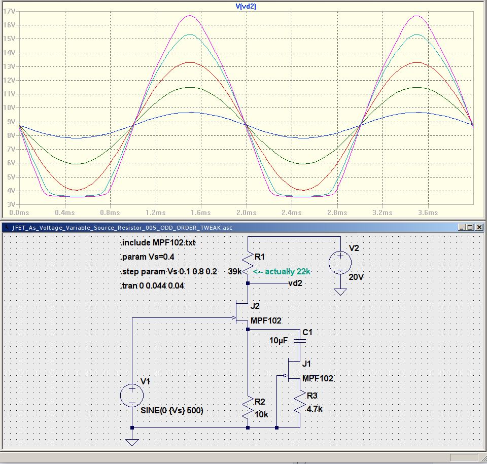

My idea was to use the channel resistance of one JFET as a nonlinear source resistance for a second JFET wired as a common-source amplifying stage. The initial idea was to have everything DC coupled, and this circuit simulated well on LTSpice, but behaved like a class C stage on the breadboard. Not what I was after.
AC coupling the nonlinear resistor (JFET channel) so as to bypass a fixed source resistor did work, though. The circuit produces clean amplification for small input signals, then begins to smoothly round off negative half-cycles when driven harder.
I put together an input JFET gain stage on the breadboard as before (see post #33 of this thread, 10k source resistor, 47k drain resistor). The output of that first stage was AC coupled to the nonlinear twin-JFET circuit in the attached schematic, and that in turn fed the class D power amp module.
With the same twin-humbucker guitar plugged in as before, clean tones were available with the volume knob on the guitar turned slightly down, moving into a slight growl with the guitar turned fully up. With cap values not optimized yet, the growl was on the muddy side. But there was no harshness to it, so I think it holds promise for a little subtle overdrive.
I also tried switching the JFET in parallel with the fixed resistor (J1) completely out of circuit, leaving me with just two cascaded JFET gain stages, both with unbypassed 10k source resistors. This produced clean tone at all guitar volume settings, but it was a warm clean, without the harshness I usually hear from an accurate op-amp stage.
If I may borrow mjd_tech's word one more time, I still have not managed to get "gling" out of my JFETs. But at least I got some usable growl.
I have another mad circuit idea in my head now in the ongoing (and so far, futile) quest for JFET "gling". I'll see if I can get that idea onto a breadboard soon.
Meantime, here's the circuit that I've been talking about in this post. It may be worth wiring an SPST switch in series with J1's drain, so the additional nonlinearity can be switched in or out at will.
Oh yeah, for the particular MPF102 I used for J2, it was necessary to use a 22k drain resistor to get the drain to bias up to about 9 V DC (running on 17.7 V DC from two 9V batteries in series). LTSpice thinks 39k is the proper value to use. JFET parameter spreads strike again.
One final point, the "de-nastification filter" was not used today at all. I figure there's no point until I finish the new ported cab, and know exactly what the whole thing sounds like.
So far my ears are telling me that even one JFET gain stage in the preamp signal chain considerably reduces the amount of nastiness I hear. I still don't know exactly why, but my working hypothesis is that the JFET nonlinearity is doing something to squash the big initial transient at the start of each picked guitar note.

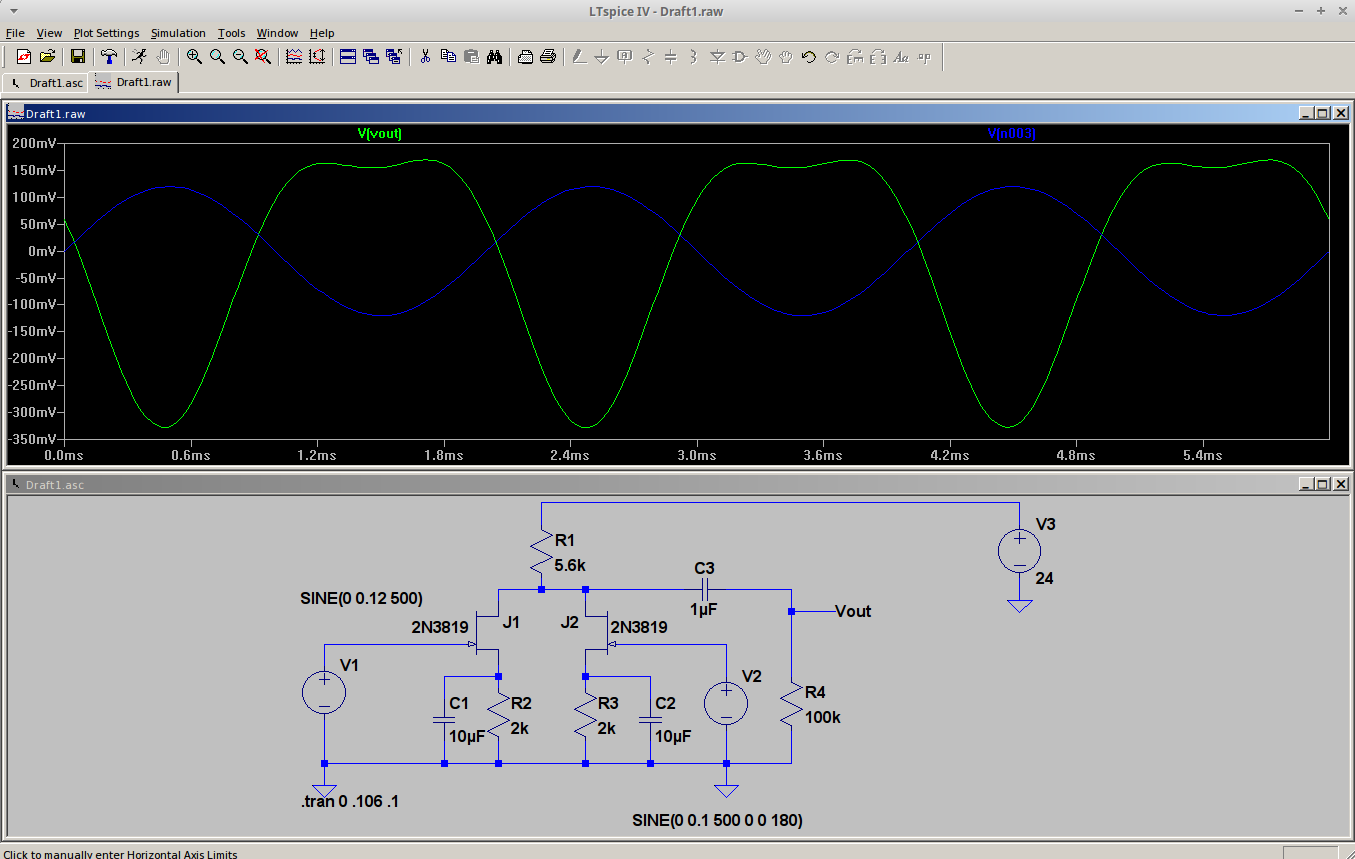

Other than that, the only progress I have to show is the circuit idea I came up with. A screenshot of the LTSpice simulation is attached.
The idea is to parallel two JFETs, bias them to equal quiescent currents, and then drive the two gates with equal amplitude, opposite phase signals. Which sounds like lunacy, because if JFETs were linear, this would cause the AC component of the two drain currents to cancel each other.
However, JFETs are not linear. There is also a quadratic component, and the square of (x) has the same sign as the square of (-x). This means that any second harmonic component in the individual drain currents will be in phase, and will add up rather than cancel. Meantime, the components at the fundamental frequency will have opposite phases, and will cancel.
The same cancellation/ addition idea should apply to other odd and even harmonics - all odd harmonics will cancel out, all even harmonics will add up.
Basically, it's the opposite of the push-pull output stage design we all know well. I think a good name for this circuit would be "push-push".
The concept seems to work in LTSpice - you get a frequency doubled output (and gain below unity) if both inputs are equal amplitude.
For guitar purposes I don't want the fundamental to cancel out, rather, I just want to be able to enhance the amount of second (and other even order) harmonic distortion. Which should be easy to do simply by dialing one of the two antiphase signals down in amplitude.
Something like a cathodyne ("sourceodyne?") can provide the two antiphase signals, of course.
I'm attaching the LTSpice simulation file (.asc) as well as the screenshot, in case anyone else wants to tinker with the circuit.
Will this circuit finally bring the ever-elusive "gling" to an entirely solid-state preamp? Or fail like all my previous attempts? I guess I'll find out soon!

On the preamp electronics front, the easiest next thing to try is bypassing the source resistors in the two JFETs (the one in the input stage, and the one in the de-nastifying filter.) If I put the (inverting) tone control in between, that will encourage even harmonic distortion (the 2nd JFET will be driven by a waveform that has taller positive-going half cycles, encouraging it to produce even taller negative-going half cycles.)
I tested the concept quickly in LTSpice today (using a generic BJT phase inverter because I did this during my lunch break at work, and didn't have my tone control schematic handy). It looks like maybe 10% 2nd harmonic distortion can be coaxed out of the circuit just before it clips, and that should be enough to produce some audible effects. The waveform is not unlike what I got from a small-signal pentode (6AG5) during some earlier guitar preamp experiments, and that preamp had very nice shimmery clean tones.
The 3rd harmonic is still a full 40 dB down in the simulation, probably too low to be audible in a guitar amp. I don't know how close to reality the simulation is, though.
-Gnobuddy
