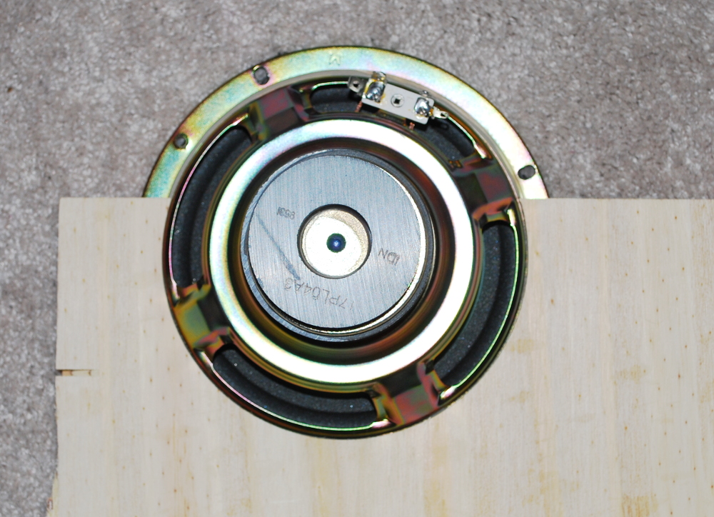

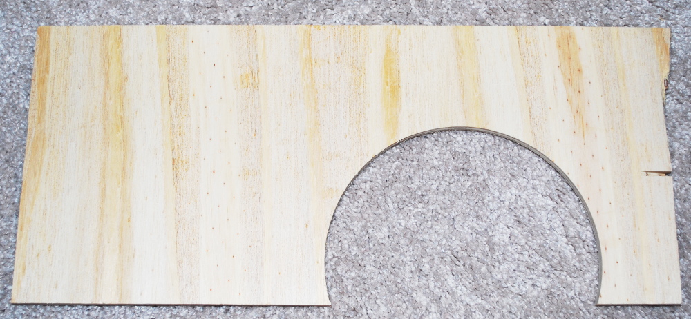

I made a simple little plywood jig tonight that lets me cut circles with a little palm-size router and a 1/4" two-flute router bit. After that there was just enough time to make a test cutout in a piece of scrap ply before I had to clean up and vacate the wood-shop.
I'm happy with the test cutout - it fits the (front-mounting) speaker well, and the router produced a pretty clean cut in the ply. I couldn't do as good a job with a jig-saw, at least, not without lots of sanding after the fact.

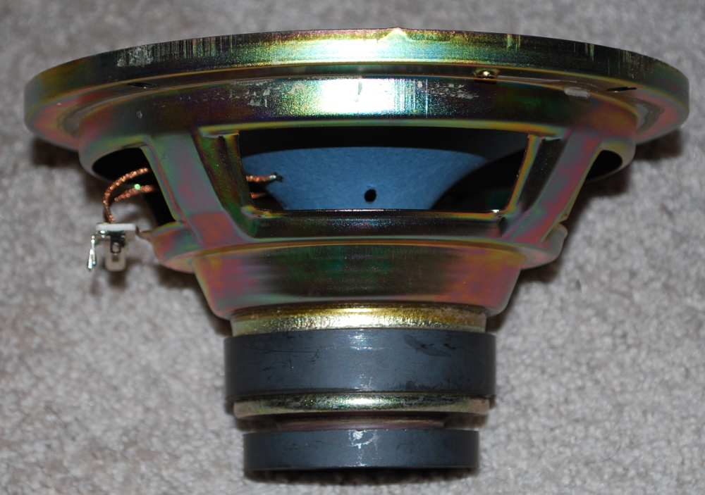

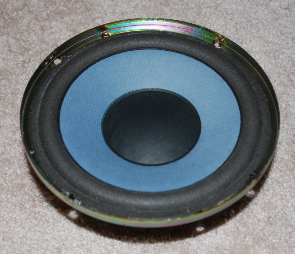

I figured it's about time this thread had a few more pictures in it, so here we go. The woofer (6.5" outer diameter), complete with a field-canceling magnet for use near a CRT TV or computer monitor, the test cutout, the speaker placed into the test cutout.
-Gnobuddy

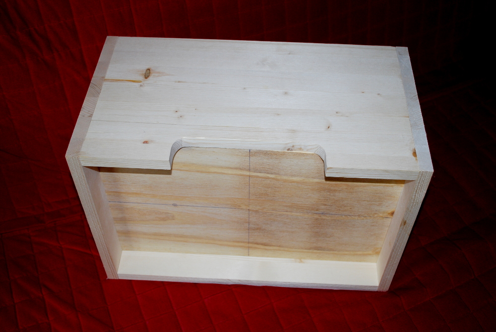

I spent three hours in the wood-shop after I got home from work tonight, and have the plywood baffle mostly done, though I still have to cut two 3" diameter holes for the port tubes. I also bought a few bits and pieces (screws, a drawer-pull to serve as a handle, stuff like that).
I still haven't had time to test the circuit idea I came up with a few days ago. I'm slow at wood-working, and building this cab is taking a lot of time. Hopefully I will start gluing stuff together this weekend.
It's been a long day, and I'm beat, so it's off to bed.
-Gnobuddy

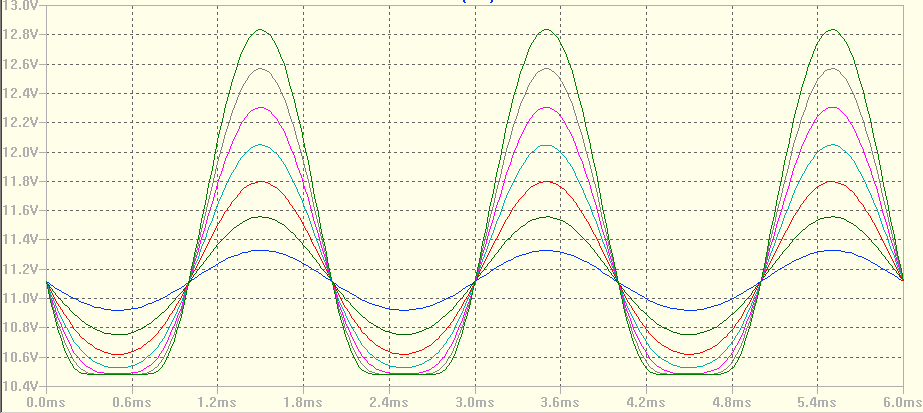

I spent a few more hours in the wood-shop today, and am still not done. But at least I finally got to the point where the first glue joints are setting as I type this. By tomorrow morning, I should have something that's beginning to resemble a cab, rather than a pile of lumber.

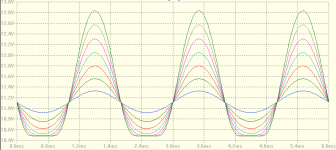

On the electronics front - I've spent all my free time today in the wood-shop, and it's now well afte 1 AM, so once again, no time to build and test my mystery circuit. But, as a teaser, I'm going to attach an LTSpice simulated set of output waveforms.
I have high hopes for this circuit, assuming it behaves at least somewhat like the simulation. Notice how it is quite linear (symmetrical output waveform) at low input levels (dark blue, dark green), begins to gently round off negative half cycles beyond that (orange, cyan, magenta), and finally starts to soft-clip the negative cycles (grey, dark green) when the input is turned up even more.
But even when the negative half cycles are clipped flat on their peaks, the corners of the waveform remain rounded. This should significantly reduce the presence of harsh-sounding very high order harmonics. If the real circuit behaves like the simulation, there shouldn't be much audible harshness to deal with during overdrive.
FFTs of the simulated waveforms are interesting, too - only the second and third harmonics make it to within 30 dB of the fundamental, i.e. only these are likely to be audible with guitar.
Will this circuit turn out to have what mjd_tech calls "gling" and most of us call "tubeyness" or "valveyness"? I'm hoping. Mebbe I'll find out tomorrow, if the curse of the wood-shop doesn't strike again!
This isn't KMG's diode-clipped MOSFET circuit, by the way, but something different that I came up with.

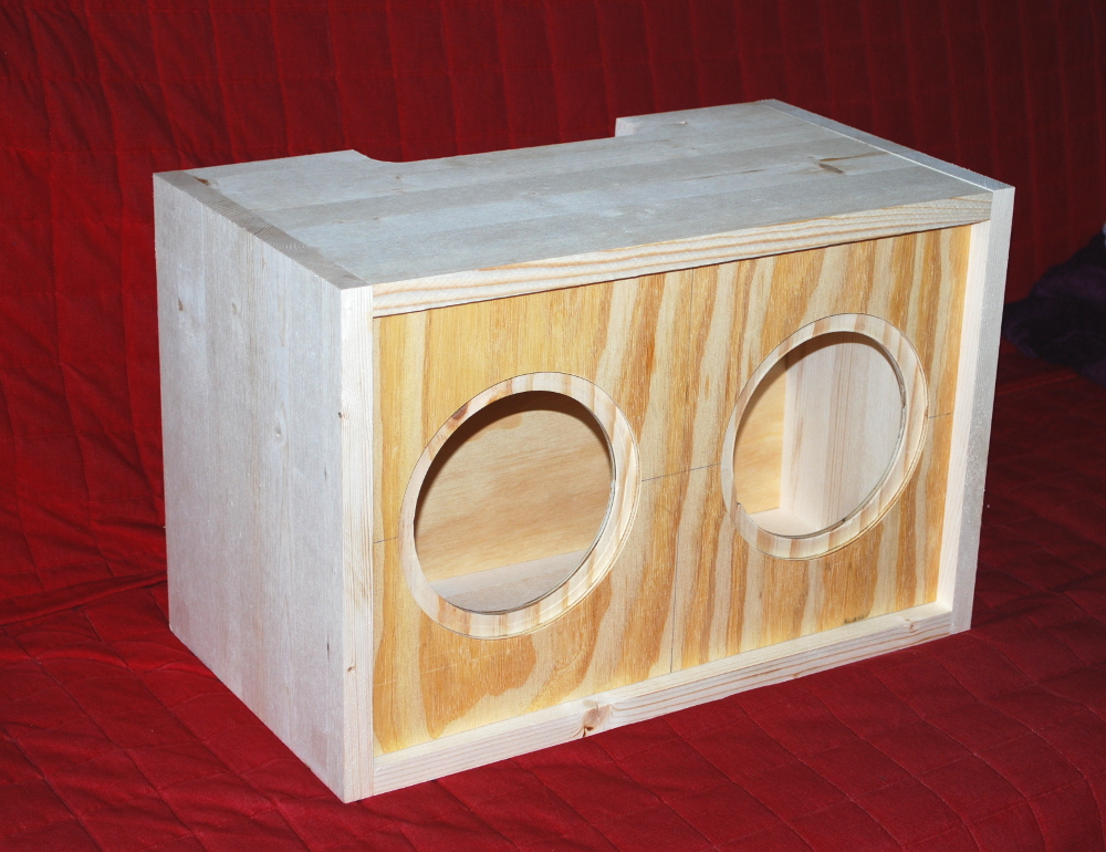

Time has been tight of late, but finally managed to get the 3" circular holes for the port tubes cut, using a borrowed hole-saw and the drill press in our apartment complex's wood-shop.
It looks like there is no longer much interest in this thread, so I probably won't post too frequently here for the immediate future, though I will certainly update things any time I manage to make significant progress.
-Gnobuddy
