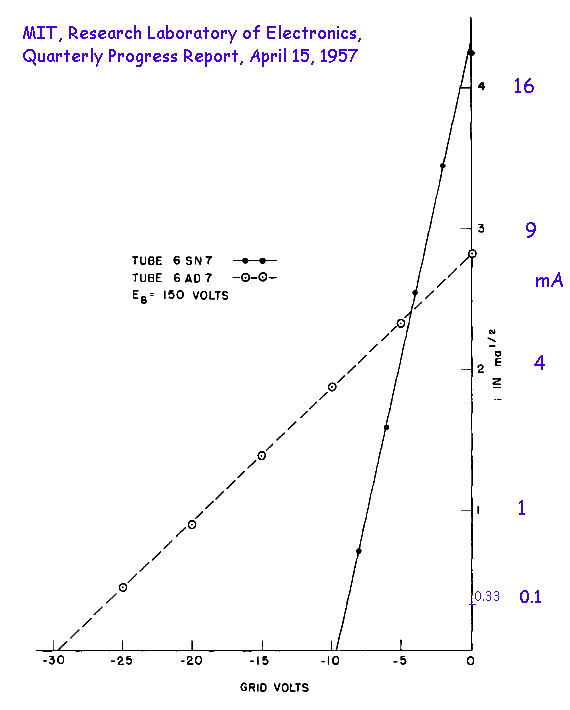

..I read a paper, complete with careful experimental data, that showed that most small signal triode valves in fact closely follow a square-law transfer function (for Vgk v.s. Ia), and not the famous Child-Langmuir "three-halves law"....
Can you cite that? (Take your time...)
I can to a similar conclusion playing with the slim data in tube-books. Be nice to have a leg to stand on.
3/2 is correct for an Infinite Plane space-charge device. We have no infinite devices, and most are far from plane. Anyway a 3/2 law does not get up into high-Gm territory quickly. All real triodes are fudged to mask the effect of finite size (leakage around the core geometry) and to get high Gm, which means departing from 3/2 law.
There's another trend at very-very low currents, far below what we would run at. In fact all our amplifying devices follow the same trends, except the trends in the "normal use" zones are different.
Luckily, I had printed out a copy when I first stumbled across this, so I had the right search terms to re-enter into Google.
Prof W.B. Nottingham et al, "Physical Electronics", year unknown, but the PDF is online. Experimental data and fit lines on page 3. Here we go: https://dspace.mit.edu/bitstream/handle/1721.1/52044/RLE_QPR_045_I.pdf?sequence=1

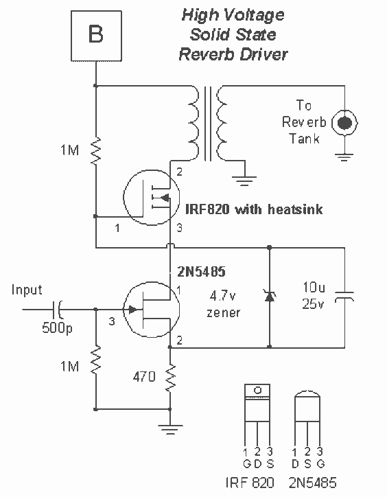

I might try some high voltage experiments with something like the following but replacing the transformer with a 100k and cap output.
I suspect you may need to increase the 470 ohm source resistor to get the 2N5485's drain current low enough to use a 100k drain resistor on the MOSFET. As-is, the drain current in this circuit is probably intended to be considerably higher, in order to have enough current drive to the reverb coil.
Incidentally, I have completely failed to find any 2N5485s for sale. I have managed to scrounge up a few other JFET types, though.
Hey wait a minute, that image looks familiar...
Oh yeah, I'm the guy who posted it...maybe back in the 1990's. Not my original idea, I read about it in some forum or maybe rec.audio.tubes or alt.guitar.amps
2N5485 is roughly similar to 2N5457, which are still available.

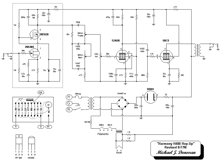

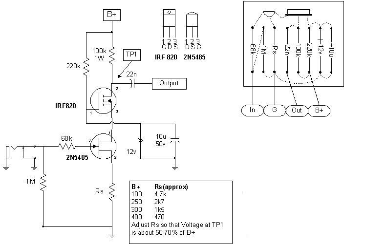

Here's a couple attachments
First one for a regular gain stage. Good for 1st gain stage, reverb recovery, in an existing tube circuit.
The next is an example of actual usage.

Luckily, I had printed out a copy when I first stumbled across this...
:eek: You must have been very stumbly!
Backtracking, the reference is--
Part Of: Massachusetts Institute of Technology, Research Laboratory of Electronics, Quarterly Progress Report, April 15, 1957
Nottingham, W. B.; Greenburg, J.; Ahilea, E.; Campbell, J. F., Jr.; Larrabee, R. D. (Research Laboratory of Electronics (RLE) at the Massachusetts Institute of Technology (MIT), 1957-04-15)
DSpace@MIT: Physical Electronics
Oh you can't back out now with, 'I got it from a friend of a friend', I know who to run to if I have trouble. ;)
-Gnobuddy
It was the only picture of the circuit that I could find. I just assume I will be changing most values.

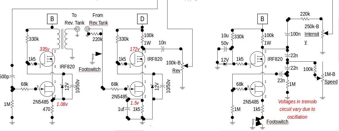

Here's another example, reverb driver, recovery and tremolo.
Some of the symbols are kind of messed up.
Was originally drawn in Visio (pre-Microsoft early 90's version), which I don't have anymore, so using Libre Office Draw to read the file.
Close enough to get the idea.
The "Intensity" control modulates the cathode biased output tubes.
Connect the junction of the usual 220k grid resistors to intensity control instead of ground. Also works with 250k dual ganged post PI master volume.
My favorite way to do tremolo. No expensive photoresistor thingie.
Would probably need a source follower if driving fixed bias output tubes this way, (see Fender Tremolux 5G9).
This Jfet/Mosfet cascode concept was used because I had acquired several "bargain bin" tube amps, Harmony, Valco, Silvertone, etc. and wanted to add some features, but didn't have the "real estate" available to add more tube stages.
The cascode can be wired up on a small piece of perfboard and stuffed into just about anything. Did most of this work around 20 years ago and no problems to this day.
I had tried to use an IRF820 alone as a gain stage, but it didn't work out for some reason, maybe too much Miller capacitance sucking the tone, can't remember exactly.
Nowadays, I would most likely use LND150 for gain stage, reverb recovery, and tremolo oscillator, but still use the cascode for reverb driver due to higher power dissipation, the IRF820 needs a small heatsink, or maybe mount to chassis with mica insulator.
