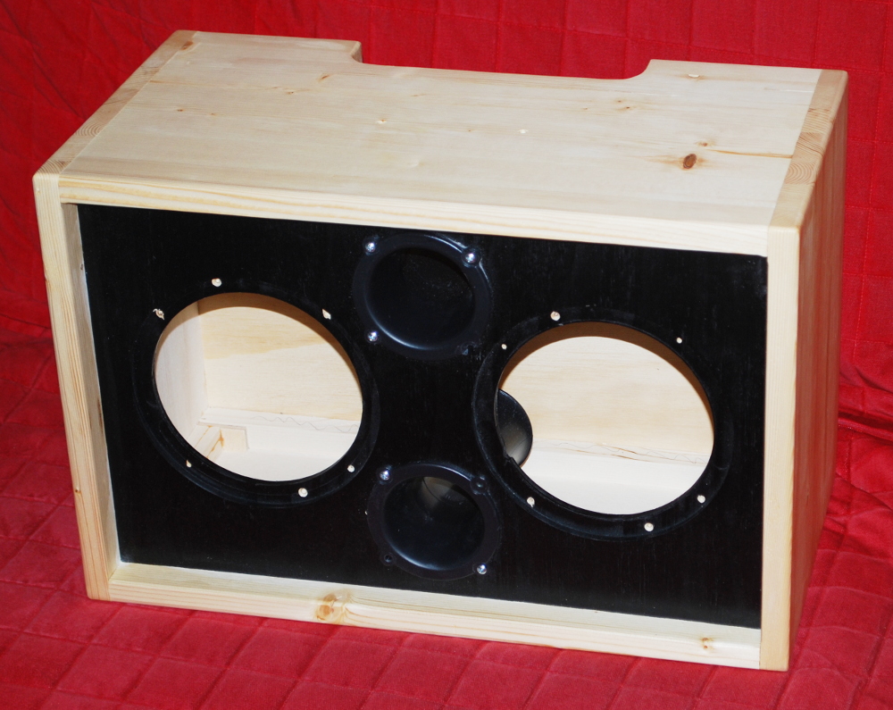

I pulled the cab out of the wood shop where it's been drying. It's got two coats of clear varnish now.
The front panel was spray-painted flat black before glueing in, so it doesn't show through the grille. (Edges were not painted, so the glue can do its thing.)
The odd black shape you see through one speaker opening is one of the two black plastic port tubes.
The back panel you see in this photo is inset about 2" from the rear edge of the cab. It isn't glued in place yet, but will be soon, once I mount the speakers and attach the handle.
There is about a 2" space behind the back panel, where the electronics will live.
