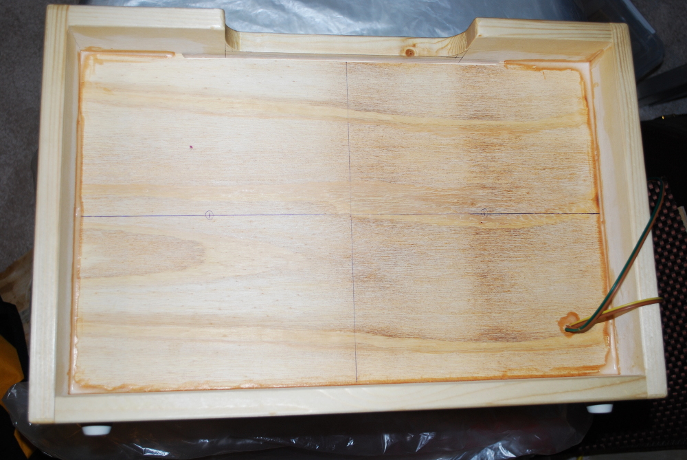

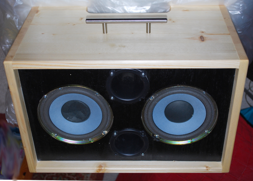

I did make some progress on the project amp today - now the speakers are installed, as is the cabinet handle. I've cut the aluminium for the control panel, sanded it to a satin finish, and did a little internal carpentry to make the control panel fit (I had to rout a little clearance groove in the hidden internal back panel). I expect to make a little more progress tomorrow, and may have some pics to share.

Here are a couple of pics. Speakers in place, brushed-nickel drawer pull handle from Home Depot, and I just finished the "There's no going back!" step, gluing in the hidden internal back panel that seals off the air volume behind the speakers.Looking forward to it.
As you can see from the front view, one of the speakers encountered, shall we say, a minor domestic incident that left it with a mauled dust-cap. Very fortunately for me (since these speakers are irreplaceable), there is no detectable mechanical damage to the cone, spider, surround, or voice coil.
There will be some sort of grill installed over the front before the amp is finished. I'll just have to make sure it's visually opaque enough to hide the dust cap damage. And with the de-nastifying filter rolling off treble starting at 2 kHz, I don't anticipate any audible treble loss as a result of using a slightly more opaque grille cloth.
One benefit of the smaller speaker drivers should be less beaming of the treble - at least, if you stand the cab on its side so the drivers are in a vertical line. I know that this is the right thing to do from the acoustics point of view, but I also know my conservative, non-technical, older friend will not understand that, and it will just look wrong to him.
So I gritted my teeth and designed the cab to do exactly the wrong thing, i.e. place two full-bandwidth drivers side by side several inches apart, just as the last fifty or sixty years of guitar amps have done.
-Gnobuddy

Might be worth trying angling the drivers away from each other a bit in a baffle that has each half angled a bit to each side.. I saw a photo recently of someone who tried this and he liked the results. Plus looks a bit like a old car grille
T
-Gnobuddy

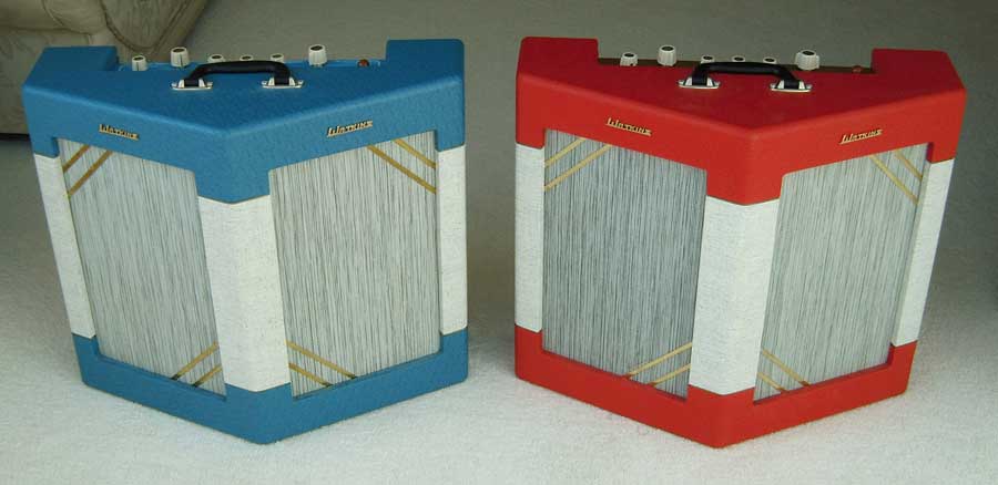

Thanks for the suggestion. Like the old Watkins Dominator that was cloned to create the original Marshall 18 watt? (Pic attached).Might be worth trying angling the drivers away from each other a bit in a baffle that has each half angled a bit to each side..
In general, it might very well be a good idea, especially with typical large diameter guitar speakers (which beam like a searchlight, so there won't be much acoustic interference if you aim them, say, 30 degrees away from each other).
In the case of my current project, though, it's taken me over a month of free time, and cost me more than I can spare, to build the (simple rectangular prism) pine cabinet. There's no way I'm starting over with a considerably more complex cabinet design. 🙂
