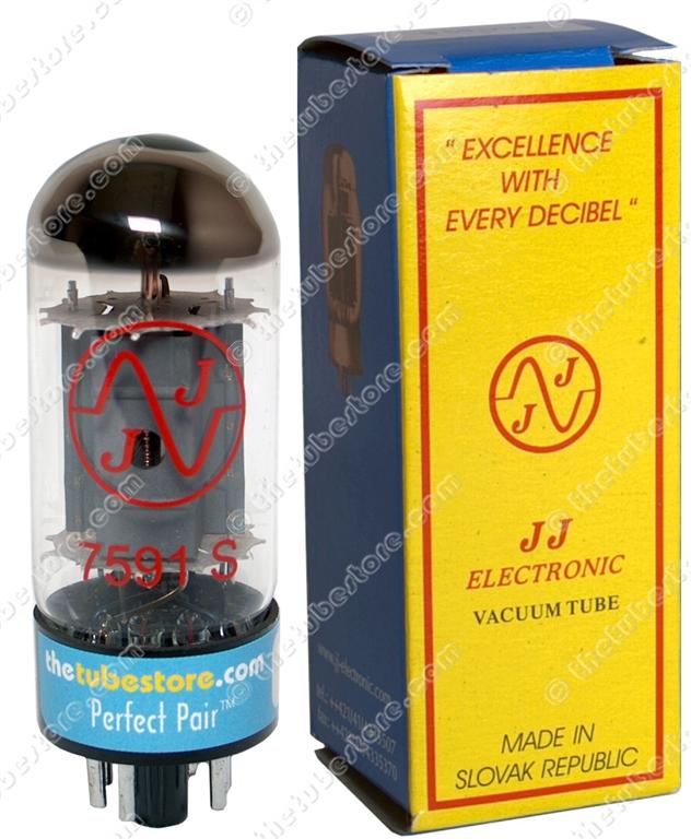

This may have something to do with the JJ 6V6's in my Princeton Reverb, which seem to sound more sterile and solid-state than "real" 6V6's do. (The Super Champ has a non-JJ brand of 6V6's).
I don't want to start any conspiracy theories and "tube sniffing" contests, but take a look at the attached photos of the JJ 6V6S and JJ 7591. The plate structure looks identical to me. I think JJ simply took their existing 7591 valve, re-pinned the base, labelled it a "6V6S", and started selling it.
Also take a look at the original Tung Sol 6V6 and 7591 data sheets. Notice the THD specification: the 7591 generates much less THD, i.e. "sterile clean" from the point of electric guitar.
