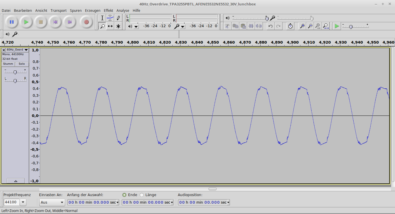

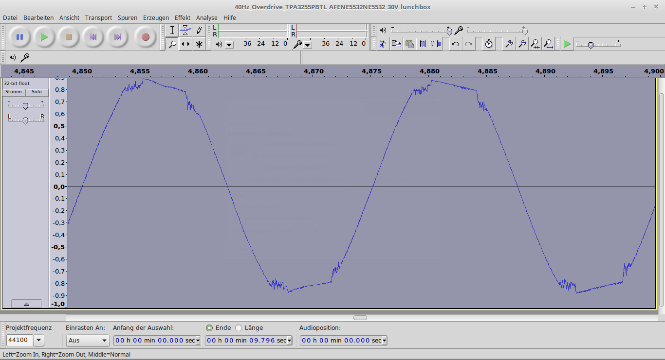

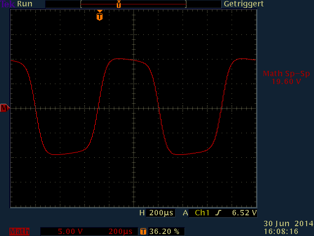

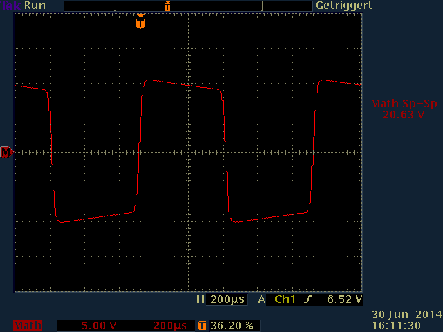

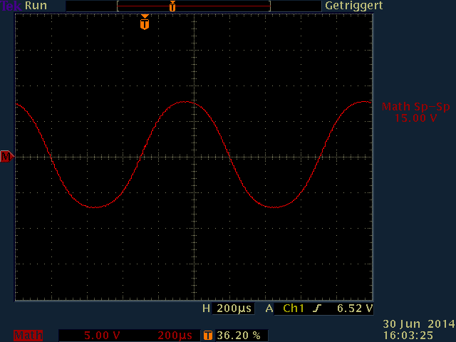

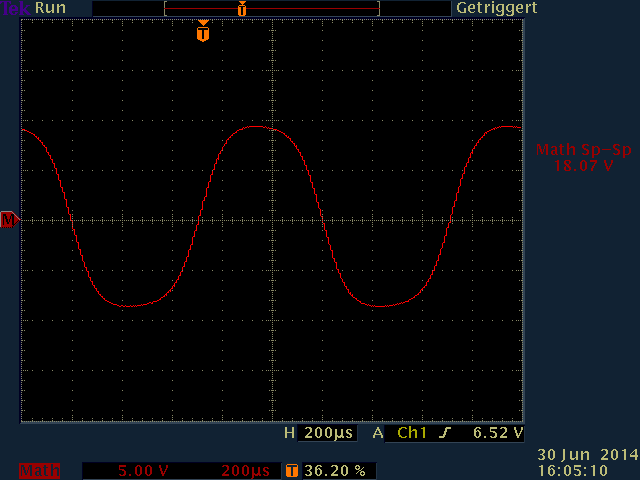

Over the years I designed numerous Class-D-amp pcbs, including TPA3255, TPA3100, TPA3118, TPA3251 and TPA3255. My motivation focused on building 12V battery powered small combos. One of the first things to learn was that Class-D-clipping distortion is real crackling nasty sound, unacceptable if you push the amp into the limits (i.e. not for guitar players😉)
Yesterday I had to check some old musicbox speaker and I connected it to one of my hifi-TPA3255 boards that lay around. Then I applied a low frequency sine wave around 40Hz and turned up the volume until a crackling sound like some loose voice coil windings came up. After some investigation it became evident that the speaker was fine, but the amp was just reaching its clipping point. The transisition from linear to clipped is noisy, and in case of a low frequency test signal that noise is inevitably audible.
This sound has been captured using my soundcard and as a result I append an audio-snippet of that recording.
Feeding the audio into audicity shows the distortion and the noise during transition.

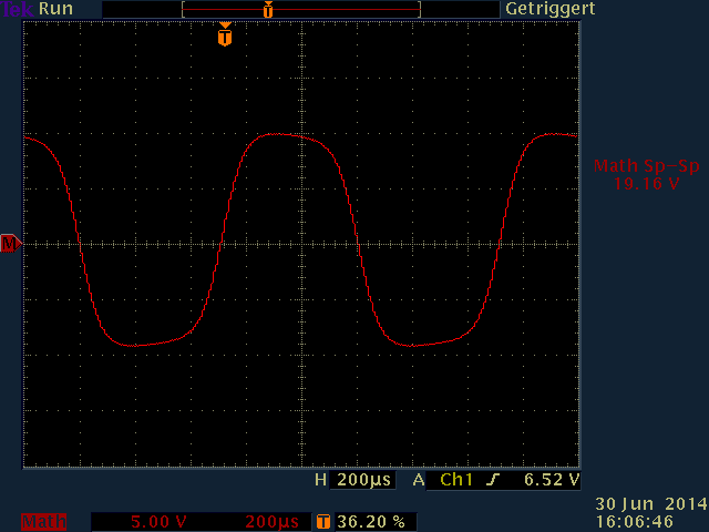

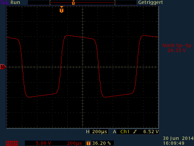

To avoid these nasty class-d clipping distortion I use a "soft clipper". The scope screenshots show output voltage of Class-D-TPA3118 speaker output with increasing input voltage.
The input clipping level was adjusted for a max output level just below the characteristic class-D-clipping.
As can be seen, the class-D "nastiness" has disappeared.
GoldenSample20140630_gain_min_reverb_min_vol_max_input_20mvrms_ch1_speaker_out.png6.3 KB · Views: 94
GoldenSample20140630_gain_min_reverb_min_vol_max_input_10mvrms_ch1_speaker_out.png6.5 KB · Views: 92
GoldenSample20140630_gain_min_reverb_min_vol_max_input_05mvrms_ch1_speaker_out.png6.7 KB · Views: 144
GoldenSample20140630_gain_min_reverb_min_vol_max_input_04mvrms_ch1_speaker_out.png6.8 KB · Views: 158
GoldenSample20140630_gain_min_reverb_min_vol_max_input_03mvrms_ch1_speaker_out.png6.8 KB · Views: 167
GoldenSample20140630_gain_min_reverb_min_vol_max_input_02mvrms_ch1_speaker_out.png6.8 KB · Views: 168
