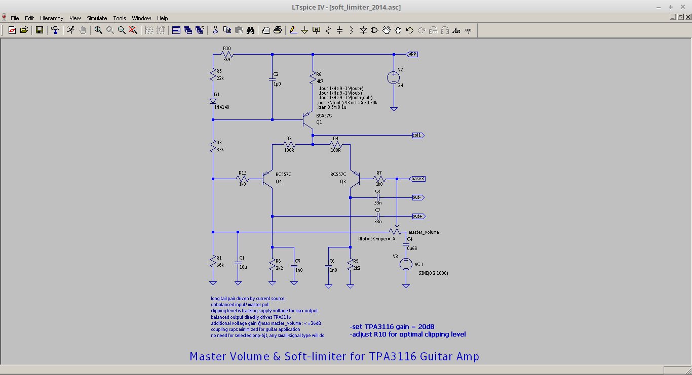

This is the circuitry I use. It is not too complicated and will work on a perfboard as well.

Q1 is the common current source - so I do not understand your question about its output.
The story behind this circuit is quite old.
It started in the sixties with building myriads of fuzz-boxes using transistors and diodes. The discussion about a smooth transition from linear to distorted was already present, and I recognized by learning semiconductor basics that diode fuzz transition is inherently abrupt.
About 1972 I put my hands on a RCA databook of integrated circuits. During the dark ages of Pregooglium information was sparse so I read this databook from cover to cover.
Among others I discovered the new CA-3080, an "operational transconductance amplifier" (OTA) and somewhere its transfer curve - a smooth, perfect S-curve! In other words the the long sought choice to build a distortion unit.
From that moment on CA3080 was the way to go. Besides being a bit noisy this chip never disappointed me.
In the eighties and nineties I lost interest in guitar amps. The amp worked satisfactorily so there was no need to change anything.
About 2010 I re-started guitar amp engineering aiming at small battery powered solutions based on class-d-amps.
But, alas - CA3080 was obsolete meanwhile.
So I had to simulate CA3080 with parts available now -
and the simplest approach was the long tail differential amp.
End of the story:)

...CA-3080 (OTA)...its transfer curve - a smooth, perfect S-curve!
<snip>
...the simplest approach was the long tail differential amp.
We all know that BJTs have an almost perfectly accurate exponential characteristic. When wired up into a long-tailed-pair, the exponential characteristics of the two devices combine to create a complex tangent (tanh) function. Which is, indeed, a smooth, S-shaped curve: ( Hyperbolic Tangent -- from Wolfram MathWorld )
This characteristic of the long-tailed pair has been used for decades in audio function generators, to round off the tips of triangle waves, turning them into a crude approximation of a sine wave.
IIRC JFET differential stages (also a smooth S-curve, but not a tanh() function) are used in Boss's BD2 and OD3, maybe in others too.
I'm not sure why the BJT long-tailed-pair hasn't been used in more guitar distortion pedals. Possibly just ignorance on the part of most FX pedal designers. Also possibly because the setting of the input signal level is fairly critical, and smaller than the output signal of a typical instrument-level device.
End of the story:)
It is just the 'coil' point that I was wondering if it went somewhere or was just equivalent to a test point, I barely scratched the surface of spice simulations way back when. I may have to jump in the virtual world on this one.
The explanation makes sense on reproducing the section of the IC circuit. You must admit it is not the first thing that comes to mind when you (well others) get to designing a limiter or clipping unit. I could not see any lineage from pedals people come up with. I am guilty of poring over data handbooks when I was younger. It beat going to classes in school.
Agreed, I always considered this attempt a trivia and wondered why it was widely ignored.
ah, now I see, the "coil" point is in reality "col1", i.e. the collector of Q1 - just a bias measuring point.
