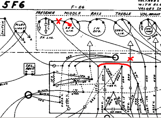

I took an additional look at the changes in NFB between 5F6 and 5F6A, but from the layout point of view, rather than the schematic.
Here is the 5F6 layout with the 5F6A mods in red:
When you look at it on the layout, it kind of looks like you are doing the "right" thing, as in "we need to put the NFB to the unused input of the LPT"
It is entirely possible Leo was indeed intending to do it the "right" way.
To "complete" the mod, he needed to lift the 10k tail resistor and run it to ground, but there was no extra eyelet to do so.
There was no "visual cue" that anything further needed to be done.
It's easy to overlook the 10k tail resistor in this situation.
I can totally see how that could happen. You are focused on getting the NFB to the right place, the tail resistor is not of immediate concern.
You mod a little, test a little, mod, test, and stop when it works.
Heck, I've done stuff like that a bunch of times, although my errors usually end in a puff of smoke rather than the most iconic guitar amp of all time.🙂

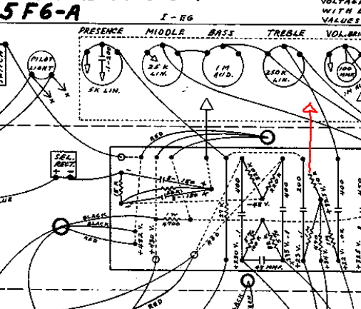

Here is the 5F6A circuit with the "completed" mod shown in red.
This is the "correct" way to do NFB to a LTP
The 5F6A method worked good, looked good on the eyelet board and Leo may have thought it was the "right" thing, because it kind of looked like the right thing, at least on the eyelet board.
The new schematic was drafted after the mod was performed, and Leo may have said
"Is that what we came up with? Well that's odd, but it fixed the problem. I'm done fooling around with phase splitters, this is what we are using from now on."
And I think it is entirely possible you've solved the mystery. Sure your last name isn't Poirot? 😀When you look at it on the layout, it kind of looks like you are doing the "right" thing, as in "we need to put the NFB to the unused input of the LPT"

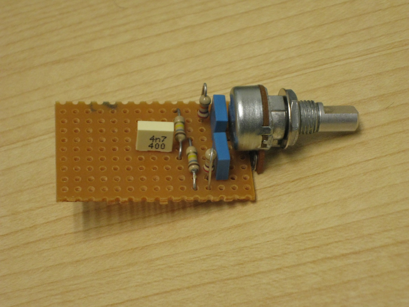

I made a little progress on the amp late last night. I clear-coated the small aluminum control panel in less than ideal conditions (cold and rainy). The class-D power amp module is mounted in the electronics cavity on the back of the amp. A quick 11 PM low-volume test with the guitar straight into the class D module revealed no obvious problems.
The de-nastifying filter is ready to go, but the JFET input is still in breadboard form. The tone control isn't built or tested yet, only simulated in LTSpice. So I'll work on some of that today.

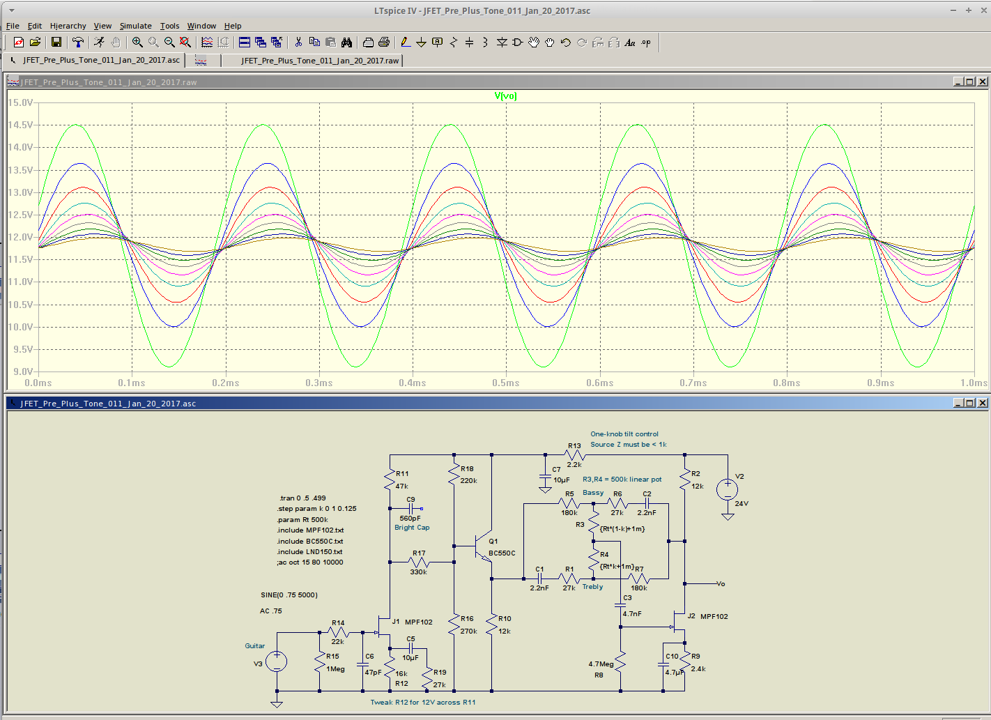

I'll attach a schematic of what I'm planning. Remember, all FET source resistors shown on the schematic are wrong - these are the values LTSpice wants to bias up properly, but the actual FETs I have want something very different.
Oh yeah, the weird DC coupled bias network around the BJT buffer for the tone control is a combination signal attenuator and biasing network. It's DC coupled to reduce space needed on the little protoboard. Attenuation has been set to produce around 5Vpp from the tone control output at full boost (either 80 Hz or 5 kHz), with 1.5V pp input from the guitar.
There is a similar not-quite-kosher DC coupling in the tone control. But resistor values are large, and unwanted leakage currents due to the DC coupling will be in the 1 uA range.

The resistive connecting network between drain and base of Q1 will degrade noise performance for no obvious avail.
Why don't you connect the base directly to drain, omitting 3 resistors?
I started with that idea, but that would allow the tone control circuit to be clipped if the (guitar) input was driven hard.Why don't you connect the base directly to drain, omitting 3 resistors?
In an active tone control, clipping is not good: open loop gain falls to zero during clipping, so negative feedback disappears, so the entire tone-control characteristic disappears. You get nasty clipping, and no tone control, at the same time!
The tone control itself has a maximum gain of about 12 dB, so the only way I can be sure it won't ever clip, is to make sure that there is some 12 dB of signal attenuation between the input JFET and the tone control. That way, the input JFET can be in full clipping, acting as a limiter, and the active tone control still won't clip.
The weird 3-resistor network is a way to keep the DC voltage on the BJT at essentially half B+, simultaneously create some signal attenuation, and not use a coupling capacitor. Thevenin impedance of the 3-resistor network at the BJT base is a lot less than 330k, I think closer to 100 kilo ohms.
I will do some tinkering on the breadboard to see if the 330k can be reduced without the tone control getting clipped in practical use.
Incidentally, so far, noise hasn't been an issue with this amp. Probably because it cannot be turned up to 110 dB SPL like most guitar amps can! With boombox speakers and maybe 35 W RMS total power, it doesn't get loud enough for hiss to be audible.

There should be better ways to reduce input gain if required.
For instance raising source impedance of input JFET.
I see no point in attenuating drain voltage of JFET input stage.
If your Emitter-follower clips, the preceeding JFET will clip as well, or am I missing something?

The ratio of Rd/Rs sets DC operating point, so I can't raise Rs without raising Rd to match.There should be better ways to reduce input gain if required.
The actual values that worked on my breadboard are 10k for Rs, 47k for Rd. The LTSpice model for the MPF102 doesn't match my actual MPF102 well, so I had to use a different value in LTSpice.
Small-signal gain of that input stage is around 4 (maybe a little higher). I settled on George's guitar 'scope capture earlier in this thread, showing about 1.5 volts peak-to-peak, as an expected maximum input level. With a gain of x4 and B+ of around 20 - 22 volts, the input stage should handle that without trouble.
I may be able to raise the input stage gain a little more, but the circuit as shown was tested and it worked to reduce the harshness from the guitar.
(Exactly why this worked to reduce harshness, is still a little bit of an unsolved mystery. I don't know exactly why. Predicted steady-state THD is quite low, so my guess is that it has more to do with compressing the big initial transient voltage at the start of each guitar note. But that's only a guess; the other possibility is that I have simply allowed my mind to trick me into hearing what I wanted to hear. Of course, I don't believe that yet. But I haven't conducted a double-blind listening test, either! 😀 )
I don't think you're missing anything, but the input stage can clip without causing any obvious problems, other than the usual guitar overdrive / distortion (which is desirable, if anything).I see no point in attenuating drain voltage of JFET input stage.
But if the active tone-control stage clips, the frequency-dependent negative feedback goes away during clipping, which means the frequency response of the stage is no longer set by the feedback network. So you not only get clipping, but along with it, wild and unwanted changes in EQ. The tone control stops working as a tone control, in other words.
I suppose it's possible that this might (by chance) sound good, but my first thought is to make sure the active tone control never clips.

So, in LTSpice, I AC-coupled a 27k resistor in parallel, effectively creating a 10k source resistance, so that predicted voltage gain would be a bit closer to reality.

We often talk about the famous 5F6A Bassman, but similar is the 5F8A Twin. Almost identical circuit, with the Twin having 4 5881.
It's possible the R&D work was actually done on the Twin and backported to the Bassman, I believe the Twin was the "top of the line" model at that time.
Leo was using extremely crude +/- 20% resistors from the E6 series, meaning his LTP balance would vary wildly from one amp to the next, up to a worst-case 40% mismatch.
If Leo had wanted to use, the less common at the time, 10% or 5% resistors, wouldn't he have used used 100+91k instead of the 100k+82k load resistors, for better PI balance?Well, no. You must not have spent much time inside vintage Fenders.
This even if he had the most magical feedback scheme in the world. There is simply no way to ensure LTP balance when the triodes and resistors Leo used had these sorts of huge statistical parameter variations. There is also the fact that a perfectly balanced phase splitter would still inevitably be followed by imperfectly matched output valves, and an imperfectly symmetrical output transformer. The output of the amp would still contain lots of imbalance.

Now that I look at this further, he may have used the 82k instead of the 91k because he was using a tail resistor of 10k.If Leo had wanted to use, the less common at the time, 10% or 5% resistors, wouldn't he have used used 100+91k instead of the 100k+82k load resistors, for better PI balance?
The 12AX7 will be pretty well balanced in a LTP, provided the tail resistor is high enough.

My gut instinct is that Merlin Blencowe, and mjd_tech, are both right: Leo, or his tech, changed the feedback scheme for stability reasons, and did what was easiest to do with the existing eyelet-boards.
Since I haven't actually tried writing down the loop equations for Leo's weird feedback and solving them manually, mebbe it's worth running a quick little LTSpice simulation to see what good, if any, occurs.
(Since same-name devices are all perfectly matched in LTSpice, my first thought is to just using two different N-channel JFETs instead of triodes to simulate imbalance in LTSpice.)
Meantime, I have finally made a little more progress on my project (see pic). The tiny proto-board holds the tone control pot, and the passive components needed for the active tilt tone control. That is a 13 mm (half-inch) Alpha pot, with a metal shaft, and good control feel.
The last bit of electronics will be to put together the input JFET stage, the BJT emitter-follower to buffer the tone control, and the JFET for the active tone control itself. That will go on another little board, possibly soldered direct to the 1/4" input jack.
Now that the tone control is almost done, I'm wondering, is there any kind of standard as to which way a tilt tone control should work? More bass at full clockwise, or more treble? 😕
My first thought is more treble as you turn clockwise, which is usually the way the "tone" knob on a guitar is wired. That should cause less confusion for my senior-citizen friend when he finally starts using the amp...his guitar and his amp will have tone controls that turn the same way to produce the same effect.
Your thoughts?
