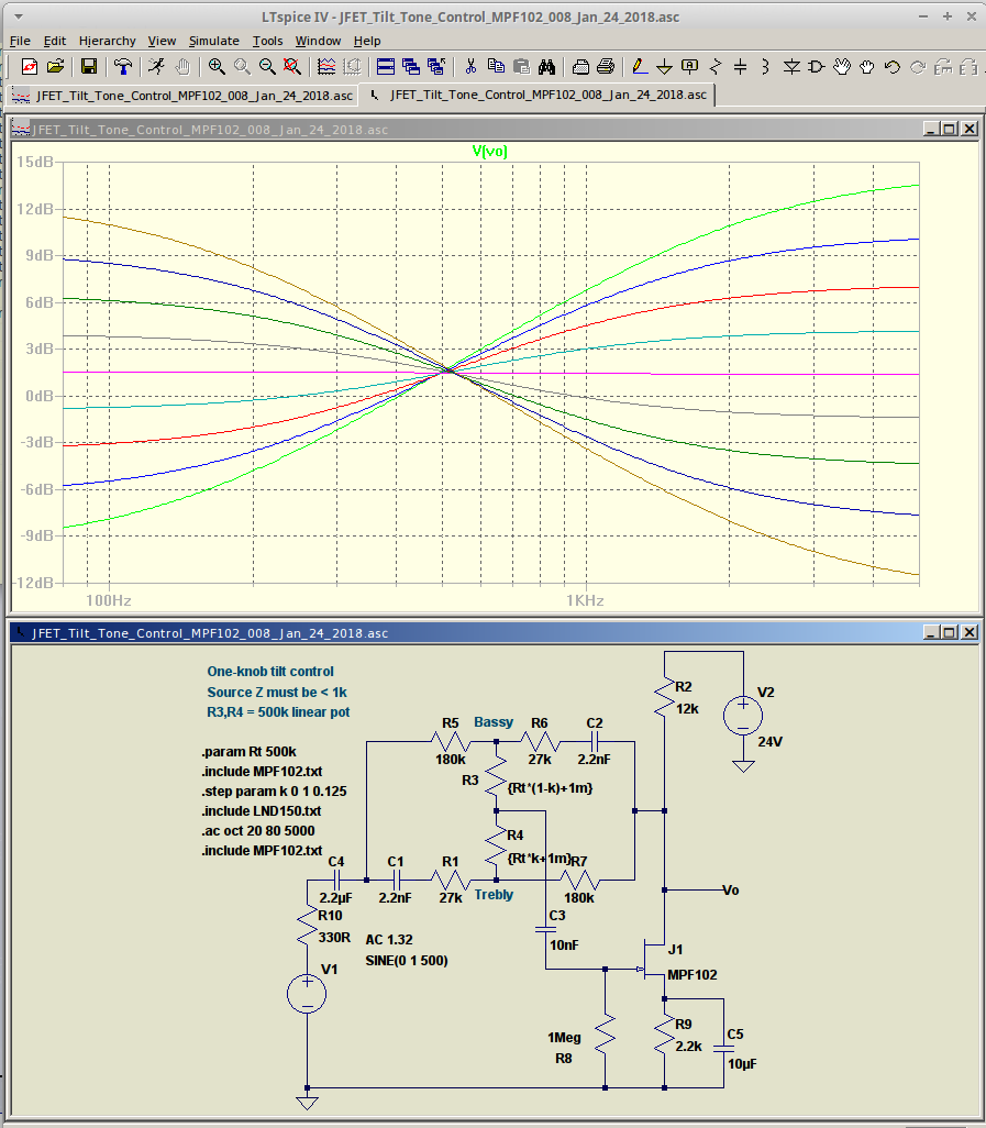

For the amp I'm building, I've settled on an active version of the "tilt" tone control, loosely related to the one used in the Big Muff Pi distortion pedal. It uses only one linear pot (500k in my case), and the active version has very nice-looking curves if you believe the LTSpice simulation (attached).
I thought I had attached this earlier in the thread, but if I did, I can't find it now, so I'll just attach it here.
This tone control needs to be fed from a buffer with low output impedance. I haven't shown that in the attached image.
I'm still tinkering with some of the component values (coupling and bypass caps, etc.), so this isn't necessarily the final version.
Also, don't trust the value of any source resistors in the LTSpice simulations. On the breadboard, I'm finding that my little collection of MPF102 JFETs wants very different-value source resistances than the MPF102 model in LTSpice does!
-Gnobuddy

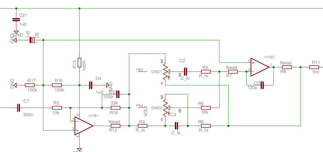

It took me a minute to wrap my head around your schematic, but then I recognized the well-loved active Baxandall circuit. I built my first one before I was fifteen years old (with a BC149 transistor, not an op-amp.) It is an old friend.
I have rarely seen an active Baxandall with the same-value potentiometer for both bass and treble, which you need to use a stereo pot the way you did. But I see Rod Elliott has such a design on his website ( Audio Designs With Opamps -2 )
The way you have your pots wired also makes a lot of sense to me. With simultaneous bass boost and treble cut at one end of the control range, you turned your Baxandall into a "tilt" control. (Maybe that's what Globalplayer had in mind as well, but I didn't realize that, and thought the idea was to have simultaneous bass and treble boost, or simultaneous bass and treble cut.)
I suspect that the tilt control I'm building (which I still haven't heard) will sound very similar to yours, minor differences in turnover frequencies and control range aside. One first-order RC low pass filter has pretty much the same-shaped frequency response as another!
-Gnobuddy
Disabled Account
Joined 2010
Yes, this is the well known Baxandall. I wonder why one should use different pot resistance for treble and bass, as far as I remember the hifi-standard was 10k Pots. (And 50k or 100k for the cheap and noisy mixing consoles).
I did the sound snippet on the fly, i.e. play some notes, turn the knob, and go on, no volume correction, no post processing. This demonstrates sound variation can be done immediately.;)
The bass potentiometer is shorted out by the parallel capacitor (or two capacitors, in some variations of the circuit) at midband and higher frequencies. So at these higher frequencies, feedback is set to unity, by the two resistors at the ends of the bass pot, and these are typically ten times lower than the value of the bass pot itself.
So I had the impression that the treble pot (and associated resistors and capacitor) had to have impedances considerably lower than the ones in the bass network, in order to be able (at high frequencies) to overpower the unity-gain bass components and raise the gain above unity once more.
Virtually all the Baxandall and James active tone control circuits I saw during the years I was actively building Hi-Fi stuff did follow this sort of arrangement - the bass pot was always higher value than the treble pot - which reinforced my belief.
But clearly the thirteen or fourteen year old version of me misunderstood how this feedback network works, since I now know it is a fact that there are working tone controls of this type that use equal-value potentiometers!
Back then I knew nothing about using complex numbers to represent reactances, or loop equations to solve AC networks, so perhaps it's not too surprising my intuition led me astray.
The silly part is that I never re-visited the circuit to check my understanding of it, so apparently I still don't have the right internal mental picture of how it works.

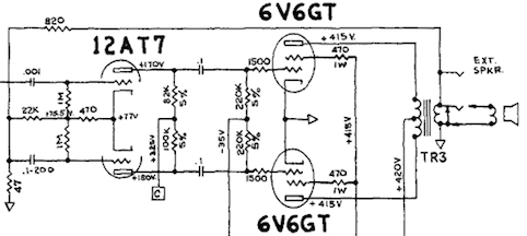

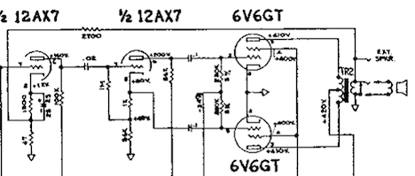

Surely these two feedback schemes shown below are equivalent in that they provide negative feedback over the stages shown.
The overall gain with feedback can be calculated from the open loop gain, including the transformer step-down voltage ratio, and the feedback ratio, using standard formulas from RDH, etc.
The output impedance likewise may be calculated based on calculating the effective plate resistance due to the feedback voltage and the gm of the output tube, in parallel with the internal plate resistance, and applying the impedance ratio of the OPT whilst adding in DC resistances, etc...
The schemes with presence control illustrate the effect of this feedback, which is to vary the damping factor of the system, including the amplifier output impedance and loudspeaker load impedance. It is to me a "hardening" of the sound that, while not unpleasant in itself, sometimes detracts from the smooth distortion tone. I don't always set the presence control at maximum. This tells me that some way of incorporating a varying amount of load feedback to a final tube stage is an important part of the tube amp experience.
The extra scratchiness of some presence controls is certainly due to the presence (!) of DC across the element; not as bad as DC across the wiper but still a source of noise. Easily improved by using the parallel DC/AC path scheme.

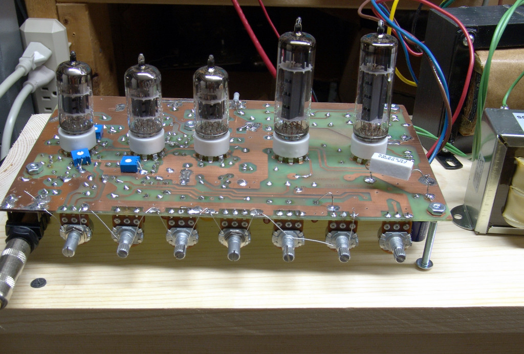

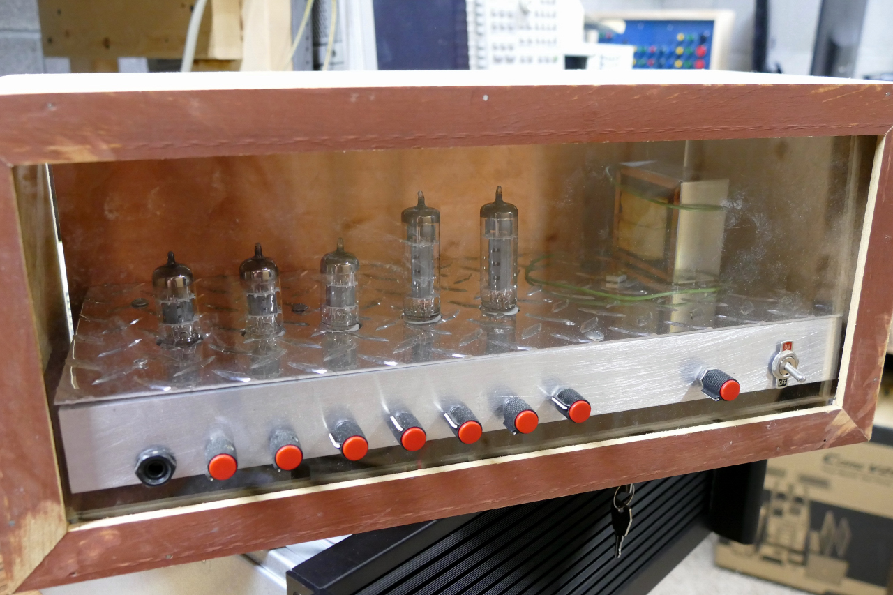

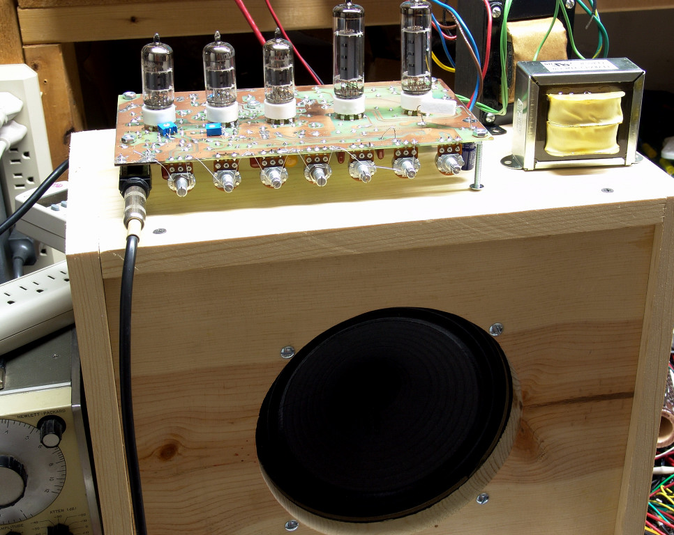

The 6AQ8 was not very common in the US. I did however make a screamer of a guitar amp using 3 X UCC85's (26AQ8) and 2 X UL84 (45B5). This board was lost for several years, but was recently found hiding in a partially finished cabinet that I had forgotten about. I will be firing it up and tweaking on it once I clear out some other projects.
