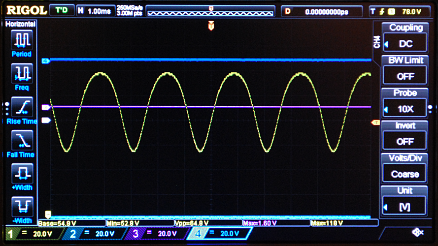

Here is something I've been meaning to post to this thread for a while, but kept forgetting to.
A couple of years ago I was fiddling around trying to make the clean tones from my little 6AK6 push-pull amp sound good. I was working with just the power amplifier section, which consisted of one (valve) gain stage, an LND150 source-o-dyne, and a pair of 6AK6 as outputs.
After a few failed experiments, I tried using a 6AG5 (small RF beam tetrode) as the gain stage, and immediately got better, more "valvey" cleans. They got better as the amp got louder, and the signal traversed a bigger region of the load-line.
So I added a pair of resistors to attenuate the signal between the 6AG5 and the LND150, so I could drive the 6AG5 a little harder for the same speaker volume. Bingo, better cleans again.
Adding a graphic EQ pedal and dialing in a smooth treble boost starting at about 1 kHz and rising gently to 5 kHz produced some really nice "tubey" cleans.
I had been working without an oscilloscope up till then. It was at this point that my then-new Rigol oscilloscope arrived, so I hooked it up to the anode of the 6AG5, and got my first look at what I had been hearing (pic attached.)
Looking at the 'scope trace, I was pretty shocked to see just how much even-harmonic distortion I had ended up with. With my little 2-watt amp, this sounds completely clean if you play a single note on the guitar. If you take away the treble boost EQ and play two bass notes at once, you can hear a little intermodulation distortion, too slight for most guitarists to notice, though anyone with Hi-Fi leanings will hear it immediately.
At the time I didn't realize there was an FFT function in my 'scope, so I fiddled with a spreadsheet and tried to duplicate the 'scope waveform by adding a second harmonic term to a sine wave. I came close with 35% (!!!) second harmonic (pic attached.)
Our ears get more sensitive at higher SPL levels, so maybe we don't need 35% second-harmonic distortion for good "tubey" cleans at higher SPL. But for a two-watt amp, and my ears, this turned out to be about right.
One of the things I would like to do with FETs is see if I can get anywhere close to this amount of second harmonic distortion. So far, I can only get there with some sort of subtractive circuit, in which I subtract a portion of the undistorted, phase-reversed input signal from the signal at the FET drain.
Anyway: here are (a) the anode waveform from the 6AG5 driving my phase inverter, and (b) the spreadsheet simulation of it.
-Gnobuddy

I would guess that the current SE amp I'm playing through looks about like that in the mid-high volume range.
There is quite a good chance it does!

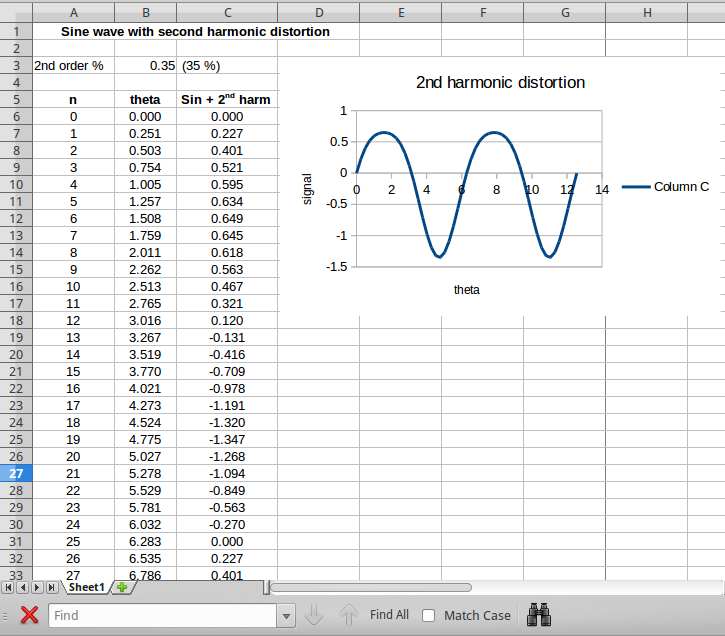

<snip>

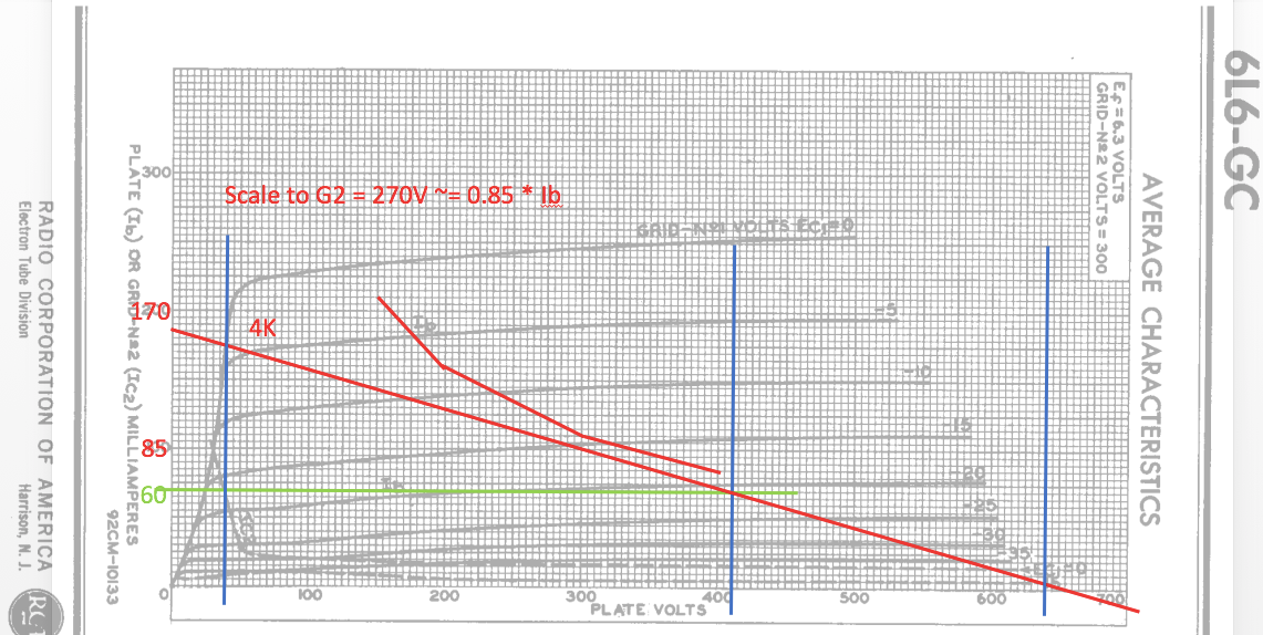

This is a follow-up to this previous post.
KMG seems to have pretty much nailed triode emulation using FETs. So what's left for us lesser mortals to do?
Well, how about trying to emulate the output of a single-ended beam tetrode (not a triode) with an FET? Many blues players love single-ended amps with a 6V6 or 6L6 at the output. Can we make an FET sound a bit like that?
As mentioned in the bit of my old post that I quoted above, it is hard to extract 35% second harmonic from an FET. Every simple FET circuit I tried so far will clip long before it generates 35% second harmonic. Beam tetrodes, though, will happily generate 35% (mostly) second harmonic distortion well before clipping, as my little 6AG5 did, or Michael Koster's single-ended 6L6 probably does.
So what shall we do if we'd like an FET to sound more like a single-ended 6V6 or 6L6 or 6AG5?

I'm attaching below the 6AG5 "clean tone" 'scope trace as a reminder of what we want from the FET, and an LTSpice screenshot of a circuit I devised to exaggerate FET second harmonic distortion as outlined above.
