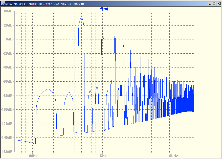

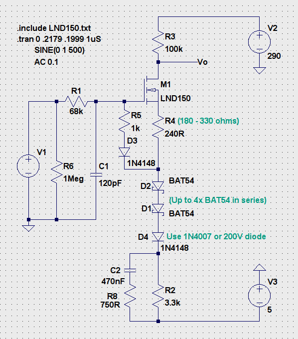

The attached screenshots show the schematic, and an FFT of the simulated output with a 500 Hz, 2 Vpp sine wave input.
The fundamental and several harmonics are very clear, but, interestingly, there are also sub-harmonics below 500 Hz, and non-harmonically related IMD products in between the 2nd, 3rd, 4th, harmonics.
KMG really captured a lot of triode-like complexity in his LND150 circuit...amazingly good work!
Simulations can be a terrible time-sink, but they can also, under the right circumstances, guide one to a good solution that reduces time taken to actually build something that works. That happened for me last week with the "de-nastifying filter", and I'm hoping it will happen again when I try to get a more "triodey" clean tone out of this thing.

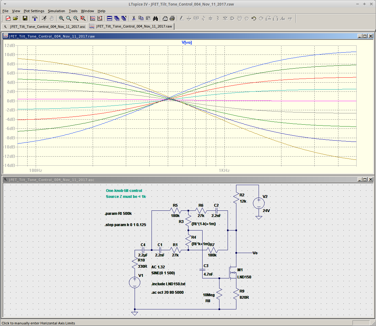

I started with this: One-Knob Wide-Range Tone Control
As you can see, I modified it (in LTSpice) to use a single MOSFET instead of an op-amp, scaled the components to give a much higher input impedance and less loading on the active device, tweaked it for more treble and bass control range, and moved the crossover frequency point down to around 500 Hz to suit guitars better than the original 1 kHz.
The attached frequency responses are plotted from only from 80 Hz to 5 kHz, the actual frequency range of interest to us guitarists.
The friend I'm building this amp for doesn't get along with complicated gizmos with too many knobs on them, which is another reason I want to keep the tone control to one knob if possible. I'm thinking a three-knob design, with gain, tone, and (master) volume knobs.
Active tone controls must be kept out of clipping, otherwise the frequency response and distortion goes to he11 in a hand-basket, so I'll have to be careful where this goes in the preamp audio chain. I will have around 20 volts of power supply voltage, so hopefully it will not be too hard to make sure this never clips.
It does weigh on my mind that I don't think I've ever heard anyone praise a tilt tone control in a guitar amp. But those amp designs were not already voiced for good clean tone before the tilt tone control was added, so I'm hoping the story will be different this time.
