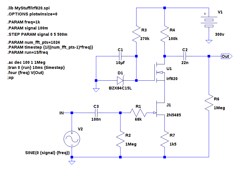

Way back in the day, long before LND150s were available, a trick for adding a gain stage to a tube amp was the jfet-mosfet cascode.
A 2n5485 jfet and an IRF820 mosfet works nicely with the Leo Fender approved 100k/1k5 resistors.
You get about 1.5v on the source of the jfet and about 2/3 v+ on the drain of the mosfet, gain of about 50, pretty close to a 12ax7.
Makes a really good 1st stage, no hum or microphonics, It has the proper "gling" and sounds good overdriven with a booster pedal.
I've used that cascode for regular gain stages, reverb driver, reverb recovery, and tremolo oscillator.
Here is the general circuit that I have used:
Signal step, into heavy overdrive:
Now, that cascode circuit makes no attempt to mimic a 12ax7, if anything, it mimics a pentode such as EF86. No attempt at simulating grid current either. So what. If it sounds right, I'm good with it.
I haven't played with LND150s, but I suspect you could get a good sound out of them even without the elaborate KMG schottky diodes and negative supply.
If you want to simulate grid current, the simple way is a silicon diode pointing from gate to ground. You can tune it by playing with the series resistor from input to gate, 68k, 100k, 220k, 470k, all the common values used by Leo and Jim (Marshall).
I imagine that gets you 90% "there", and KMG was going for 100%, thus all the schottkys and negative supply.

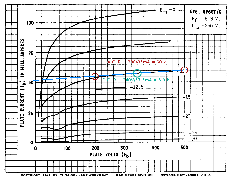

Agreed that anode resistance is definitely variable, so this is very much an approximate calculation. But I think it's a reasonable "guesstimate". Perhaps +/- 30% or so (i.e. within one order of magnitude)?I am not sure if you can take the plate resistance of the output tube and scale it through the transformer to get the output impedance. I think of the internal impedance of the tube as being variable.
Current sources are magic - a mathematically ideal one amp current source with one volt across it has a DC resistance of one ohm, but an AC resistance of infinity!On the other end of the scale, with full signal it has to have a low resistance otherwise we would not get our maximum current flow.
More realistically, take a look at the attached Tung Sol 6V6 datasheet curves. I picked a reasonable operating point, and at that point, DC resistance is around 6 kilo ohms, while AC resistance is around 60 kilo ohms, ten times higher!
Some "big bottle" output valves have much lower anode resistance. I think I saw 15 kilo ohms on a data sheet recently, for an EL 34 or 6L6 or something similar.
But four times lower than 50 ohms is still 12 ohms - still much more than the nominal 8 ohm impedance of the guitar speaker.
For me, that was the surprise - that the typical valve guitar amp has enough output resistance to kill most of the electromagnetic damping from speaker voice coil back EMF.
Which means, enough output resistance to cause a huge undamped bass hump in the frequency response.

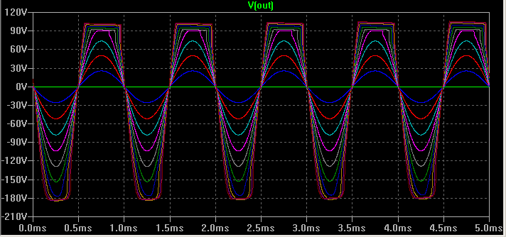

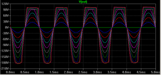

Those are some pretty sharp corners on the positive half-cycles (near +90V on the graph). Usually, corners that square sound very harsh to me. To you?Signal step, into heavy overdrive:
My limited experience is: "less bad" than BJTs, but no better than okay sound.I haven't played with LND150s, but I suspect you could get a good sound out of them even without the elaborate KMG schottky diodes and negative supply.

In practice the clipping is a bit smoother.Those are some pretty sharp corners on the positive half-cycles (near +90V on the graph). Usually, corners that square sound very harsh to me. To you?
It's not intended for heavy overdrive like I showed in the simulation, but makes a good clean boost and a bit of nice grit when mildly overdriven.

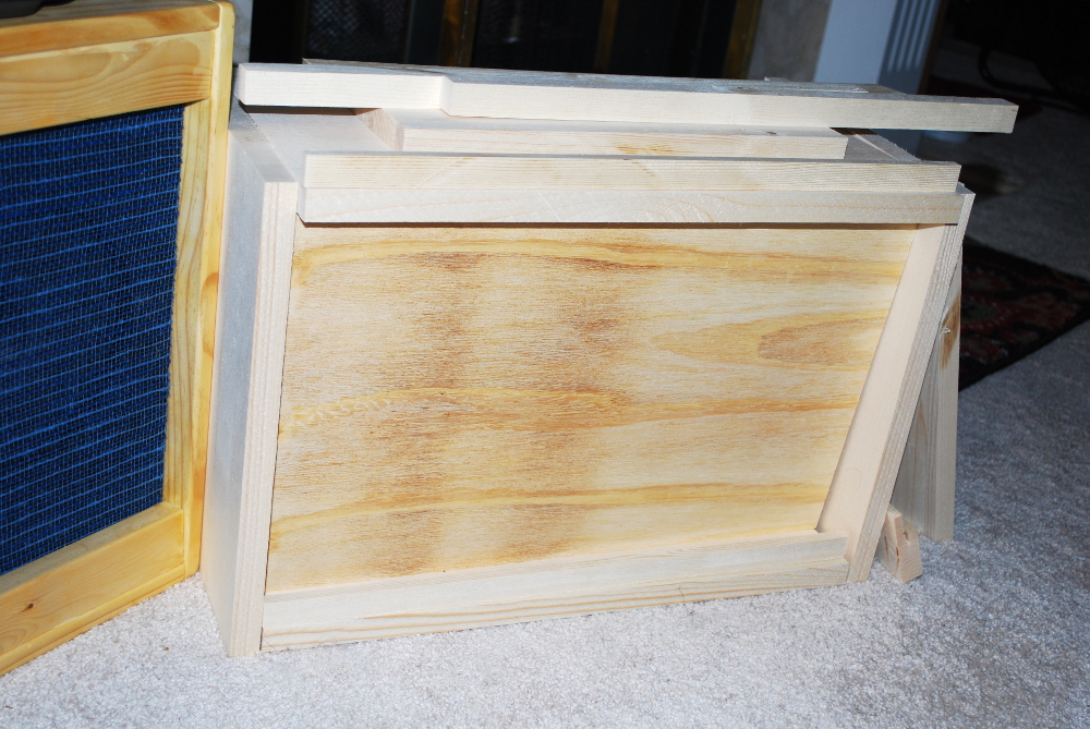

I got most of the wood for the new cab cut, except for the speaker baffle. The material is 1" thick pine block-board to keep the weight down. As usual, 1" actually means 0.75".
Big Brother to the left is a cab I made earlier this year, about the size of a Princeton Reverb cab. That one is made from a piece of furniture IKEA calls a "RAST" nightstand, and currently has two 8" speakers mounted in it.

Good to know, thanks!In practice the clipping is a bit smoother.

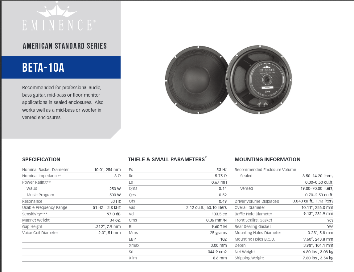

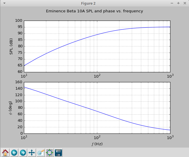

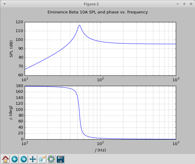

As it happens, I recently spent a couple of hours working on a mathematical model for loudspeakers, and then writing some Python code to see if my equations looked like they were correct. So, for giggles, I found Thiele-Small data for an Eminence Beta 10A, and ran it through my software, first with an amp with virtually zero source impedance (solid-state), then with a 50 ohm source impedance (and the same amount of drive current to the voice coil). No speaker enclosure was used in either simulation, just the driver in free air.
The results are quite striking if you've never seen them before. Driven the way it was designed to be driven, from a nearly zero source impedance, the Beta 10A driver by itself has very overdamped bass indeed, so there is heavy bass roll-off below 200 Hz (which is already 3 dB down). This driver is not intended to be used this way - stuffing it into a properly sized cab will bring the deep bass up and flatten the response, as the designers intended.
But if you put 50 ohms in series (the equivalent of driving it from Printer2's PP 12AB5 amp), all the speaker designer's hard work goes out of the window. Q rises to about 8 (!), more like a wah-wah pedal than a speaker, and instead of extremely overdamped bass, you get the opposite, an absolutely horrid frequency response, with a huge peak of more than 15 dB, right at the 53 Hz fundamental resonance of the driver.
The Beta 10A is a bass guitar/ P.A. speaker, which is why Eminence publishes Thiele-Small data for it - they're expecting you to drive it with a solid-state amp, and install it in a proper sealed or ported enclosure.
I would love to see the same kind of simulated results (or, even better, actual acoustic measurements) for an actual guitar speaker. But I haven't had luck finding published Thiele-Small data for one.
I think we now know why, TS parameters would be worthless anyway, if you used a valve guitar amp to drive the speaker!

I found one:I would love to see the same kind of simulated results (or, even better, actual acoustic measurements) for an actual guitar speaker. But I haven't had luck finding published Thiele-Small data for one.
http://www.eminence.com/pdf/EGTR_S1012.pdf

I just use a jigsaw followed by bit of sanding. I use the router mainly for the roundover bit.I also found out that I'm going to have to make my own jig if I want to cut circles with my little hand-held router.

Found my drill.
Part of the reason amps like the 5E3 Fender Deluxe, Princeton, sound good at medium volumes (distorted but acceptable) but have the complaint that the speaker flubs out at high volumes is due to the low dampening factor. People select speakers with a tighter bottom end (stiffer suspension) to limit the flubbiness. The rising impedance of the speaker also meant that a tube amp will try to put more power into a speaker at these frequencies than a SS amp will. This unintended EQ may help to give the speaker some 'sparkle' or at times it is called 'ice pick' depending on the player and the amp. So some combinations of amp-speakers work and some don't. Is it a bad amp or speaker? More like they do not react well given the output impedance characteristic of the amp.
Yep, the 5E3 has no global negative feedback, so that speaker flaps in the breeze.Part of the reason amps like the 5E3 Fender Deluxe, Princeton, sound good at medium volumes (distorted but acceptable) but have the complaint that the speaker flubs out at high volumes is due to the low dampening factor.
