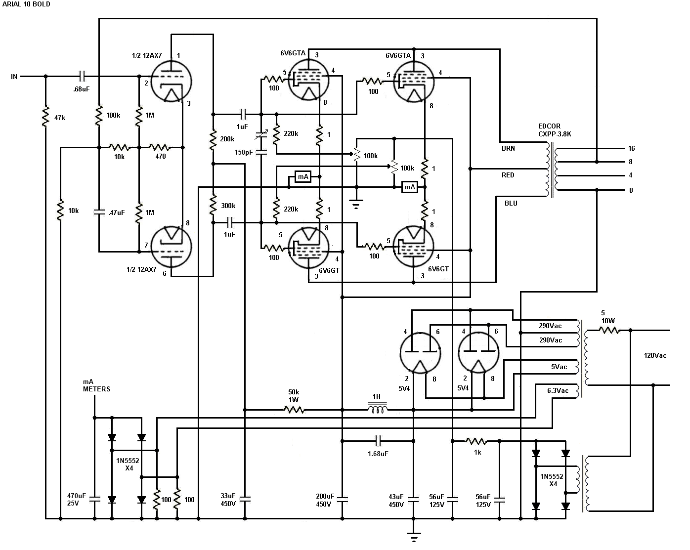

Due to not using a resistor to ground on the input of the amp and the bias supply having 100mV of ripple I had hum. Fixing those eliminated that hum.
All I now have is a slight barely audible rushing sound which is likely coming from the tube buffer.
Otherwise the amp is working great and sounds very good.
Just by redoing the bias supply to where it has only 5mV of ripple and installing the 47k resistor on the input to ground I can unplug the input cable and the amp is pretty much dead silent.
That said it almost sounds like how a tube might do when microphonic so maybe the 12AT7 is slightly microphonic and is somehow picking up the noisy computer fan or some other vibration or noise.

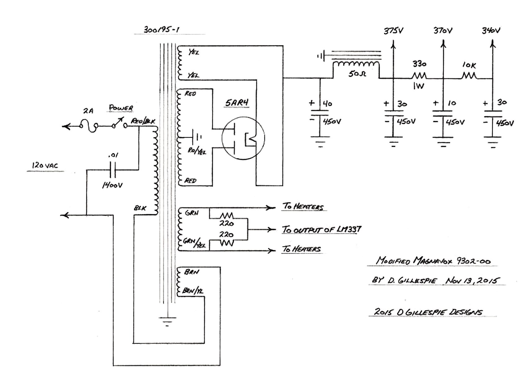

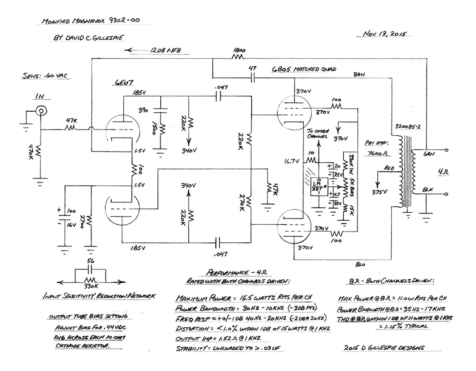

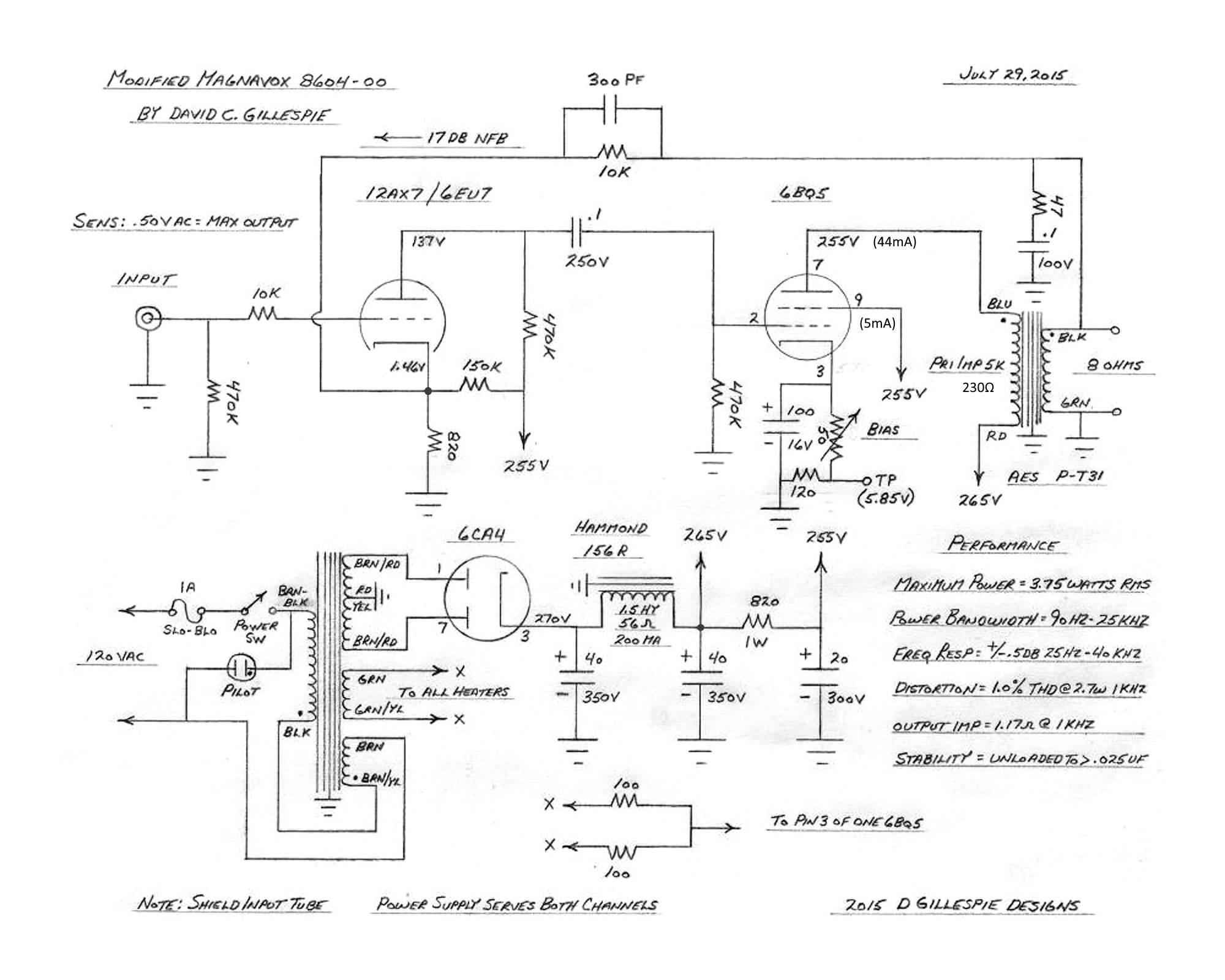

As far as Magnavox input sensitivity, I am going to go with what Dave Gillespie had on his two big Maggie rebuilds (on Audiokarma)- The 9300 push pull was full output power at 0.6Vrms, and the 8600 single ended was full power at 0.5Vrms. That feels right, and why I install a 10K input volume pot on all of my Maggies so I can listen to my Denon CD player mano-a-mano, with the volume at about 9-10 o'clock or so on a log pot. Assuming proper output to input impedance matching, that gives the pre-amp with little or (preferably no) gain plenty of ability to provide maximum volume to the power amp even for weaker sources.
I was wondering if you could explain better what you meant by "output rising as the frequency increased", and you indicate several times you had problem getting the amp to work up to 20KHz? Did you ever hear of these problems on the stock amp? I had wondered earlier, what type of characterization did you do to optimize the global feedback network after you changed the input stage gain, and output transformer? Both would change the dynamics of the amplifier, and the amount of, and frequency compensation of global feedback would have to be adjusted to optimize both the global gain and stability.
For both the 9300 and 8600 build, Dave shows images of square waves he took into unloaded, and loaded (and capacitively loaded) output to analyze stability and frequency response. On the 9300 he tuned the global feedback to achieve frequency bandwidth 40-20Khz, very stable with a lot more power than original. On the 8600 he achieved 25hz to 40Khz, also with way more power. The gain of the input stages was not decreased- stability was increased. Both of these builds are excellent reads as to the feedback optimization process if you are interested.

I should clarify that global feedback only works to reduce gain, and will not increase gain above what the open-loop amplifier can do, but does determine how much of that (hopefully very high open-loop gain) is available in the final, closed loop amplifier. Generally the amplifier inside the feedback loop needs to be very high gain, which I am surprised lowering the input stage gain is a win frequency range wise. Tube amps are known for having pretty stellar frequency range, so something is wonky here if you were having trouble getting to 20Khz. Was that at full power level? (Usually frequency range is measured at rated load, but lower power level, and power bandwidth is measured loaded full power (to the -3dB half-power points) I believe.
I used the trimmer cap which is in series with a 150pF cap as shown on the schematic.
Not sure when these measurements were taken, but it shows the problem I had. I adjusted the trimmer cap until I had the least rise in frequency when I did the same test.

Only thing I can figure is either its the mismatched output tubes (two different brands) or the circuit just doesn't like the output transformer and needs the compensation or it's how the circuit is laid out.
I'd love to either purchase or borrow a bone stock AMP-142 in fully working condition so that I can perform tests on it just to see if it exhibits the same problem.
Now that I have had a chance to sit down and re-read much of what Dave posted in the 9300 series re-design, I am understanding that rising output with frequency is a very common issue, caused by approaching the resonant frequency of the output transformer. In high quality transformers this is normally compensated out with a small capacitor across the feedback resistor because the OPT resonance is high enough the negative effects of the compensation happen above audible frequencies. In the Magnavox amps, the stock transformers had a relatively low resonant frequency near the audible range with effects down as far as mid-band so rising output was quite noticeable, so Magnavox typically used hobbled phase inverters with HF roll off to somewhat compensate. Dave describes this very well in various posts in that redesign, with post #67 on page 4 being perhaps the most germane. I don't know what the resonant frequency of your Edcore is- Was this exact transformer specified in the reworked design you used from Facebook? I think maybe by redesigning the phase splitter to perform more flatly that this exposed the same issue in the Edcore.
The floating pharaphase inverter that Dave employed is really quite simple, and beautiful in it's performance. He details that in post #73. With perhaps some manageable changes perhaps you could give it a go. Later in the posts of this very long thread, he upgrades the output transformers and talks about how he adjusts the negative feedback to accommodate the new transformers. I must admit, after looking at that big spacious chassis you have, I would have been motivated to add a second matching transformer and modify it into a stereo 6V6 push-pull.

I basically use a floating paraphase already, however I will see how Dave's implementation is different from the one I used.
Thanks for the explanation. Now I understand why I had that problem and never saw it in any other amplifier.
I wonder if the tuner chassis had some compensation built in as well? That said typical cone tweeters usually don't go much above 13kHz so any rise in output above 13kHz wouldn't have been noticed or maybe would have extended the frequency response slightly.
You're certainly using a novel FB system. Never seen FB going to the cathode and grid on the same tube.
I never have either, however I've never dealt with a floating paraphase inverter before as I've always used other designs for my own builds.
Not quite sure what it is given how the .47uF cap connects as I've not seen a phase inverter quite like that, however it does work fine and provides balanced outputs.
