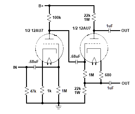

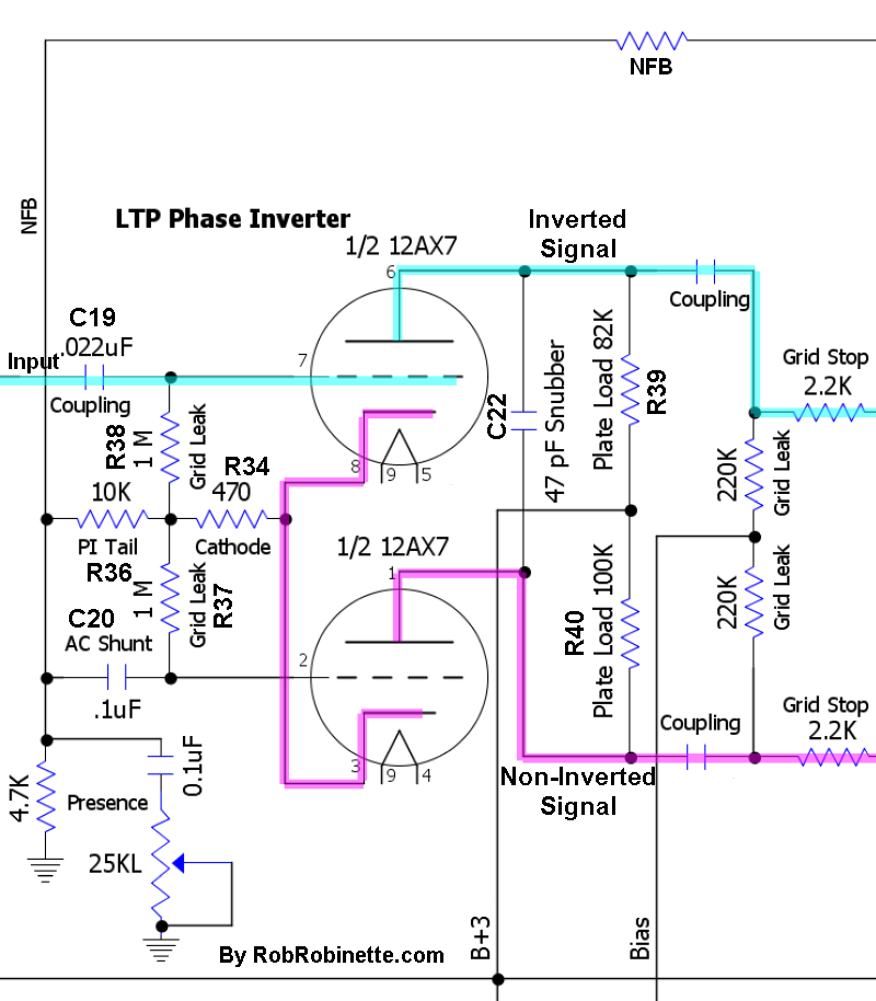

Concerning the amp is there any reason why I cannot replace the driver and phase splitter with this driver and phase splitter or is there a better phase splitter? I'd likely use a 12AX7 if the phase splitter can be modded for it.
The way the driver and phase inverter was originally done was like this.
The reason it was changed.
Also to further balance the 12AX7 plate signals and increase gain slightly.
However looking at this schematic shows it how I changed it. That said it is for a guitar amp so if the circuit did in that amp what it does in my amp it likely made the amp less clean which meant more would be sold given the last thing most guitar players want is a clean sounding amp.
So I will move the 10k resistor tomorrow to where it goes to ground and see what I get.
I moved the 10k that connects to the 1M and 470 ohm resistors to the 10k 100k junction. That got the outputs from the 12AX7 plates nearly equal.
Wanting more output I tried a 200k resistor in series with each 100k plate resistor. Got a little more gain so then I decided to correct the slight imbalance so I used a resistance sub box and paralleled it with the 200k driver plate resistor. I found that 200k got the driver and phase splitter to the exact same output as seen on a scope. I then replaced the 200k plate resistor with a 100k plate resistor so that I now have 200k for the driver and 300k for the phase inverter.

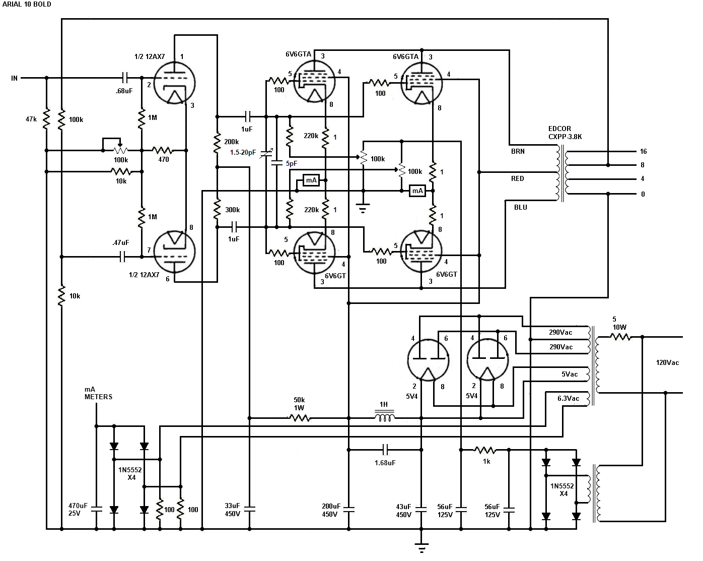

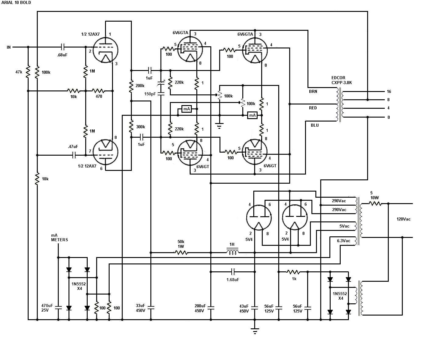

A long overdue update.
I got the amp sounding the best I can for now. I do need to get a matched quad of 6V6 tubes though.
Here's the schematic as of now. Gain is set to the stock value of 1 volt for full output which now is 25 watts.
I altered the compensation cap value and followed this procedure to get it set right.
1. Connect scope channel 2 to amp input.
2. Connect channel 1 across 4 ohm non-inductive load.
3. At 1kHz set both channels to where the sinewaves are equal in amplitude.
4. At 20kHz adjust compensation cap to where the sinewaves are once again equal in amplitude.
I noticed the upper treble improved some as the compensation cap I used previously had made it to where at 20kHz the output could not be properly adjusted following the procedure I used which likely was due to increasing the gain of the amp.
I find it interesting how by doing a few things I am able to get a clean 25 watts out of the amp which is 5 more watts than Magnavox spec'd the amp at. That said I don't know at what distortion level the 20 watts was at so I either improved the amp some if 20 watts was 0 distortion or a lot of the 20 watts was at some percent of distortion.

I knew if I worked at it long enough I'd be able to reduce the complexity to where all I needed was the preamp and the passive summing box.
The only minor issue is I have a slight variable noise in the speaker for awhile after the amp is turned on. It is almost like there's a loose connection somewhere.
For a 9.8mVrms input to the amp a 400Hz tone is moderately loud and music is at a decent listening level.
Decided to do a test and a MM phono cartridge connected to the amp will drive it to a decent output level.
So I figure my speaker is quite efficient which could explain why I had to get the power supply ripple voltage as low as reasonably possible to eliminate as mkuch hum as possible.

Cool news. Nice when a plan comes together. When you did your power computation was it from the scope voltage reading or from a DMM?
I used a scope to view the waveform across the 4 ohm load and put my DMM there to measure the voltage when the sinewave was right below the point of distortion. I used ohms law to calculate the power. I used a frequency of 400Hz.
Do you still have the voltage reading from the scope? Most DMM's lose accuracy as the frequency rises and they have a limit. Did you convert the scope voltage to RMS to see if it confirmed the DMM?
I don't trust my scope for voltage readings as it hasn't been calibrated in years. I do know however that my DMM is good at 400Hz as I didn't see any voltage change from 60Hz to 400Hz.

I still hear a slight crackling noise with my ear right by the speaker until the amp has been ran for awhile.
Given the gain of the amp is 11.7 and I'm using a rather efficient speaker that would make even the smallest noise in the amp audible.
So I wonder if there's a slightly loose tube socket pin or a cold solder joint or maybe one of the tubes is the problem.
I can test the tubes in my EICO 667 tube tester to see if there's any issues with them.

Try tapping about lightly with a sharpie or similar small insulated stick. Tap lightly on the chassis in different places, around the components and the sockets, even gently tap the tubes to see if they are microphonic. Wiggle the tubes gently and see if the pins are making noise. You'll find it.
I either didn't have the problem until the gain of the amp was increased or the problem was there and the lower gain kept it from being audible.
The amp went from needing about 2Vrms for full output to 1Vrms for full output.
