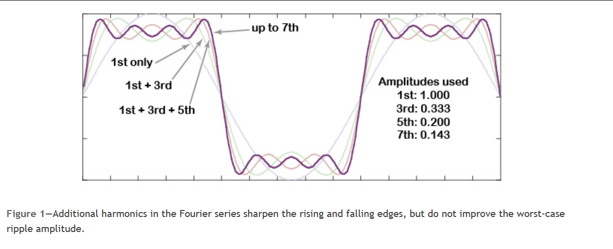

10Khz seems to be the common freq. to use when tweaking a phase cap. Mid band, I guess. But it's interesting to sweep it to see how well the OPT & FB handles the low freqs. Expect sloping as you tune it lower.

As 20to20 said, sweep it for different properties. 10Khz is the common choice for evaluating overshoot ring as it is a good standard to compare to pictures from other amplifiers, and it should resolve well before the downward transition. Very low frequency to see how coupling caps are discharging and if the OPT is saturating. Don't worry if/when you see the corners start to round off above 10Khz. If you read up on Fourier representation of a square wave, it takes up to the 5th to 7th harmonic to get it to look like a square wave with squarish corners, so if your amp rolls off at 40Khz, it has stellar audio performance but the 10KHz square wave will look pretty rounded.
