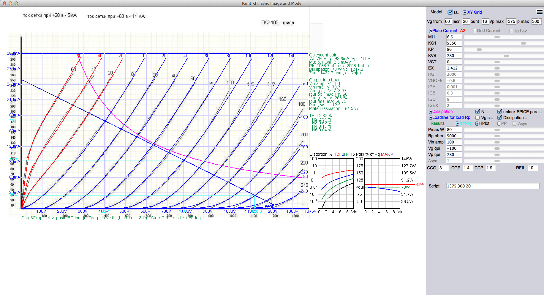

Hi, 🙂 before few years, i made some spice model against measured anode chrs in triode mode for GKE-100.
Ri of the tube is about 2Kohm in most of the region of the "middle space" where the working point has to be choosen.
So with some RLoad Req if the generator for the OT is about 1500ohms.

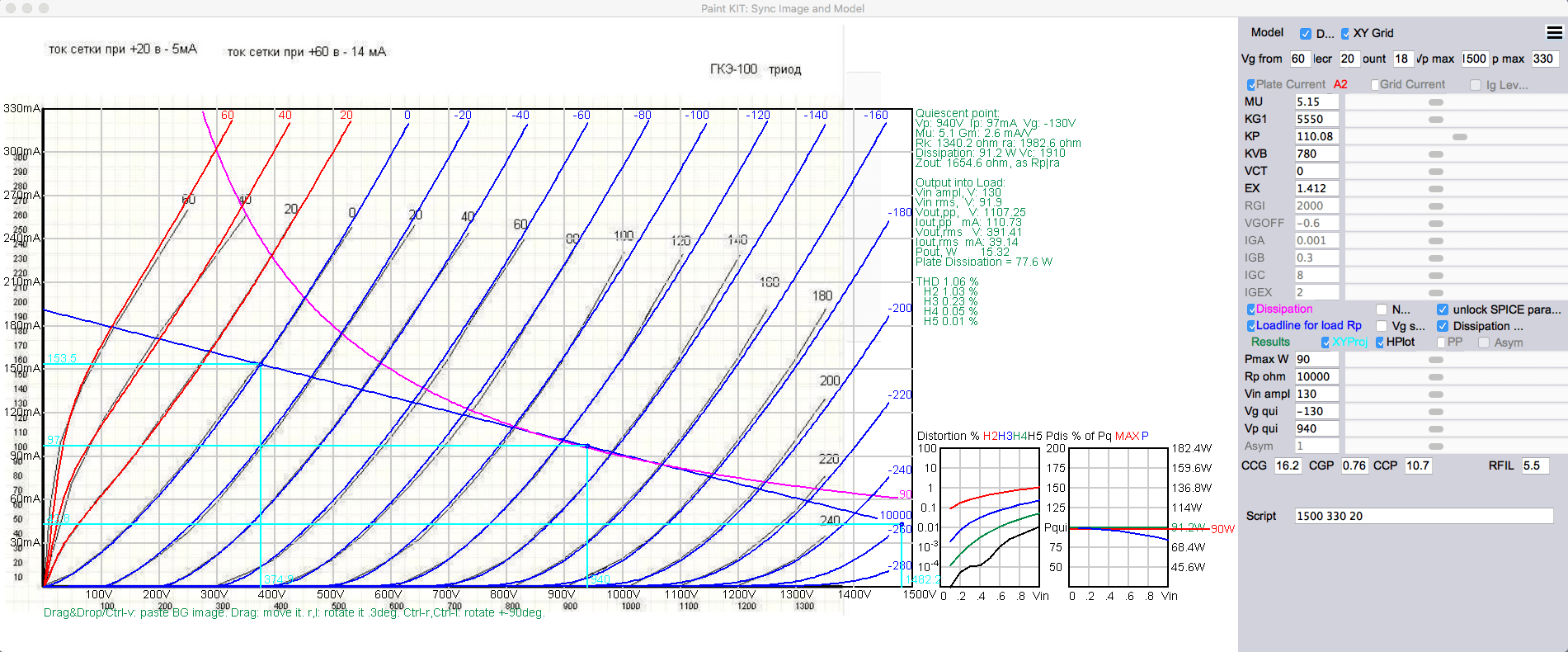

Why did you decide that Rp ohm = 5000 Ohms
in my case, with 4 ohm speakers, output transformer windings ratio is 52 : 1
That means at least Rp = 10 000 Ohms, and Ri in my case is 1800 Ohms

Hi i use max Pmax=80W. And some model with partial FB.Why did you decide that Rp ohm = 5000 Ohms

I done more accurate spice model in DHT mode with capacitances.
And 9K to 10K as Rload for the GKE-100 is more proper value in the terms of decreasing distortion.
The tube is very linear in triode mode. With these settings of Ug=-130V, Ia=97mA, Va=940V, Pa=90W, Rload=10Kohm
distortion are very very low.
1W=68Vp-p input=0.22%THD
5W=148Vp-p input=0.51%THD
10W=210Vp-p input=0.79%THD
max before A2 class:
15.32W=260Vp-p input=1.06%THD
For my opinion these estimated results based on static considerations are very, very good. And 15.3W is more than enough for domestic use.
(Of-course that the tube with driver and input tube circuit will add some more distortion, because of the high input swing
of 260Vp-p at G1 of power tube... )
But It is not clear what is max P. max Panode=80W + G2=?
(These settings are for max. 90W)
No the Ri is in wide region of different working points, 2K (1980ohms)
Please see in the picture calculated value.
For 10K static load line, Ri(Imax=155mA)=1720ohm, Ri(Io=97mA)=1982ohm, Ri(Imin=43mA)=2780ohm
(There is the big difference of Ri in extreme points. But it is not unusual for tubes... 🙁 )
For 5W output power (very loud!!!) difference of value of Ri is much smaller:
For 10K static load line, Ri(Imax=129.5mA)=1820ohm, Ri(Io=97mA)=1982ohm, Ri(Imin=65mA)=2280ohm
So the Rgen is parallel value of Rload (10K in example picture) and Ri in Io center point, Req=1655ohms
This Req=1655 ohms is the main factor in OT primary inductance needed for very good LF response and minimum phase shift.
And deserves more [Hy] in Lp primary...
I will simulate latter for minimal -db loss in 20Hz and minimal +deg phase shift.
(It is about the transfer in LF domain, most of the SE designs suffer a lot...)
The capacitances are low, so should apply some measures for eventual oscillations?
Amplification factor is also low, (low dynamic capacitances) BUT need of 260Vp-p input signal for max power.
If the 2Vrms=5.66Vp-p is at the input tube of the amplifier then total amplification before power tube should be 260Vp-p/5.66Vp-p=46X cca.
Maybe it is achievable with just one stage with 46x total gain in circuit to drive power tube?
So input tube has to be with mju about 55-60X, (in circuit -A is lower and will drop to 45X), low internal resistance, meduim S
and higher Anode voltage with settings, to avoid huge voltage drop (huge dissipation of heat at R) from Vb of power tube.

for 10Kohm load line
is the Pa+Pg2=100V max?
I took the capacitances from GE1 tube, because i could not find any for GK-100
and add 0.7pF to 1pF for socket-pin capacitance...
CCG=15.5pF
CGP=0.055pF
CCP=10pF
But these for tetrode, for triode mode are different values.
Probably CGP is significantly higher up to 15pF of CCG?
That is what has to be changed in spice model datas.
In any case that will be dynamic capacitance of around 80pF.
Cdyn=CCG + abs(-A + 1) x CGP
-A = is gain in circuit. (Negative sign is for phase shift of -180deg in SE anode connection...)
mju=5.15 so A is always less value than mju.
From picture -A is 1107Vp-p anode voltage result with 260Vp-p input
so -A=1107Vp-p / 260Vp-p
-A=4.26
