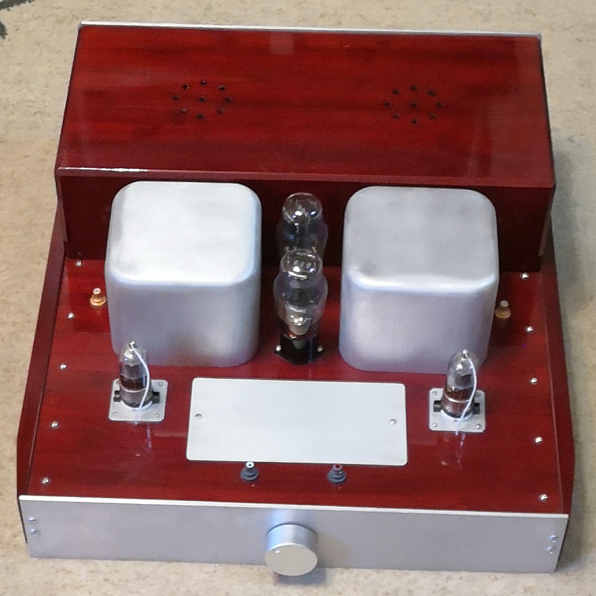

Here is the preliminary amplification unit that was told about earlier. Step-down 2:1 transformers are at the output. The body is made of wood (solid cherry) and aluminum alloy.

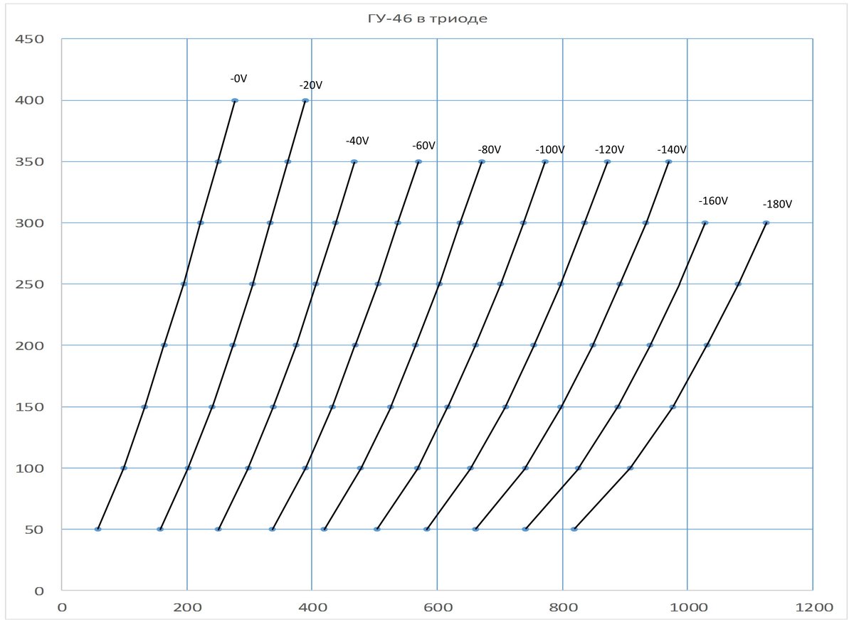

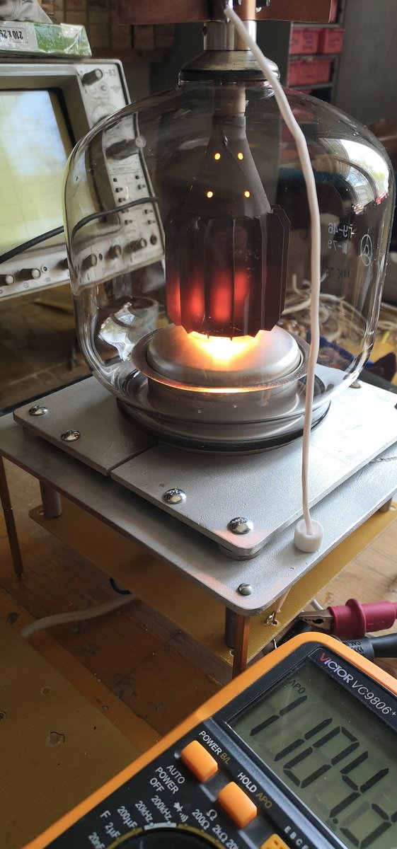

Also, the GU-46 tube is good for the output units of powerful single-ended amplifiers.
The maximum power dissipated at the anode is 500 W, in a triode connection the voltage gain is about 5, the internal plate resistance is 500-700 Ohm, depending on the operating point.
I enclose the results of preliminary (incomplete) measurements of the GU-46 in the triode connection (because of limited power of my test anode transformer). With SE output stage, one can easily get an output power of 70-100 W in A1. Big output transformers will be more simple in design, than for GU-48.

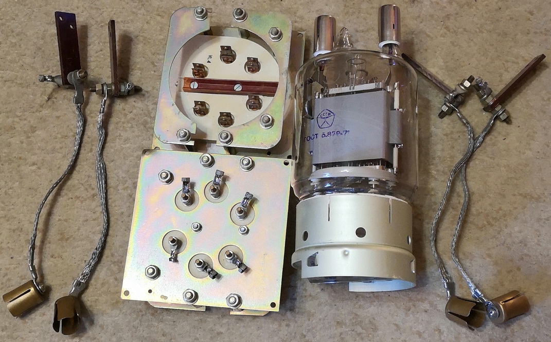

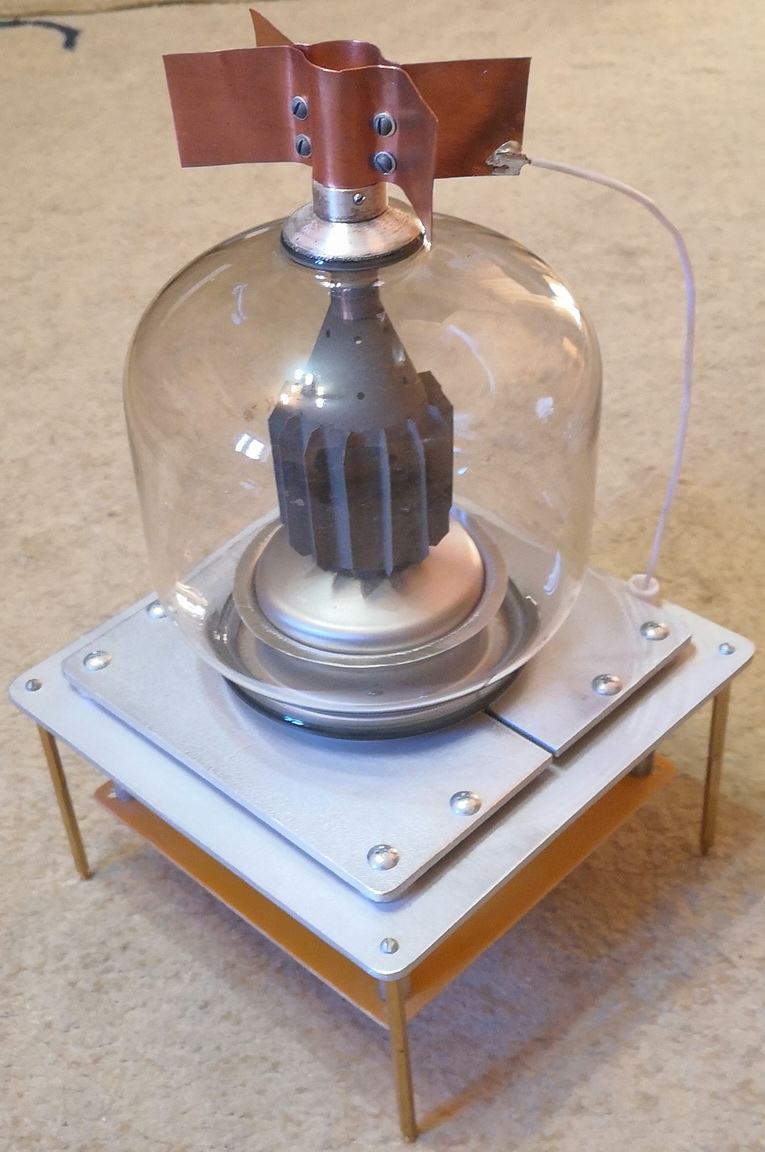

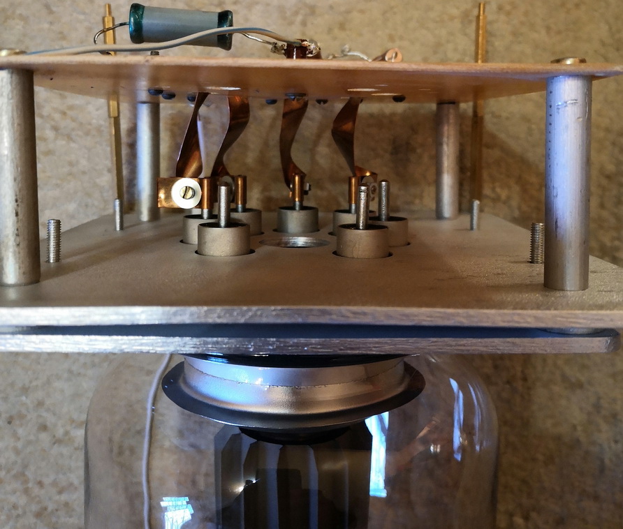

Speaking about tube socket for GU46, it is easier to go with self-made "socket", like in these photo. Also I intend to use assembled cathode resistor, made of 12 wire resistors, 10W each. In spite of all disadvantages, I prefer to go with autobiased stage.

Hi VladimirK, I think you will know that most high power triodes need solid socket contacts for a bit of cooling too. After all, the heater uses a lot of curent and a possible poor or less secure heater connection may damage the tube.
I have used Philips QB / TB triodes and tetrodes in diy, using air and watercooling... I used heater voltage stabilisation too.
Regards, Gerrit
Absolutely, the contact resistance to the filament pins should be minimal, and heat should be removed from the contact point. If we talk about GU48, a standard tube socket and top caps made in China have been used. The amplifier is in use for about a year, there are no issues with overheating. With GU46, the situation is more complicated, the filament pins have a diameter of only 4mm. But a copper plate 90x10x0.5mm is used as a current-carrying conductor, which squeezes the filament leg as tightly as possible. Clamping is provided by two M3 screws, nuts and spring washers. Even if the contact resistance is 0.01 Ohm (in reality it is less), it is not a problem to dissipate about 1 W of heat for the indicated copper plate.
If there will be overheating during prolonged operation of GU46, it will be necessary to increase the width of the copper plate.

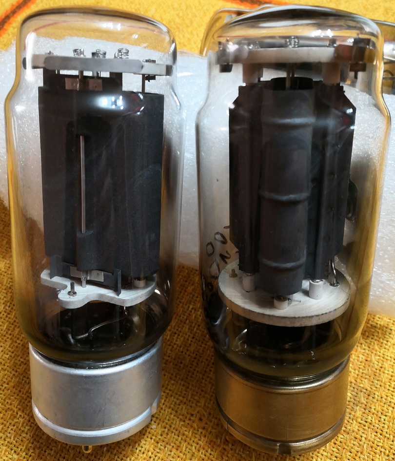

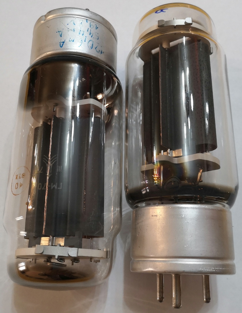

This photo explains, why metal plate GM70 is substantially different from graphite or copper plate GM70. The metal plate structure is fixed by four vertical supports, and only by two supports in case of graphite plate.
Copper plate GM70 has the same ceramics and supports (mechanical structure) as a graphite plate tube, but sounds better, because of the metal plate.
However, the "Iron" plate GM70, moreover, has much rigid mechanical structure, four vertical supports. Therefore they are considered to be "Queens" among GM70 family.

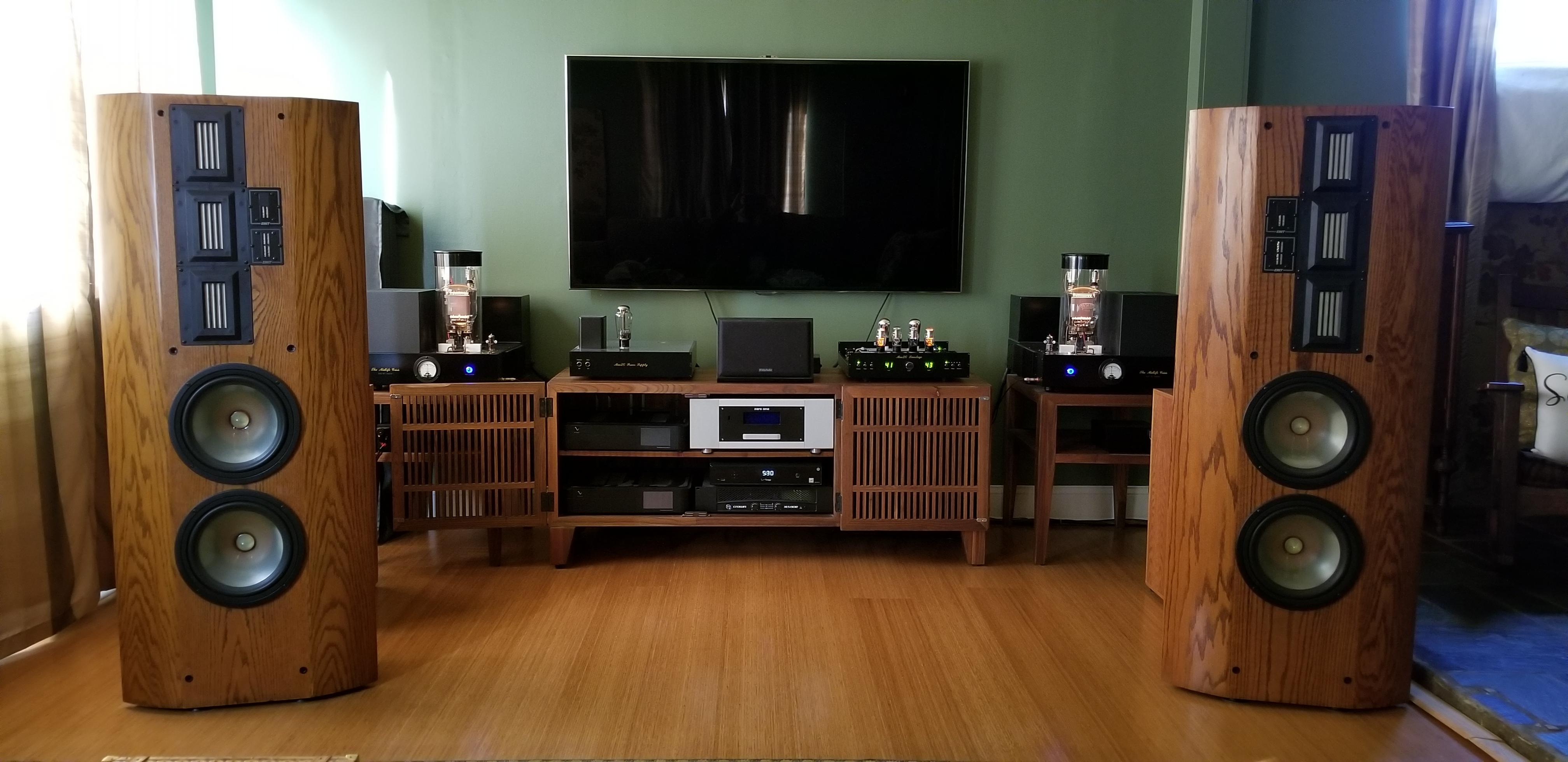

I never saw this thread because it mentioned the model of speaker but not the type of vacuum tube. I suppose you've seen my thread on the Midlife Crisis 833C amps. I too wanted to drive big, inefficient speakers (Infinity RSIIb) full-range with an SET, so high-voltage transmitter tubes became the solution. Enjoy!
At 2300V anode and 160mA, I get 40W Class A1 and up to 200W in Class A2. Mostly I stay in A1 but transients definitely push me well into A2. Very powerful, yet definitely SET sound. I went for the Monolith OPTs, expensive but they are great-sounding!
