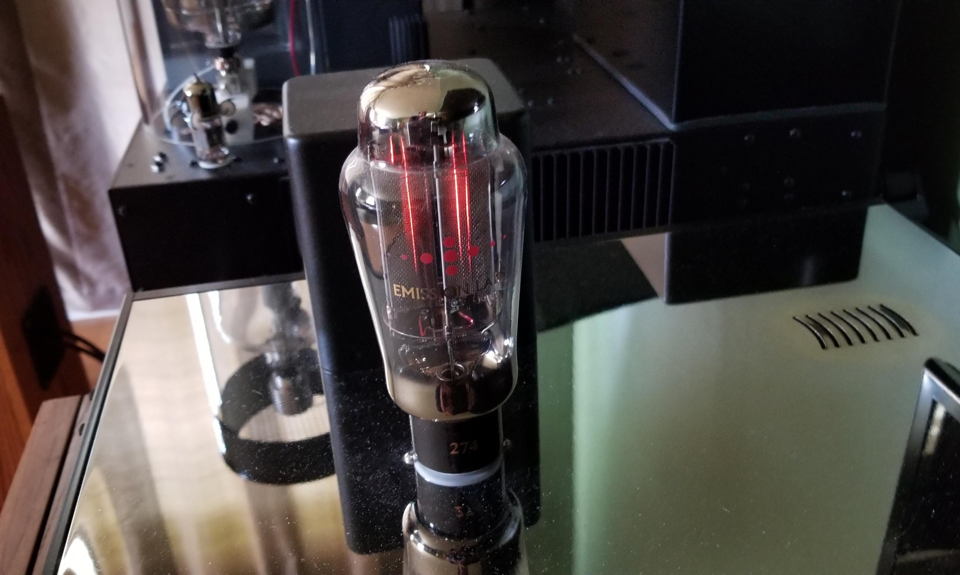

Graphite anodes, hot anodes, metal, nickel, etc.
I've never see better looks than mesh and holed 🙂
I like mesh rectifier tubes, and run an EML 274B rectifier in my UX-201A preamp/DAC.
Small power mesh plate tubes are very nice! There is no comments about. I'm using mesh pentodes as first tube now as well.

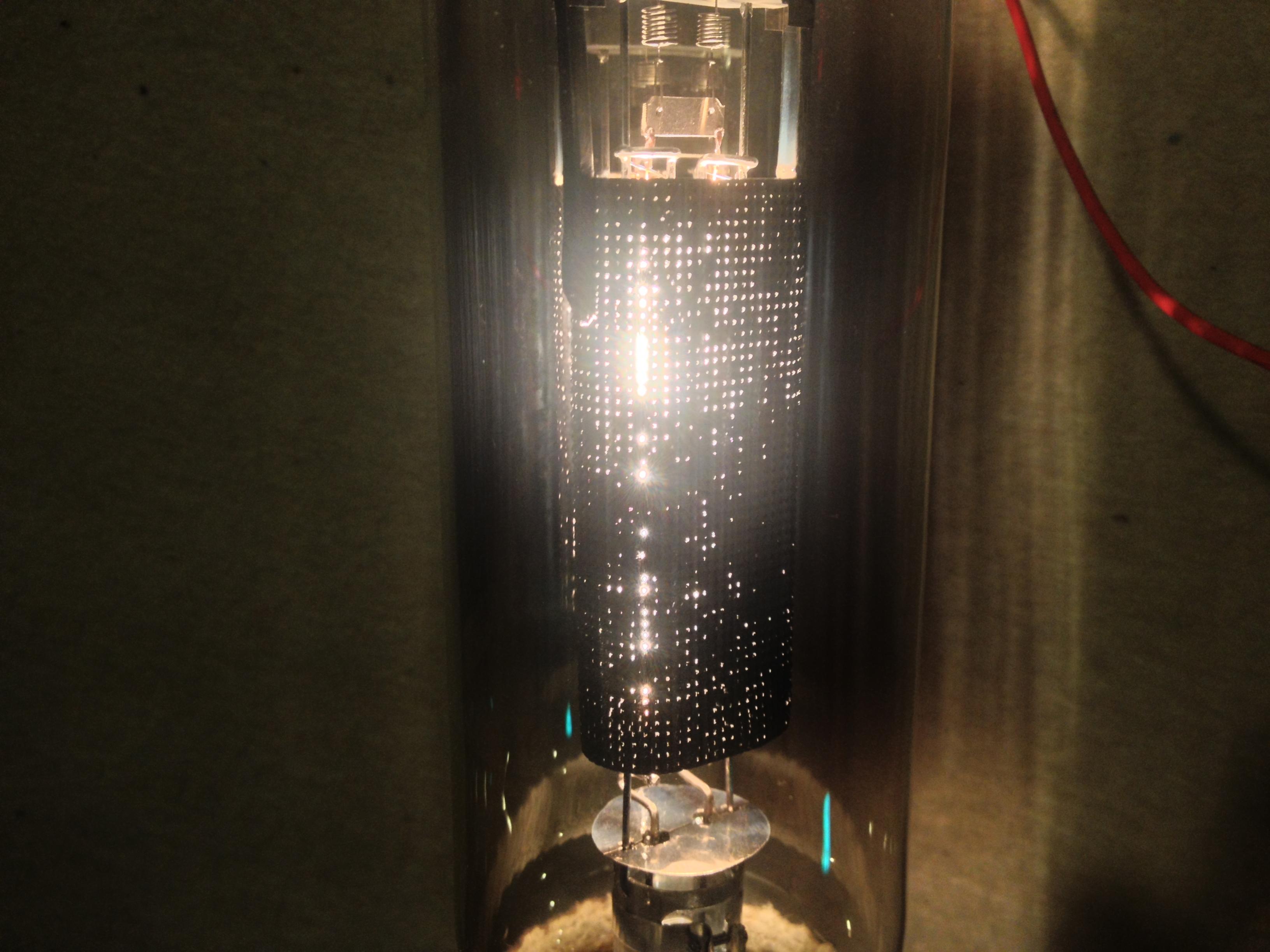

Did you see plenty power tubes such design? At least over 100W plate.
Oh, this tube is really good, both technically and visually. And you Roman (Kruzhka) seems to be a happy owner of such tubes, since you sell themThere is very interesting powerful European pentode with metal plate - 5C/450A, but rare 🙁

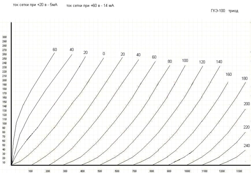

Among old metal anode tetrodes, that were manufactured in Tashkent in years 1950s, I would mention GKE-100 tube. It is still more affordable than metal anode GM-70. Its maximum plate dissipation is 80W, plus 16W dissipated by the second grid if triode connected, so we come to near 100W dissipation power. Triode curves have been measured by one colleage from Ukraine.
I also heated them up, and was surprised by their stable behaviour. After 70 years of storage, anode current came to stable point after few seconds of operation.
GKE-100 looks great as output tube candidate. This tube is not popular and still available for peanuts. I had few of these also.
