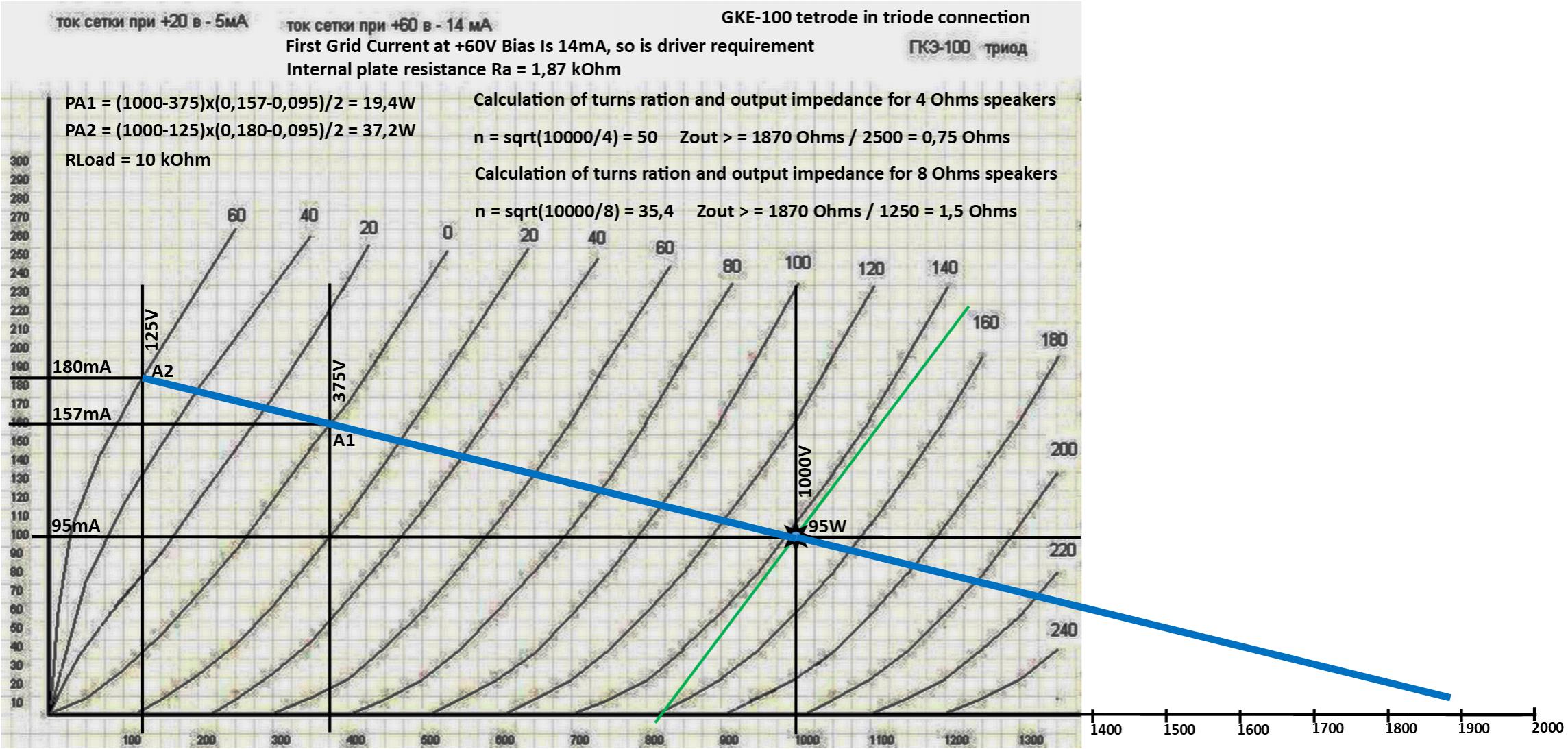

GKE-100 looks great as output tube candidate. This tube is not popular and still available for peanuts. I had few of these also.

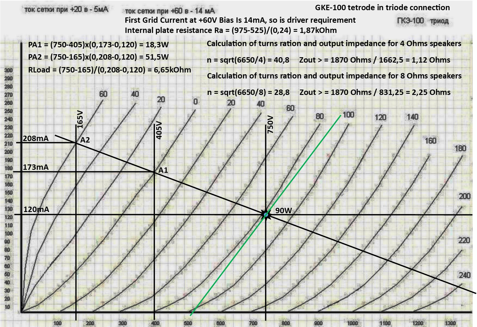

In triode connection, this tetrode tube is quite similar to GM-70 (internal plate resistance, output transformer and output power). Howerver, nobody still used it, maybe because of absence of measurements in triode connection. I think the enclosed picture with calculations is shown here for the first time.

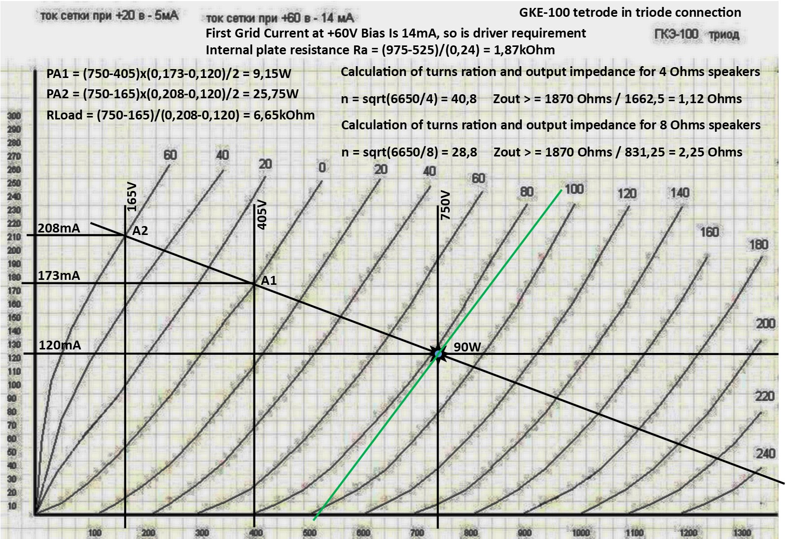

Oh, the output powers above are wrong, in the picture attached to #61, I have not divided by two. Correct data are here. So, at 750V anode voltage one does not have output power compared to GM70. One needs to consider higher anode voltages.
Oh, at 1000V 95mA work point, and 10k load applied to anode, calculations for GKE-100 in triode connection are much better. One obtaines real 20W output power in A1 mode with 0,75 Ohms output impedance. However, requirements to driver stage are: 280V p-p in A1 mode, and 400V p-p in A2 mode.

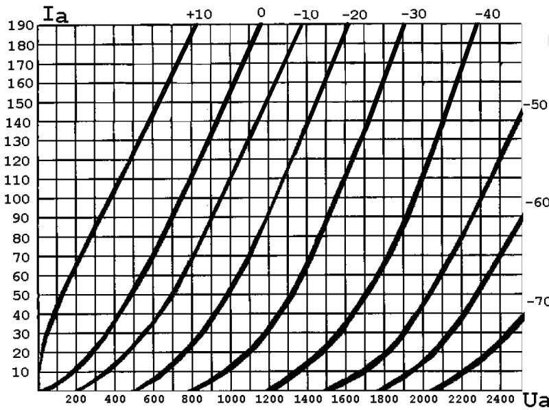

Also, the GU-46 tube is good for the output units of powerful single-ended amplifiers.
The maximum power dissipated at the anode is 500 W, in a triode connection the voltage gain is about 5, the internal plate resistance is 500-700 Ohm, depending on the operating point.
I enclose the results of preliminary (incomplete) measurements of the GU-46 in the triode connection (because of limited power of my test anode transformer). With SE output stage, one can easily get an output power of 70-100 W in A1. Big output transformers will be more simple in design, than for GU-48.

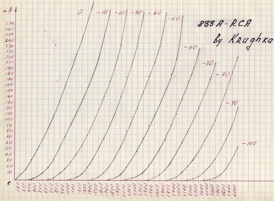

Here are some measurements and comments about 833A and GU-48 tubes
http://audio-db.info/AudioDB/BazaPraktiki/Usilenie/Lampy/Alfavit/GU/GU48
