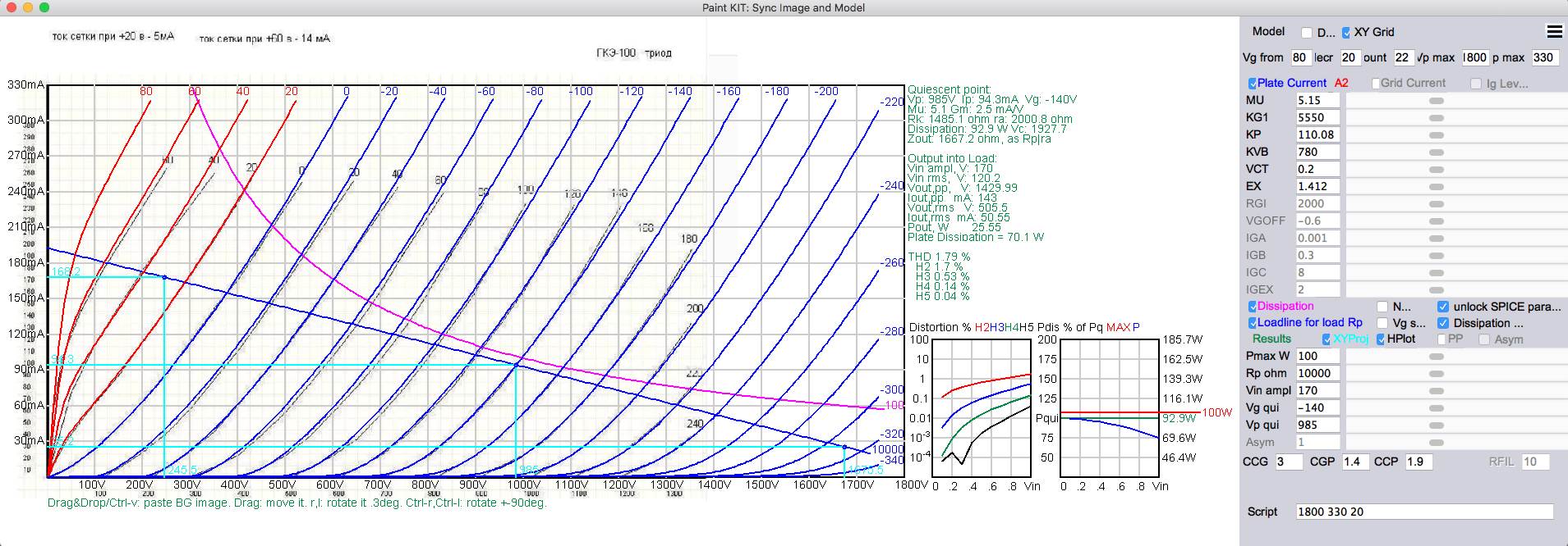

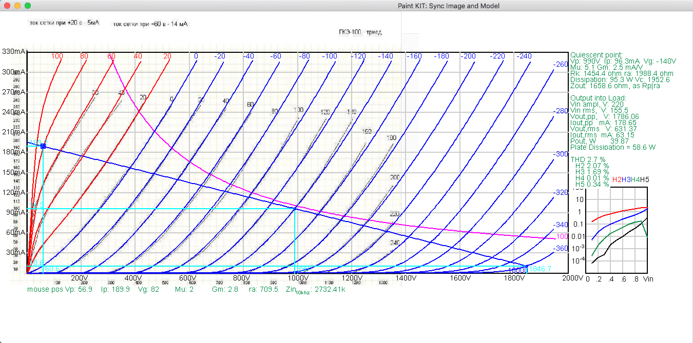

My 40W output power expectations at a2 mode are based on practical observations of matched input and output sone waves. Input wave from tube sine wave generator with 120V RMS showed no visual difference from the output sine wave with 5 Ohms resistive load attached
Look at the static load line for 40W output.
(In dynamic load at LF and HF it will be worst...)
because the working ellipse will "crush" deeply into X axes and hardly will be deformed.
The diference in Ri in extreme points are huge, causing dramatic deferent behaviour of OT in +half period and -half period signal at anode.
That will additionaly correspond with current flow G1 in + half periode input signal.
Because +20V=5mA, +60V=14mA, so Iti will be significant at +80V of Ug when input signal raching max for max power...
Off-course input signal for the theoretical 40W is 420Vp-p.
I will simulate for minimal primary inductance and max capacitance at the 20Hz and 20KHz
with dynamic load lines to see what is happening.

60Vrms=170Vp-p cca.
It is probably measured with 1KHz signal, when the amplified signal at anode to output transformer is very narow ellipse, "almost" straight line. Because of that distortion is about the close to one with static calculations?
But with some low frequency reactive load become dominant, (as the capacitive load for HF) and ellipse will change shape to "fat" one. 🙂

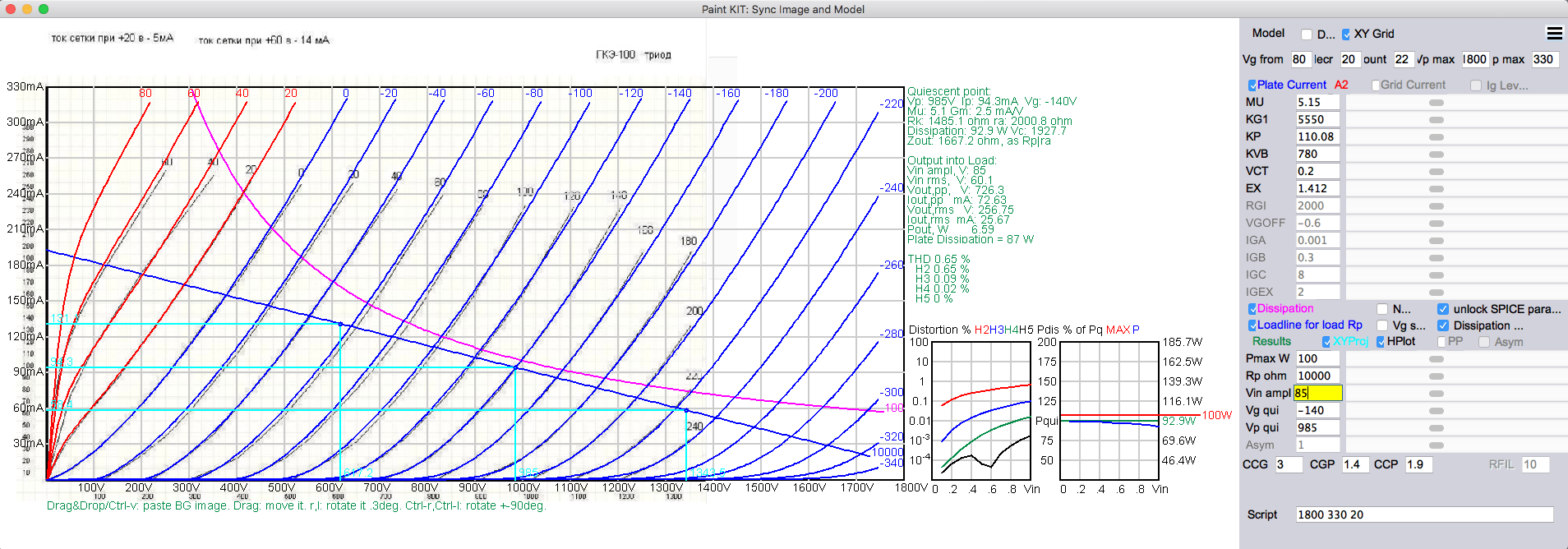

So for given datas for 170Vp-p input and 10K Load, power is 6.6W at the anode.
But for double amplitude of input signal of 340Vp-p the power could be at 1KHz 25.5W
I put Vp-p because it is true value. Amplitude that You get on the scope...
And for 340Vp-p input "+" half_period of signal going to max at +30V of Ug. That will be more current at G1 than for Ug1=+20V / 5mA. 8-10mA cca.
