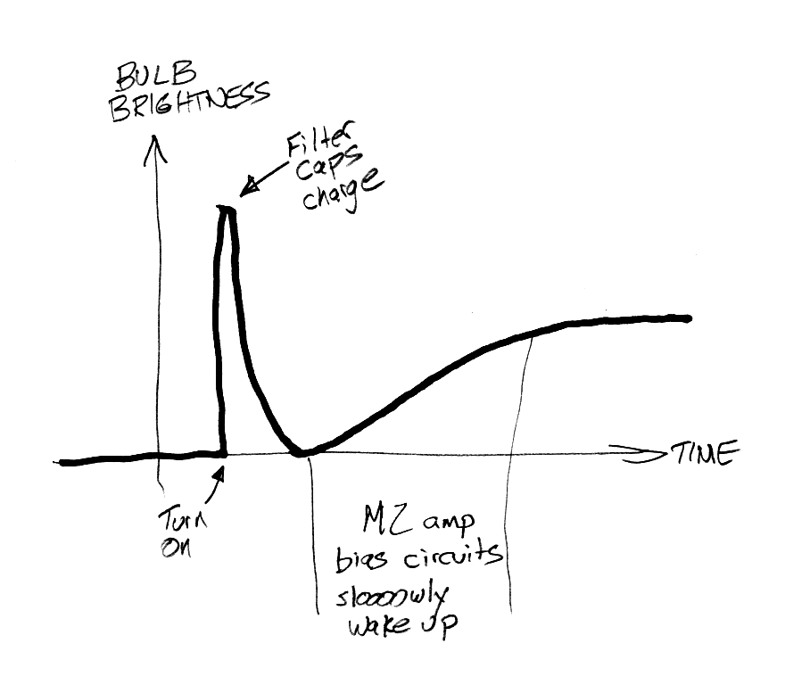

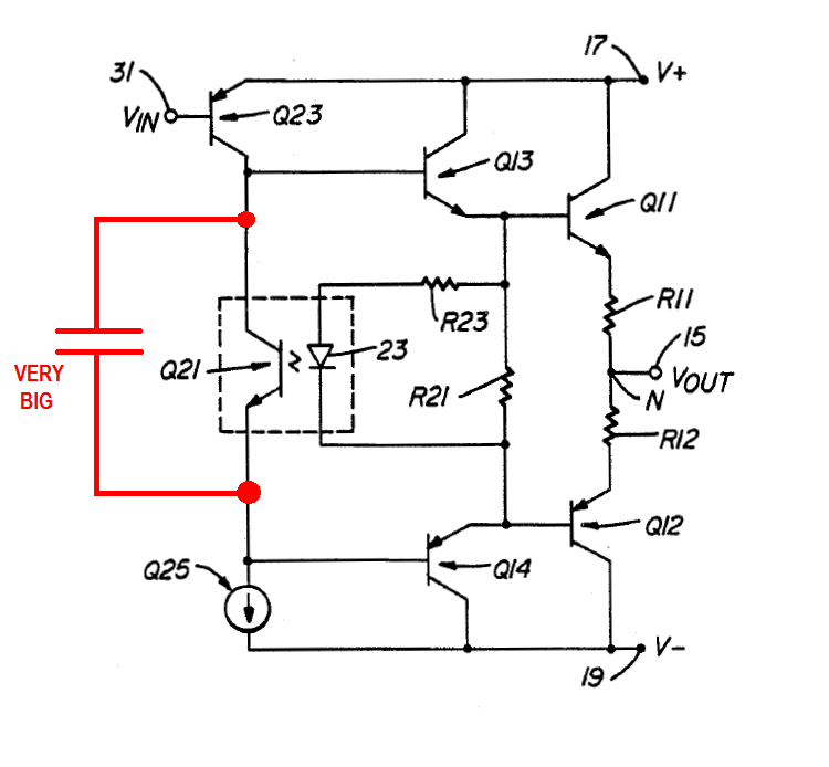

Tony, here's how the solid-state amp called "First Watt M2" behaves, when connected to a Dim Bulb Tester. This amp is class-A so its idle power is quite high, but the optoisolater-based bias control circuit has a very very long timeconstant (> 20 seconds).
At switch-on, there is a large inrush current as the power supply filtering capacitors are charged, and the transformer flux transitions from (zero) to (sinusoidal). Then the bias controller sloooooowly ramps up the current in the output stages and eventually, more than 20 seconds later, the final class-A idle power is reached.
