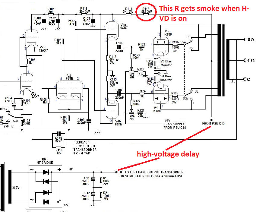

Would voltage delay increase the B+ more than 450V? Or it acts as on/off switch. I was looking at your circuit before but out of stock so I went on to buy different brand from ebay since I was lazy to build one from your document.
Right now, every time I turned it on, the delay works as it's support to but the first resistor in the circuit got smoke. I am planning to remove voltage delay to see if it causes the problem or something else.
--->--VD---B+---R1----R2: my R1 get smoke every time VD activates. It used to work before.

I don't understand where your R1 and R2 are. Is that part of your decoupling or what?

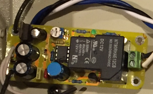

Which delay are you using now? The delay shouldn't do anything to the voltage, just connect its input to its output after some time. Are you sure you connected it right?
Can you post a schematic, even if a pic from your phone?

Thank you, that's I thought, I have 1 for each channel, used to work for a while. Happen only 1 channel. The other channel still works fine.
This is the one I have
Then the first R (R115) comes out smoke when the H-VD starts. Even replaced new R still the same. I turned off right away so I am not sure where to start trouble-shooting yet.

That has nothing to do with the delay, you have a short to ground between R114 and R115.Thank you, that's I thought, I have 1 for each channel, used to work for a while. Happen only 1 channel. The other channel still works fine.

I have checked many times between R114 and R115. Any points after R114 seem normal. I will check again later.
If the Output is bad, would it give the problem too since it connects to the Output?
The current comes for the output and to R114.Without a deviation all current from R115 goes throug R114 and that one would burn too.I have checked many times between R114 and R115. Any points after R114 seem normal. I will check again later.

When R115 starts spark and smoke, I turn it off so R114 is fine. Even I raised the PCB up a little to make sure nothing touching the case. I compared with the working channel and couldn't find anything different. Did a lot of measurement to compare. At least H-VD is not the problem, I will take time again to check all the points with GND again.
Spark at the legs of R115 and R114

A very simple quick check is to bridge the delay with a wire. If it still smokes, it isn't the delay. I agree with Ketje's diagnosis. If R114, R115 are slightly different (large tolerance), could be a shorted elcap: disconnect C103 and see if your trouble is over.
Although it could also be a shorted tube in that case.

Already swapped all the tubes from working channel but still the same.
Sorry, didn't mean to hijack your thread but it's very helpful in my case. I will start with C103 to see what happen.
R114 and R115 value pretty much the same.

What happens if you disconnect R114? Maybe C103 is shorted and R114 has failed short the first time.

I think I will start with C103 since I removed both R114 and R115 to do a measurement, the R114 has exactly value while the R115 value just a little slower than the R114 but not that much.

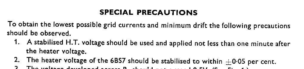

The Brimar 6BS7 is an audio tube which was built to a standard that allowed it to be used for Electrometer purposes.
The Brimar 6BS7 Data Sheet warns of mandatory pre-heating in electrometer applications (where low grid-current is supremely important).
Expressly, that the 6BS7 heater should be powered for 1 minute or more, before the HV arrives.
