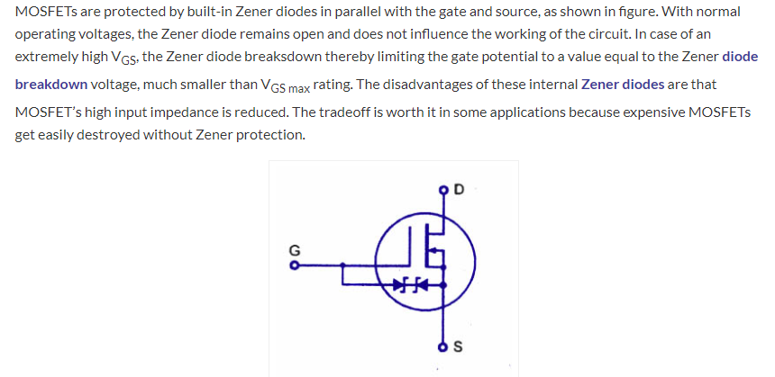

Jan, what limits Vgs on Q3 ? I can see that model fet includes ESD protection but it still has a 30V max rating. <trunc>
Yes, any internal zener should be considered for ESD protection only, unless stated otherwise.

ESD strikes are extremely brief - they originate from a capacitor. In a IEC 61000-4-2 ESD, it's all over in about 60ns. Energy ratings and power ratings are not the same thing!
In fact, most of the current in an ESD strike test will flow through the the gate-to-source capacitance of the FET. The internal zener is there limit voltage, but not at any particular power level.
With DC voltage, none of the current is diverted through the capacitor.
The reason TOSHIBA say "do not use it " is that it does not guarantee (across all production samples) that the DC voltage that will be clamped to the safe value, and there is no guarantee that the zener will not be damaged if slower transient events are present.

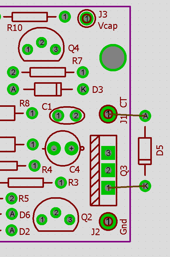

A zener could be added to the bottom of the board as shown here. A 12V 400mW is OK. Note that this view is from the top of the board, and the zener should be mounted on the bottom. Take care not to short the zener wires to other connections.
Edit: added to The HV Delay | Linear Audio NL
